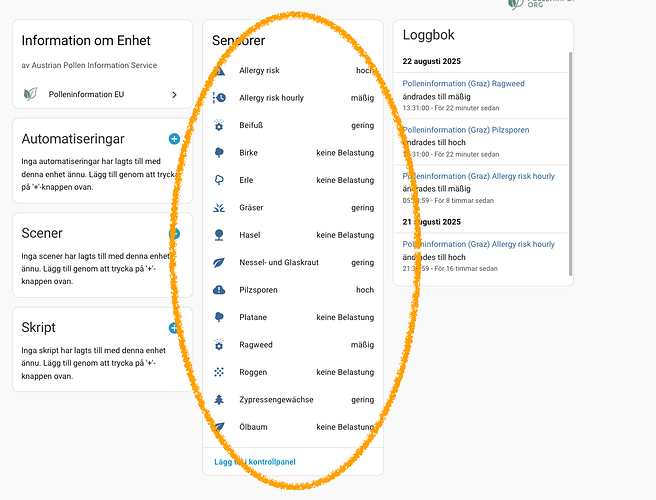

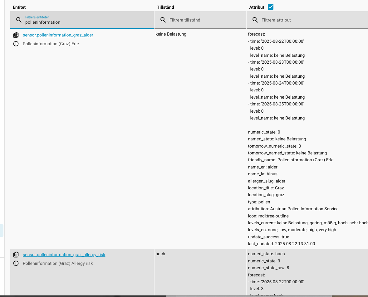

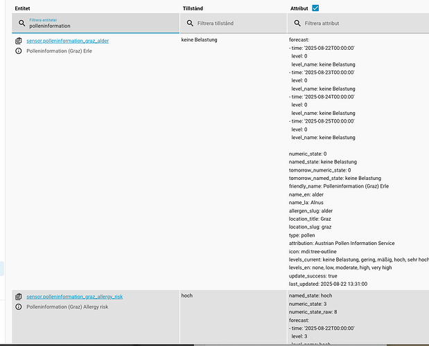

Have you successfully added a location? Are there entities provided by the polleninformation integration?
If that is the case, could you provide a screenshot or some such of said entities; it would look something like the below:
Let’s start there!

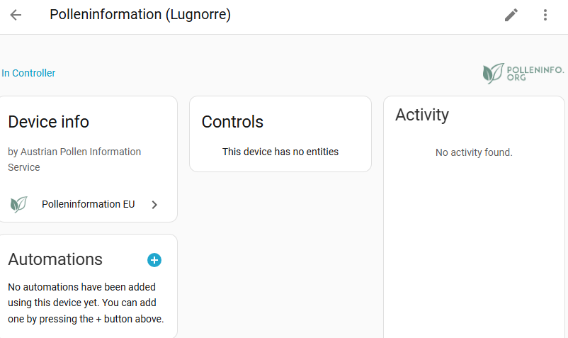

Thanks for the reply.
Yes I have defined the location
But I have no entities created
So the reason why the card shows loading forecast, but is unable to present results, is that the integration has not created entities. There is nothing to show.
The question is why entities aren’t created for you. I trust you have restarted HA after installation of the integration?
I tried adding the integration, using parts of your location (if that is your home location, you might want to remove the screenshot?), and I get the expected entities.
(Screenshot redacted)

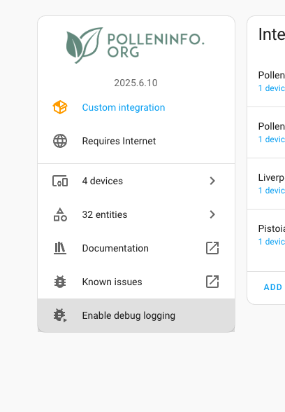

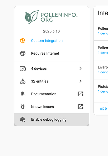

Could you enable debug logging in HA for this integration, example-code for configuration.yaml:
logger:
  default: warning
  logs:
    custom_components.polleninformation: debug
Adapt default to your current default, and add the last line to your possibly already existing logs: -list, or copy-paste the above into your configuration.yaml.
If you could provide the relevant log-lines you find for the polleninformation -integration? So we can see what is happening. Please obfuscate your API-key and possibly your location (truncate to two decimals or some such, and/or replacing them with a random number). You can also DM me the log-lines, if you don’t want to obfuscate. It might already be obvious from what you see in the logs as-is (having enabled debugging); it might be even more clear if you remove the location that you have, and add it again.
If you prefer UI rather than console, another way of getting debug info (should work), is
(I’m using a lot of “should” because I don’t normally do it like this, but just tested and seems to work.)
