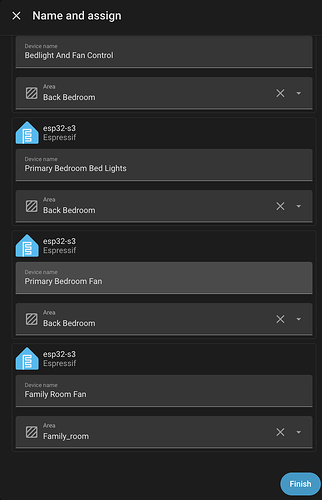

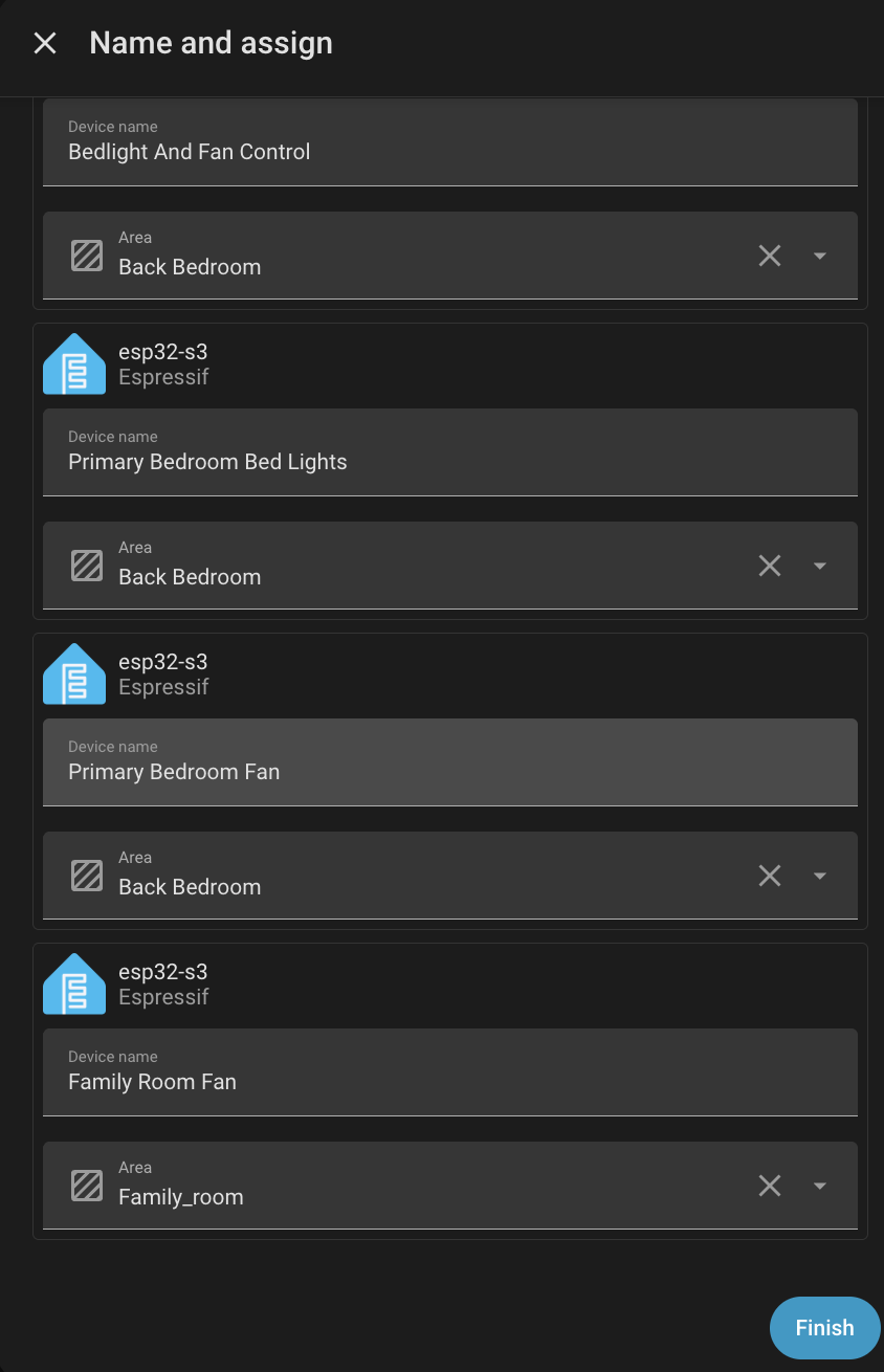

I just deleted the entire device. The device was discovered and I added it back in. Every device (including the parent device) showed an “area” when adding, as you can see:
But areas are not included on some devices:

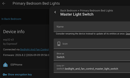

Then there’s a third sub-device, which is prefixing the parent device name:
switch.bedlight_and_fan_control_master_light_switch

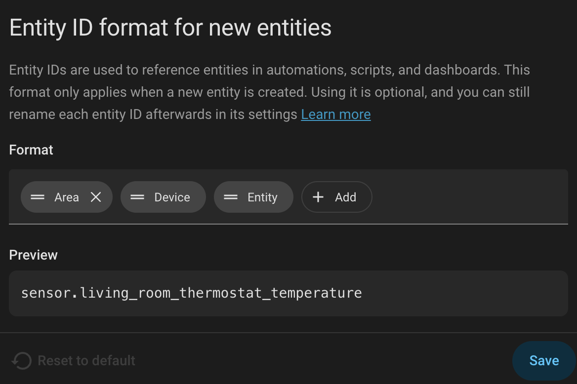

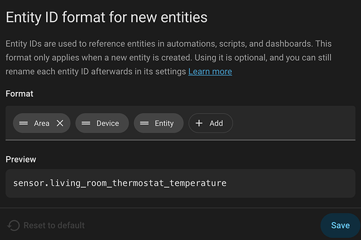

This is my entity format setting, and I haven’t touched them:
