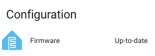

The firmware entities of the new devices are disabled by default. Simply enable them and the devices show up for update!
Would you like to explain briefly where and how?
It’s under the Integrations → ESP Home → Device
Under configuration, you will see the firmware is disabled by default now. By enabling them it should show up.
