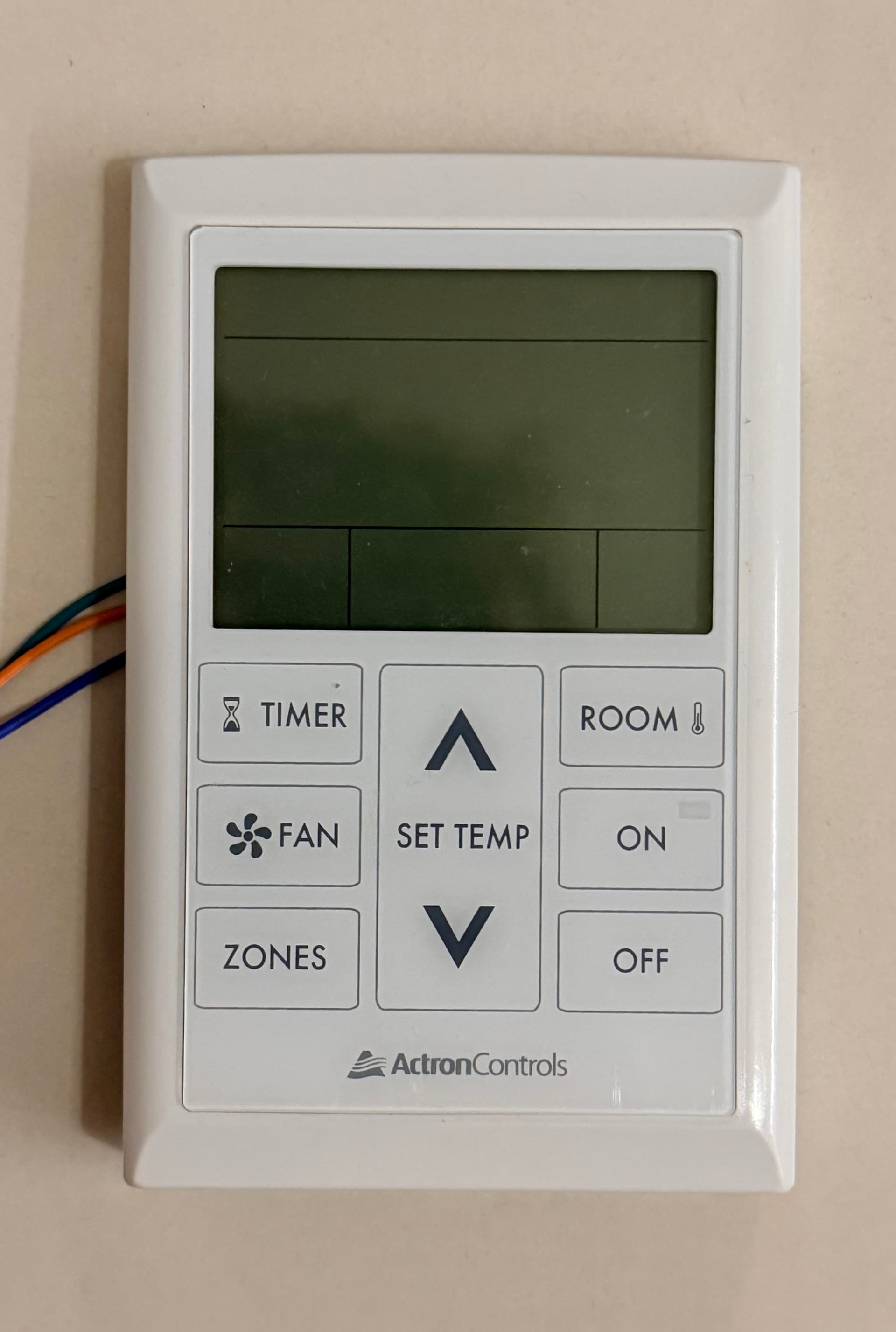

I’ve made a new external climate component to replace my Actron Controls B812(RT) air conditioner wall controller! It’s a WSHP (water-source heat pump) unit with an LE85R3 relay board.
The B812 communicates over a 2-wire bus using a custom pulse-distance protocol that
hadn’t been documented publicly before, so this repo includes the full reverse-engineered
protocol docs alongside the component.
