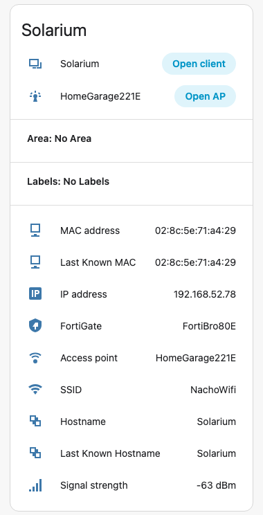

Current features
  • FortiGate, managed FortiAP and connected Wi‑Fi client devices and entities
  • AP radio, channel, utilization, signal, noise, bandwidth, CPU and memory data

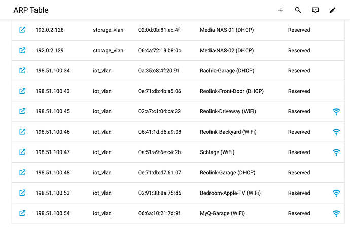

  • ARP-table devices with optional Wi‑Fi client matching and conflict diagnostics

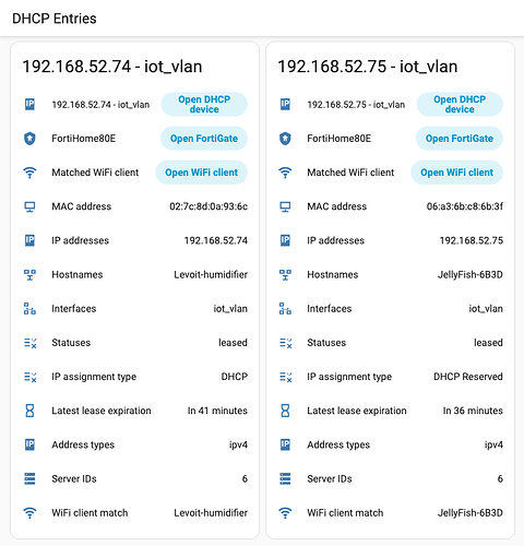

  • DHCP lease devices, hostnames, reservation status and Wi‑Fi client matching
  • Support for multiple FortiGate firewalls
  • Privacy masking for MAC addresses, hostnames, SSIDs, serial numbers, VLAN IDs and AP names
  • Optional Home Assistant area and label organization

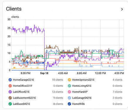

  • Five automatically generated dashboard strategies:
    • Wi‑Fi Clients
    • Wi‑Fi Graphs
    • ARP Entries
    • ARP Table
    • DHCP Entries
  • Built-in dashboard filters for firewall, AP, SSID, area, label, interface and lease type

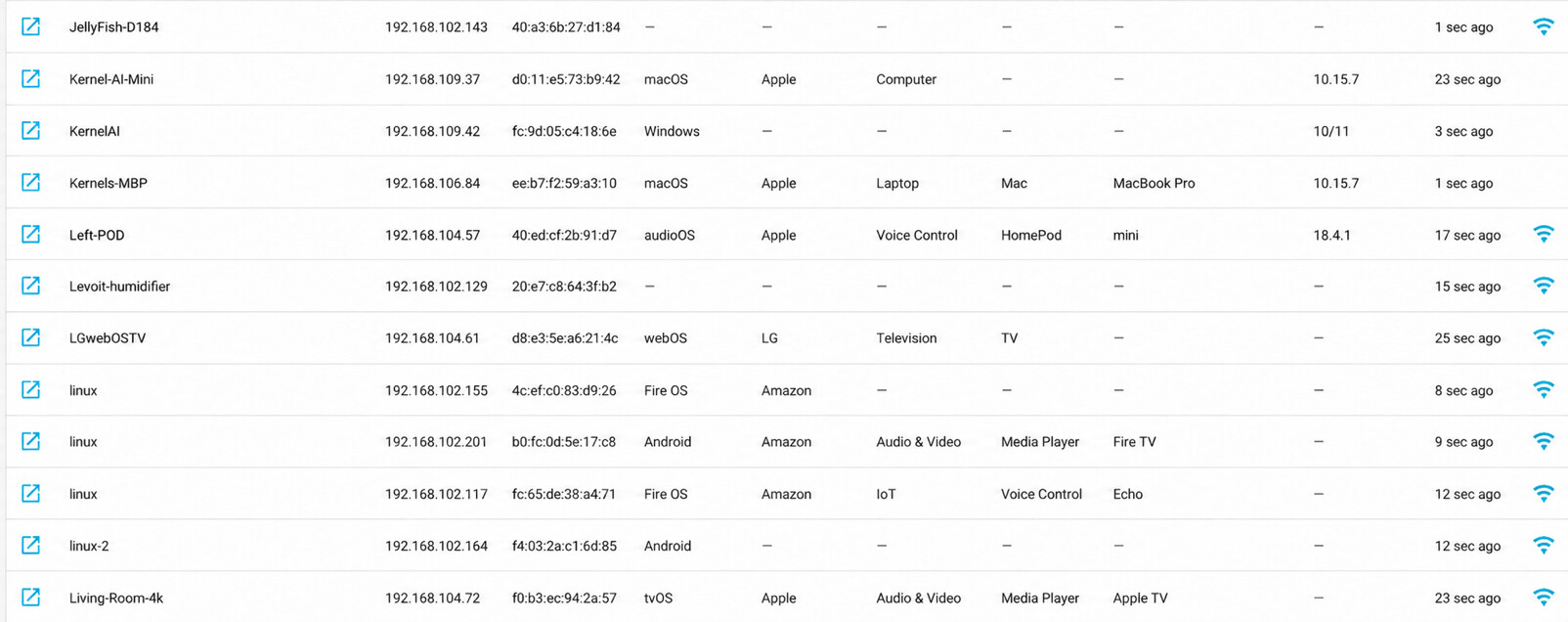

KD Device Table
The new KD Device Table provides a compact inventory view with filters for:
  • FortiGate
  • Hardware vendor
  • Hardware type and family
  • Operating system and software version
  • Interface
  • Devices last seen before or after selectable time thresholds
Exact MAC matches link related Wi-Fi clients without merging the separate
device records.
KD Device Table

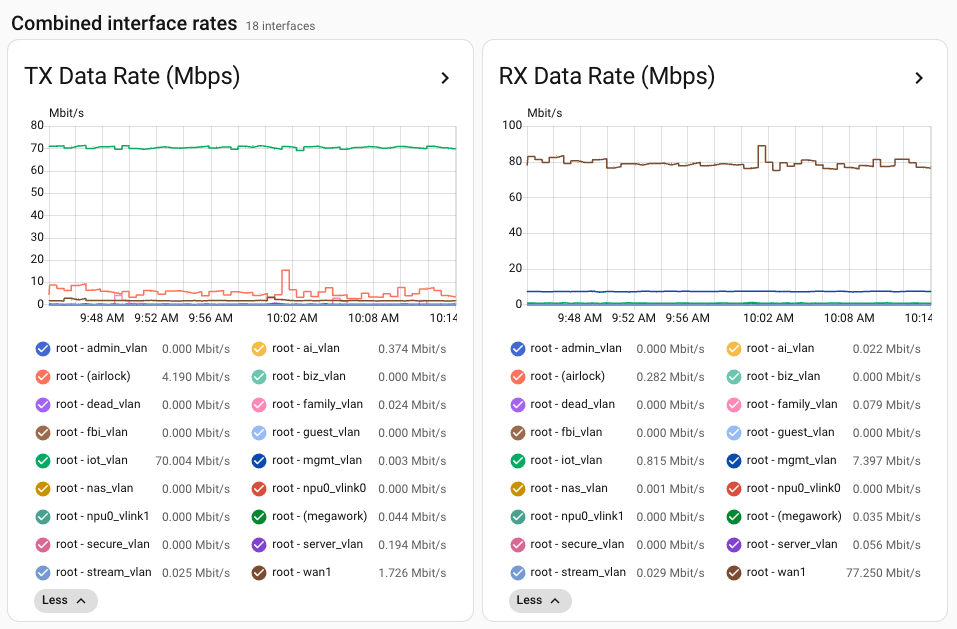

KD Interface Graphs
The new KD Interface Graphs dashboard includes:
  • Mbps graphs first, followed by MB/s, packet-rate, and error-rate graphs
  • Combined and separated-by-firewall layouts
  • FortiGate, link-state, speed/duplex, and parent-interface filters
  • Independent controls for hiding hardware-switch members and Wi-Fi SSID
    interfaces
  • Time ranges from 30 minutes through one week
  • Preferred interface names in graph legends
  • Wider graph cards for improved readability
KD Interface Graphs

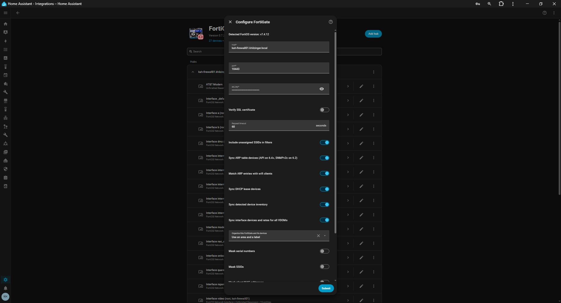

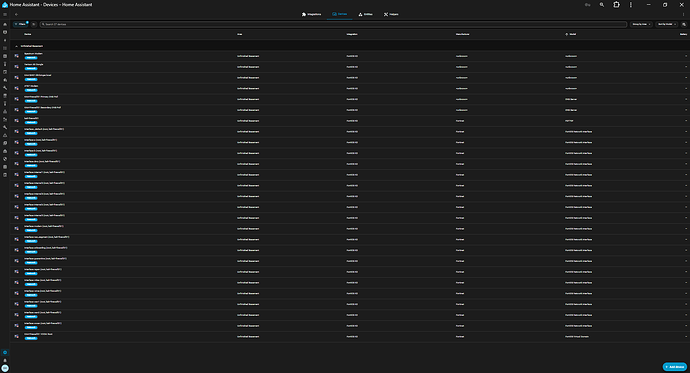

This is looking great!

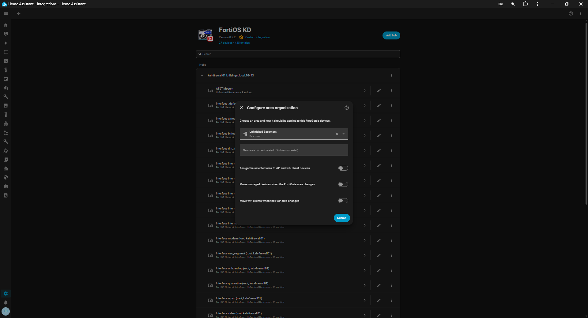

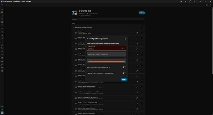

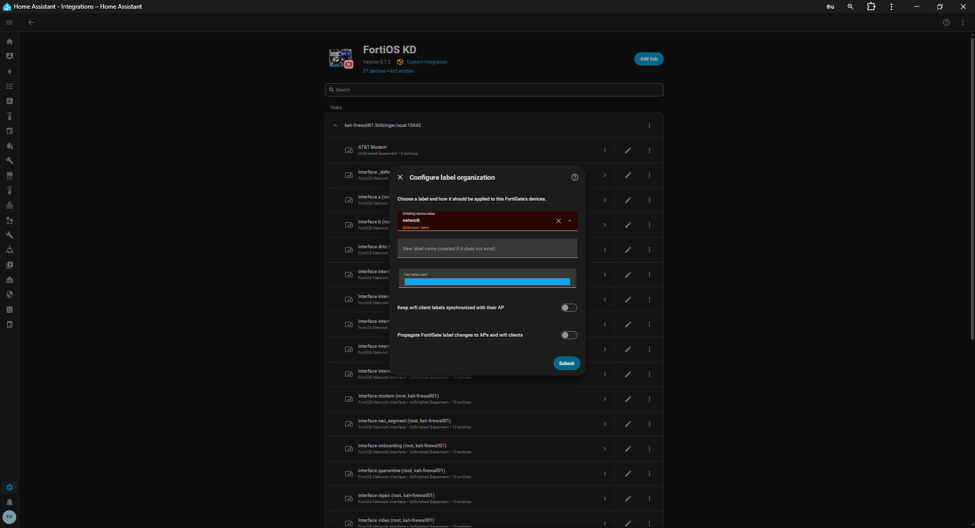

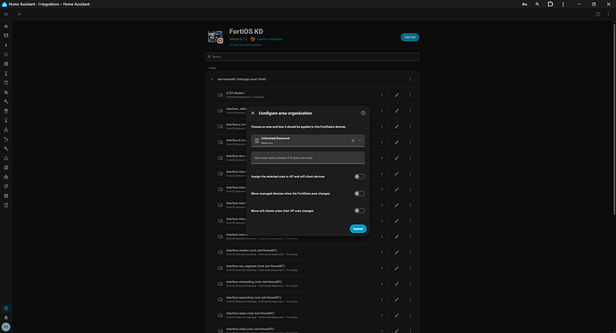

One issue:
I understand the need to have several devices and I have assigned areas to them.
But I have quite a number of entities that are not included in those assigned areas:
But I think I have the configuration right where those entities should not be orphaned.
Those entities (from what I could tell) are the filters the integration is creating for the dashboard strategies. They are technically entities but they are not entities related to your firewall devices, but rather objects that the dashboards use to filter the different items.
Have you tried adding the custom dashboards? There are about 8 of them. You’ll see the filters in action in those dashboards.
