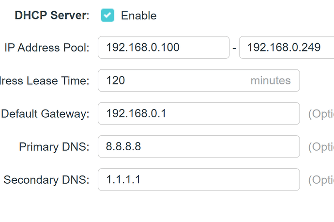

Plugged new HA Green into my router as per instructions. App not detecting HA. Checked router settings via PC Win11. Device shows at http://192.168.0.236 but doesnt connect via :8123 HomeA Observer at :4357/ shows Supervisor: Connected Support: Supported Health: Healthy. No other buttons or info. As internet is provided by Starlink Gen 2 ensured that it is in pass through mode. Changed |Primary DNS|8.8.8.8|

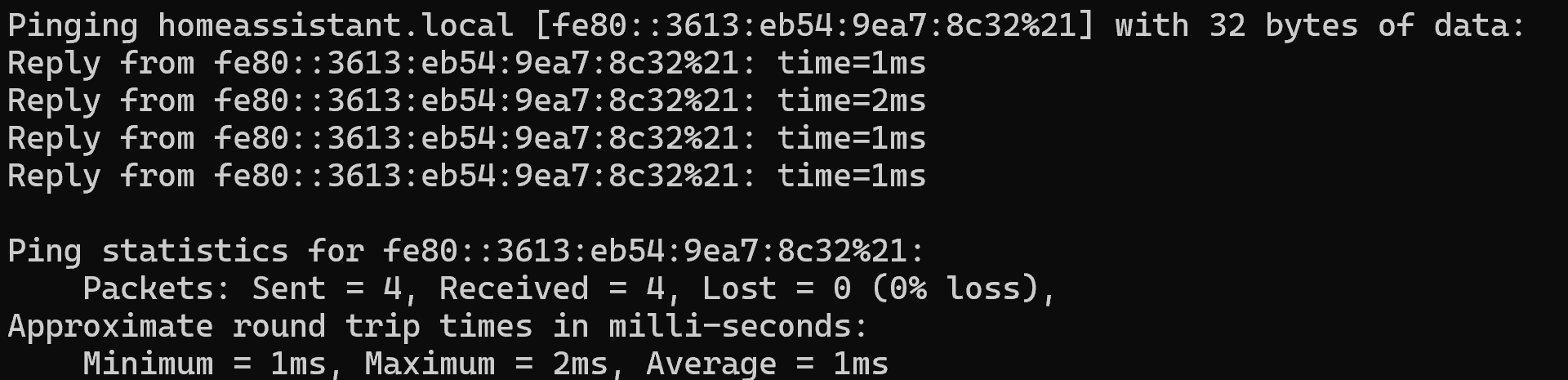

| — | — | |Secondary DNS|1.1.1.1| in case starlink was the issue, Ping results attached.

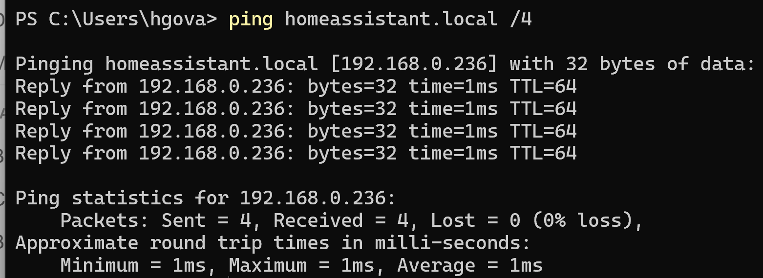

What do you see with ping homeassistant.local /4
Now, try http://192.168.0.236:8123

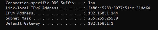

I just had another thought- make sure the computer trying to connect to the Home Assistant server (Green), from the PC command line, type ipconfig. The first three octets of the IPv4 and gateway should be the same as the Home Assistant server> In my case, 192.168.1
