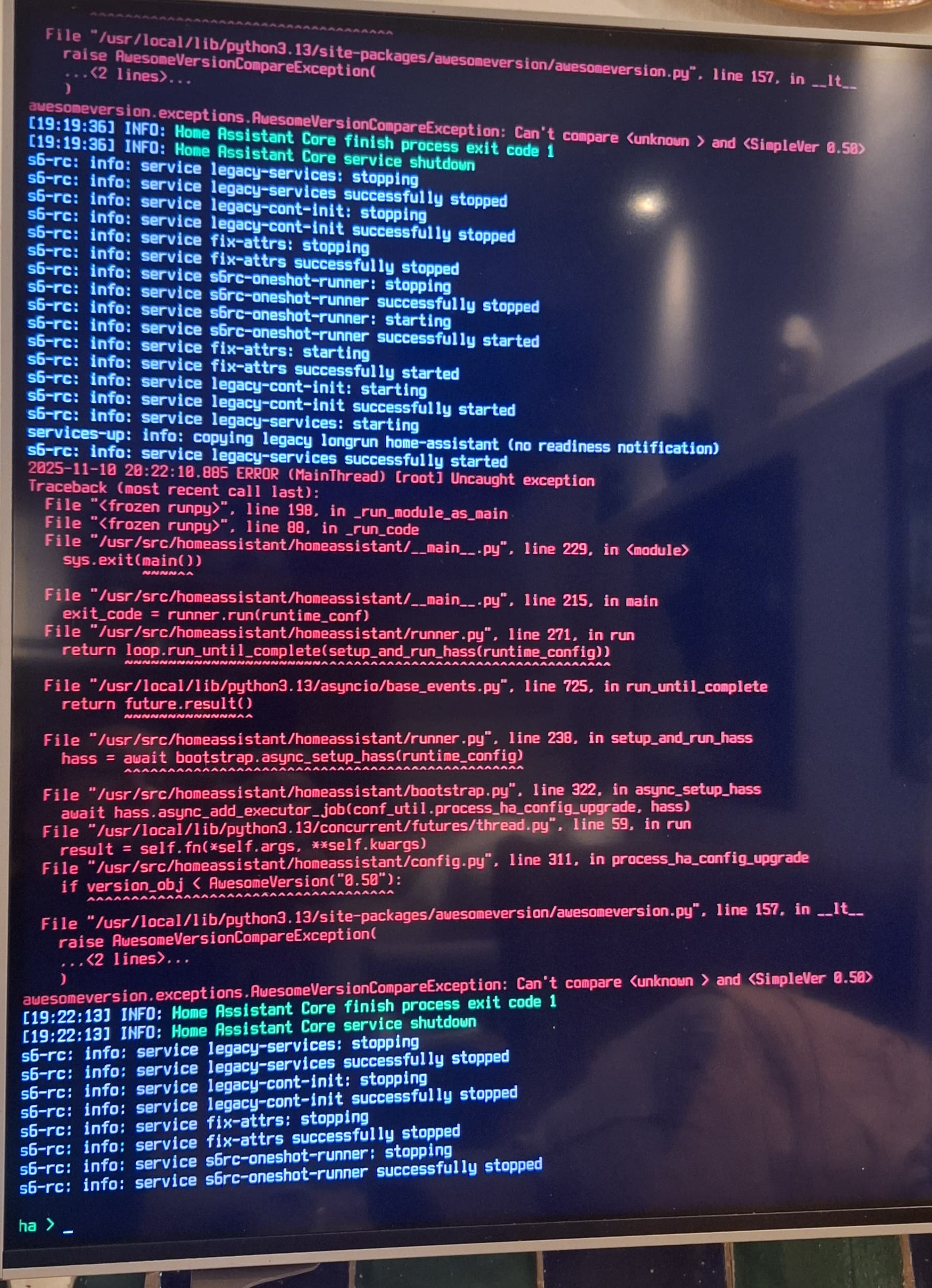

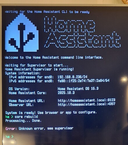

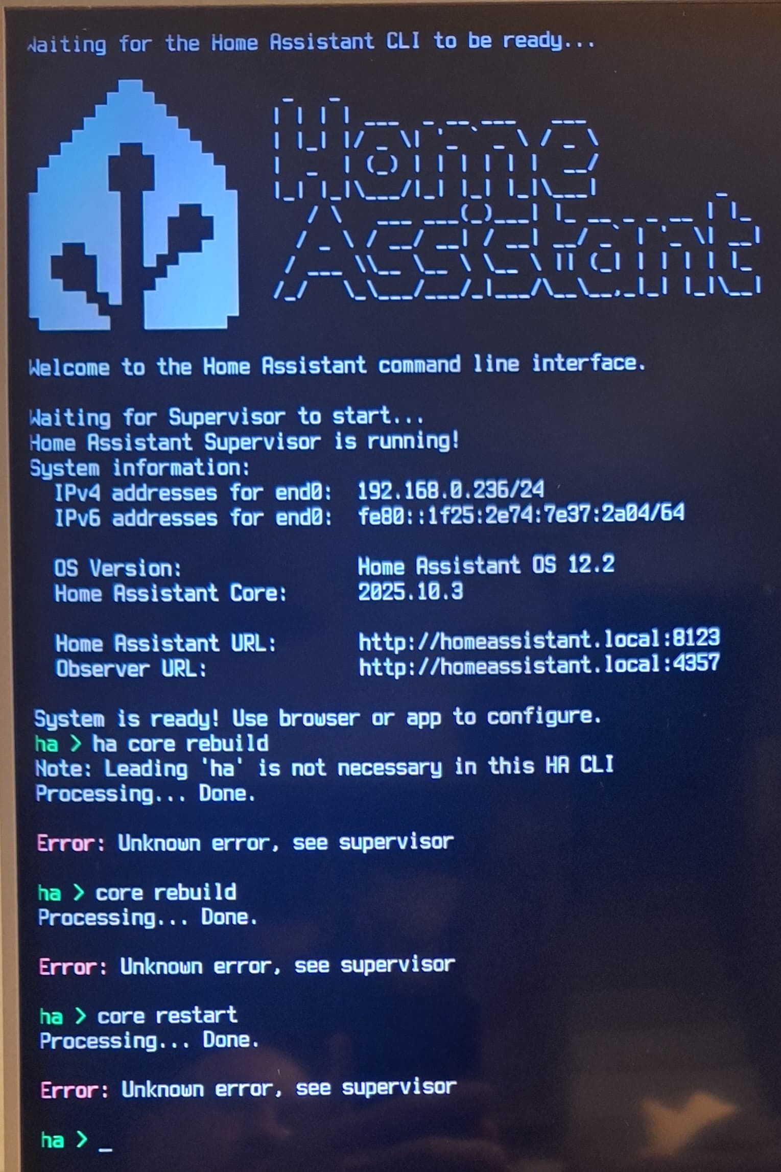

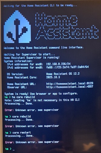

Thank you very much and very clear. So I did this and seem to have made things worse! I got a response of “unknown error” from HA CLI and on host reboot I cannot even get into the CLI. I attach the CLI responses. My current screen after rebooting and going through a series of initialization messages [ 5.nnnn] is “Waiting for the HA CLI assistant to be ready…” then "[WARN] Home Assistant CLI not starting! Jump into emergency console…
Is this a screenshot of your current status? It doesn’t say anything about the emergency console.

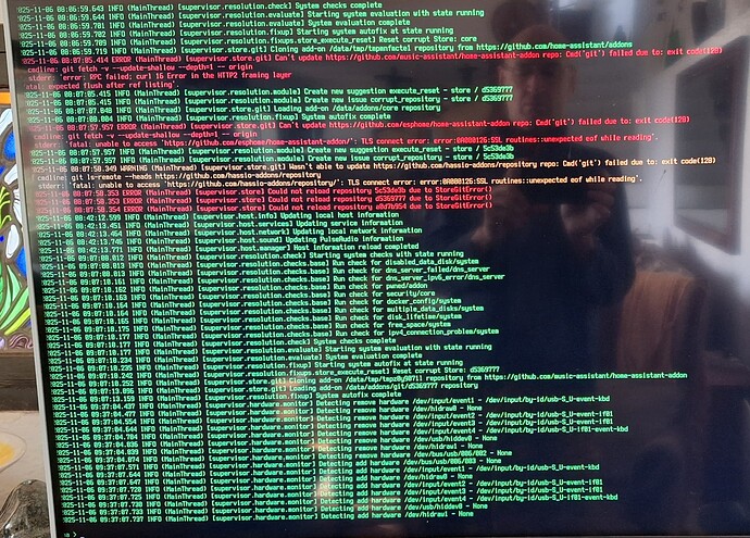

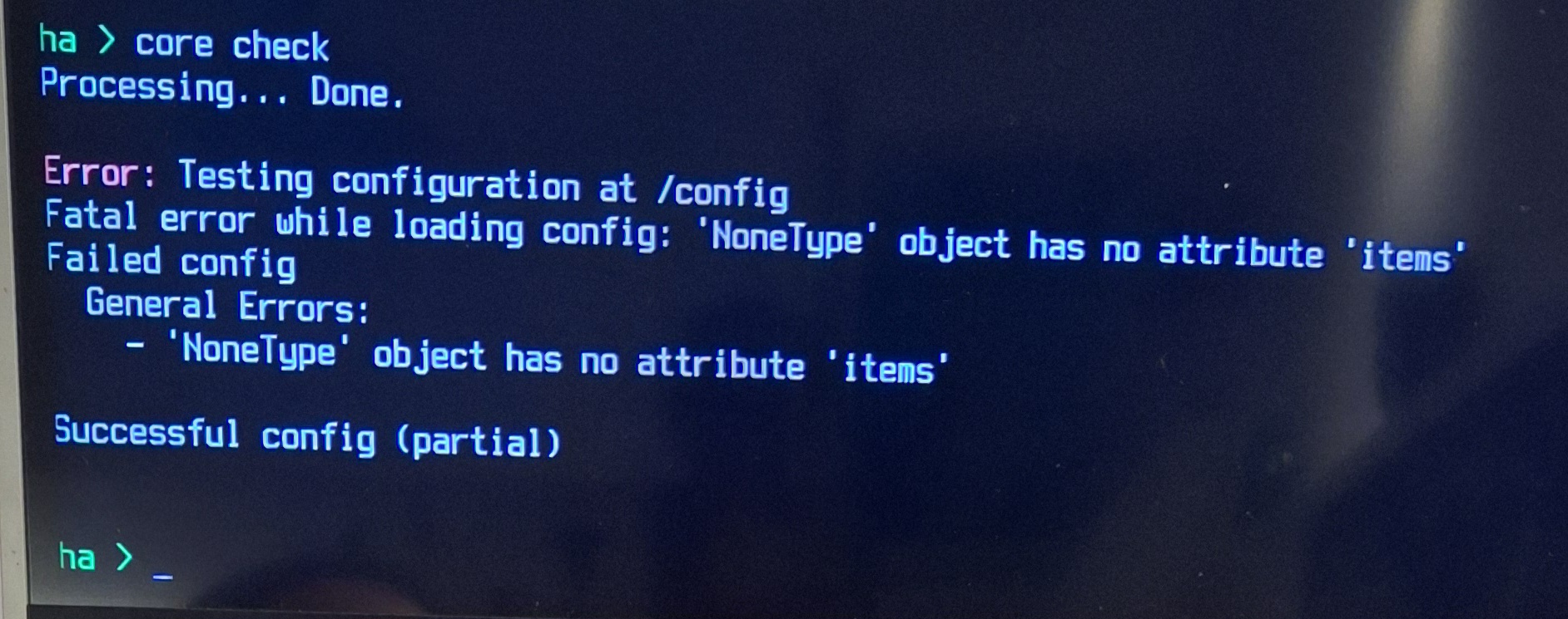

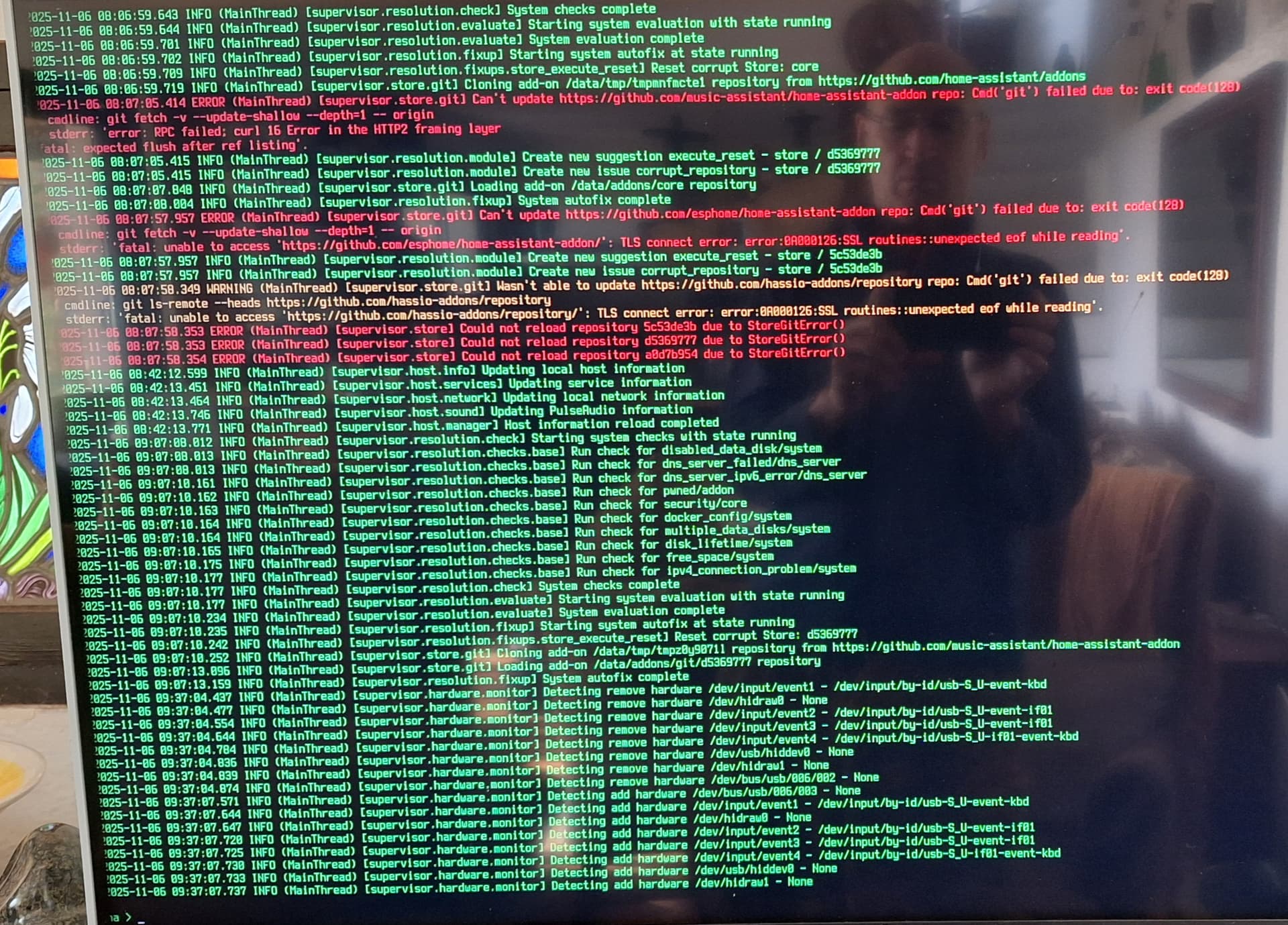

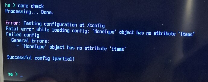

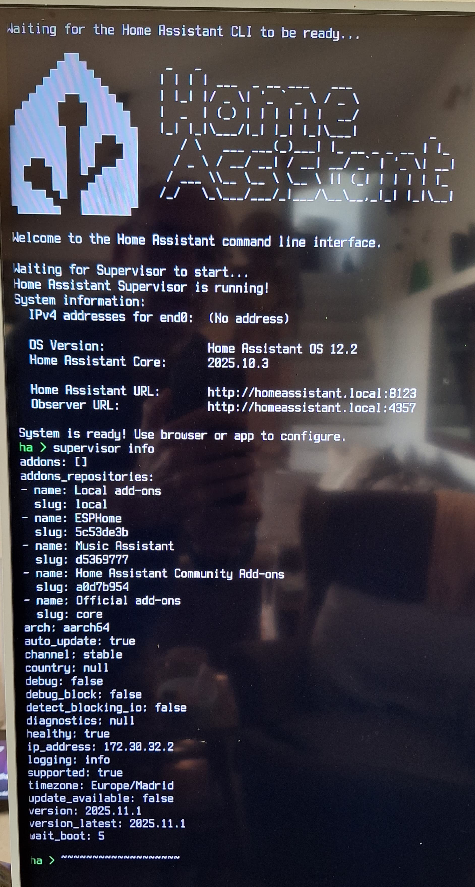

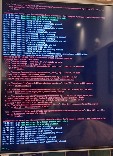

Thanks, I have now graduated to be able to post more than one image at a time (yay). So after a few reboots I am back in CLI so have run the info and log commands. Not sure what I am looking for but attached.
It doesn’t have an IP address, how are you connecting? If you look at the top end0 it does not have an IP address assigned. I’d strongly recommend you connect via a known cable at least to get it working.
Your list of installed docker containers in the supervisor info list doesn’t match with “Plugged in new HA green and it’s not working”. I see Music Assistant, HACS, ESPHome. You seem to have left out a lot of details and history.

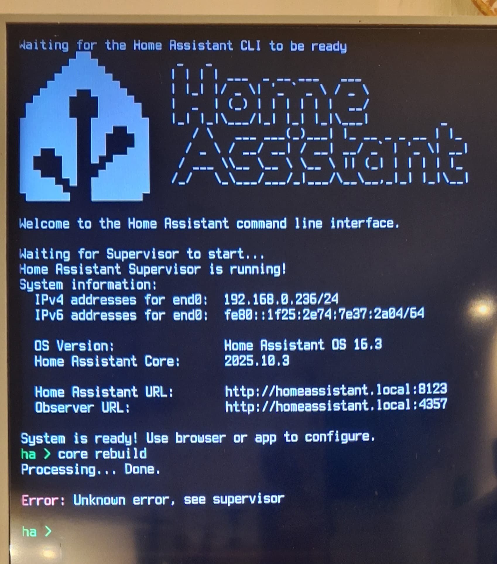

Hi there. I have changed the LAN cable and rebooted. Situation is about the same except that HA CLI showed the correct IPV4 address this time. So I am stuck again. Could it be possible that in fact what I have is a defective or refurbished unit? Or are there suggestions of other things I can try to do?
I’d recommend visiting the link I provided earlier and click the “Submit a ticket” button in the top right. You have support for that device.
Have you tried
ha core rebuild
ha core restart
Yes, I get “unknown error, see supervisor”

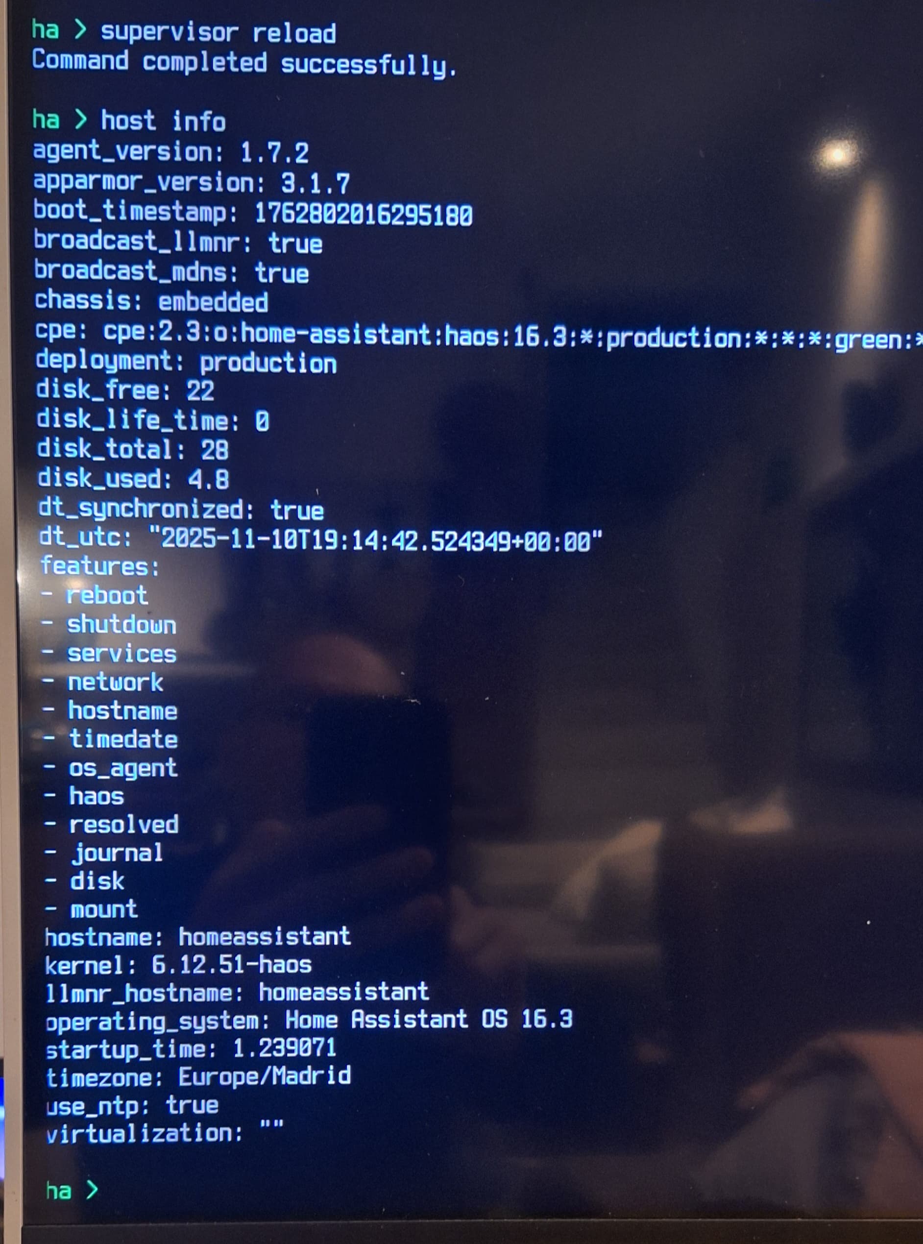

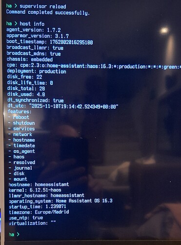

Also
ha host info
And look at the RAM and memory.
Where did you buy it?
Thanks very much. Not sure if the attached shows ram or memory, host info. I bought it online at one of the suppliers listed on the Home Assistant page.
