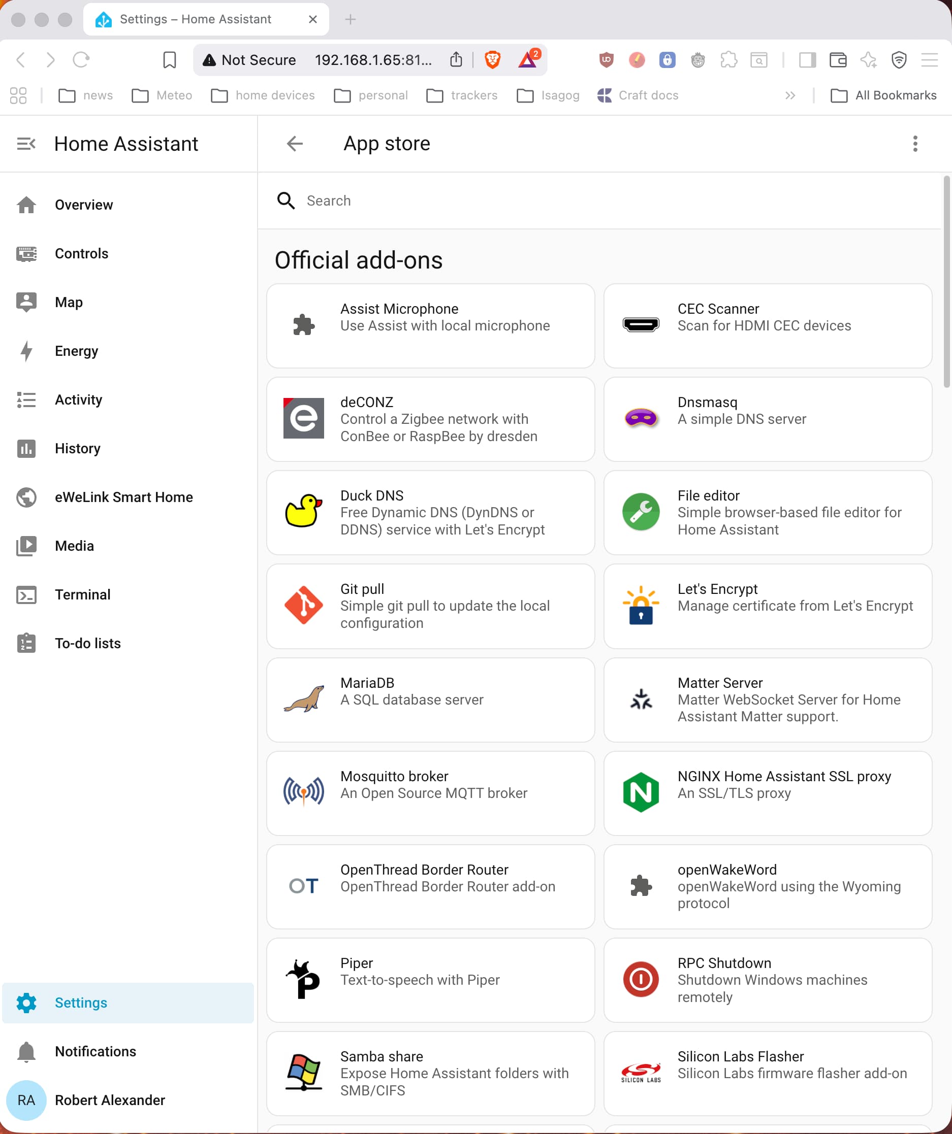

I have bought a Sonoff iPlug S60TPF to experiment and on my iPhone I have the eWeLink app that ‘sees’ it.
On HA I managed to add a Repository for that eWeLink app (not sure I I got to the add repo dialog, cannot find it again) and now in Settings → Apps I see eWeLink Smart Home and when I launch its ‘Open WebUI’ I see a 10027339c9 discovered device but if I click on it get ‘Devices not supported’, also cannot find any screen usable to enter that long lived token

This is the current interface with what I understand has substituted ‘Integrations’. A search there does not return any results with ‘Sonoff’.

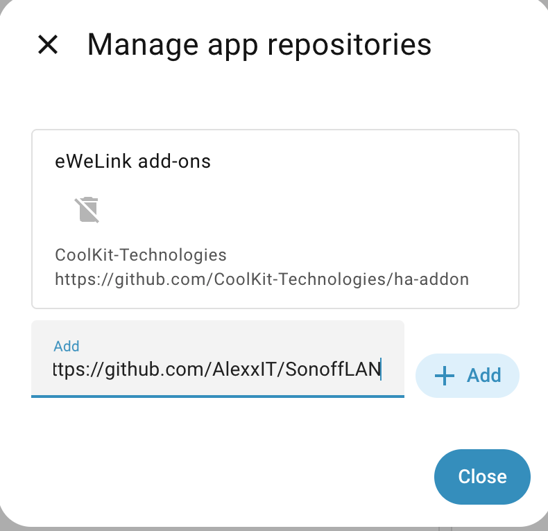

So you can click on the three vertical dots up right and get ‘Repositories’ and ‘Registries’ as possible choices and I tried the following with GitHub - AlexxIT/SonoffLAN: Control Sonoff Devices with eWeLink (original) firmware over LAN and/or Cloud from Home Assistant
but get 'not a valid add-on repository. I note that this github repo does NOT have a ‘repository.json’ file its root.
Ideas on how to install this integration with the new interface?
Again thank you.
Ah, the good old integrations vs add-ons confusion. :slight_smile:
Have a look here: Integrations, add-ons and custom integrations.
The SonoffLAN repo contains an integration. Integrations are the bit of software that connects your HA to physical devices (like your Sonoff) and services (like a weather API). Integrations are a kind of custom component (custom components are either custom integrations or custom cards for the UI). Add-ons are (almost always) standalone software that can work alongside HA.
In order to install SonoffLAN, you first need to install HACS (HACS is kind of a special one, since it requires an add-on if you run HAOS, as well as an integration). I would regardless recommend that you install HACS, for the world it opens for HA options (there are many quality 3rd party integrations).
So, roughly, your steps should be:
  1. Install the HACS add-on.
  2. Install the HACS integration (you’ll need a GitHub account). Make sure to restart.
  3. Install SonoffLAN from the HACS page from within your HA. Make sure to restart.
SonoffLAN is a listed HACS integration. In some other cases you’ll need to add a custom repository first from within HACS.

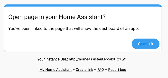

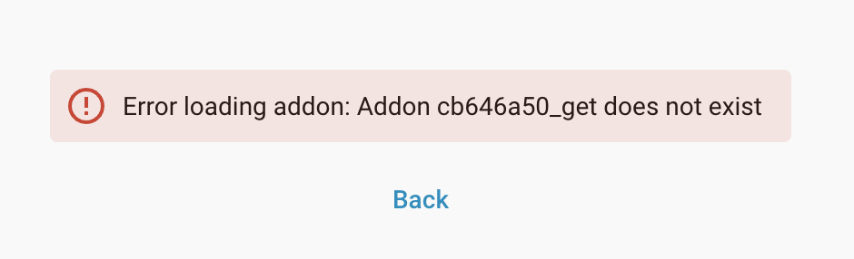

When I try to install HACS I get the
screen as expected and the local HA URL is correct (I can enter it in my browser and it will open http://homeassistant.local:8123/home/overview correctly), but if I then click the blue ‘Open Link’ button I get the following error:
Any ideas as to what am I missing to isntall HACS?
Thanks a lot again.
Robert
UPDATE: this thread helps me https://www.reddit.com/r/homeassistant/comments/1r9nzh1/having_trouble_installing_hacs/
