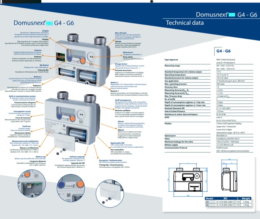

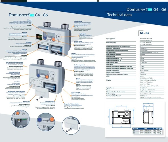

Hi. Does anyone have the correct .yaml file for the Apator Norax 3 meter?
The optical probe is compatible with this gas meter. Thank you.
The optical interface itself is compatible and can be used to communicate with the meter.
However, you will need dedicated software that supports communication with this specific device.
In short: using the optical interface together with the Aquaticus IEC62056-21 module will not work. The meter operates with the DLMS COSEM protocol, which is not supported by the Aquaticus IEC62056-21 ESPHome module.
If you use the optical interface with DLMS COSEM–compatible software, it may work.
Thanks for your reply.
Could you please tell me which software is compatible with DLMS COSEM?
I’m a novice.
