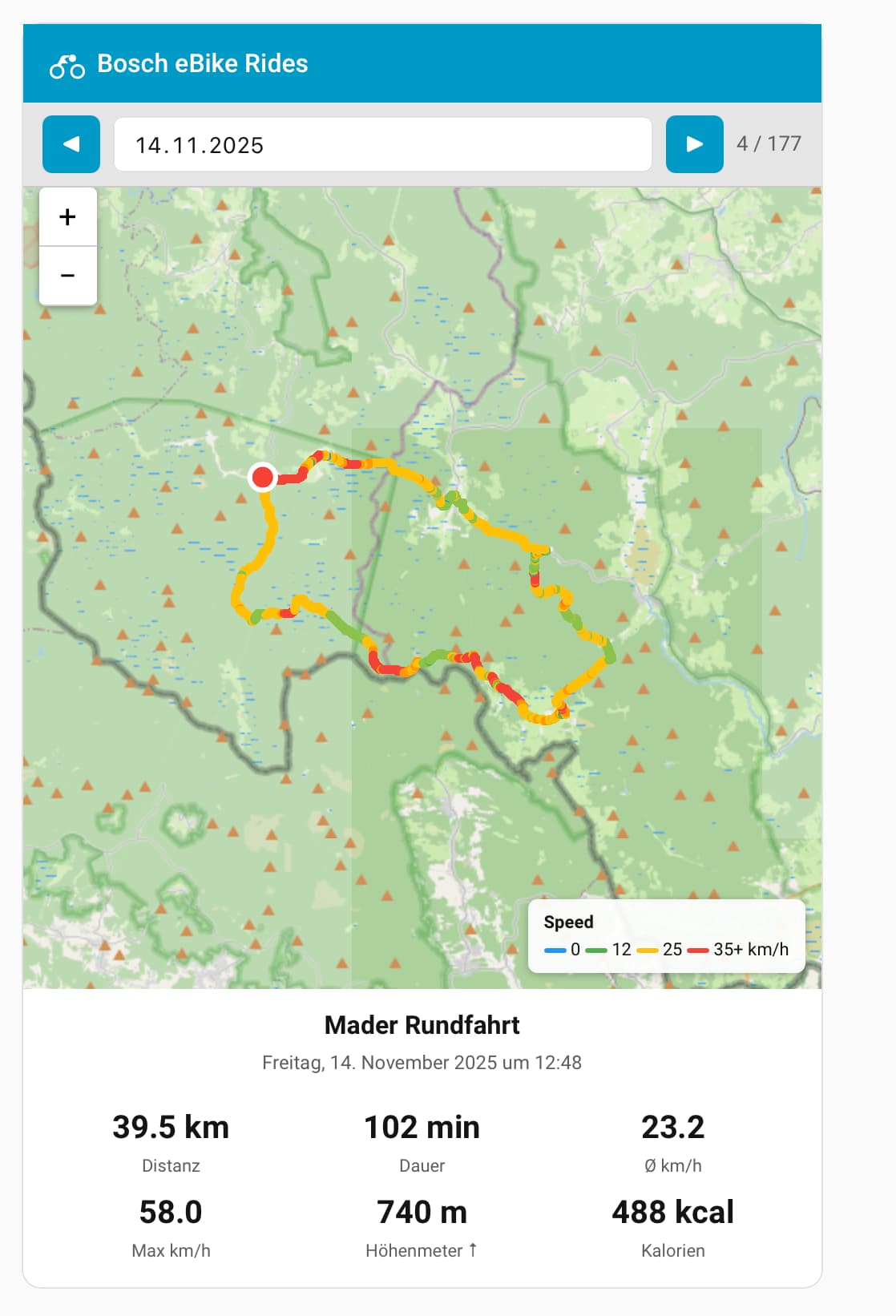

I’ve built a custom integration for Bosch eBike Smart System that connects to the official Bosch Data Act API. If your eBike runs on the Bosch Smart System (Performance Line CX, SX, etc.), you can now monitor everything directly in HA.
What you get:
Bike Sensors
  • Odometer, motor hours (total & with assist), max assist speed
  • Active assist modes, walk assist speed
  • Battery lifetime Wh, charge cycles (on-bike / off-bike)
  • Next service odometer
Last Ride Sensors
  • Distance, duration, average & max speed
  • Rider power in watts (avg/max) and cadence (avg/max)
  • Calories burned, elevation gain & loss
  • Ride title and date
Key features:
  • OAuth2 authentication via Bosch SingleKey ID
  • Automatic token refresh
  • Multi-bike support
  • 30-minute polling interval
  • HACS compatible
  • English and German translations

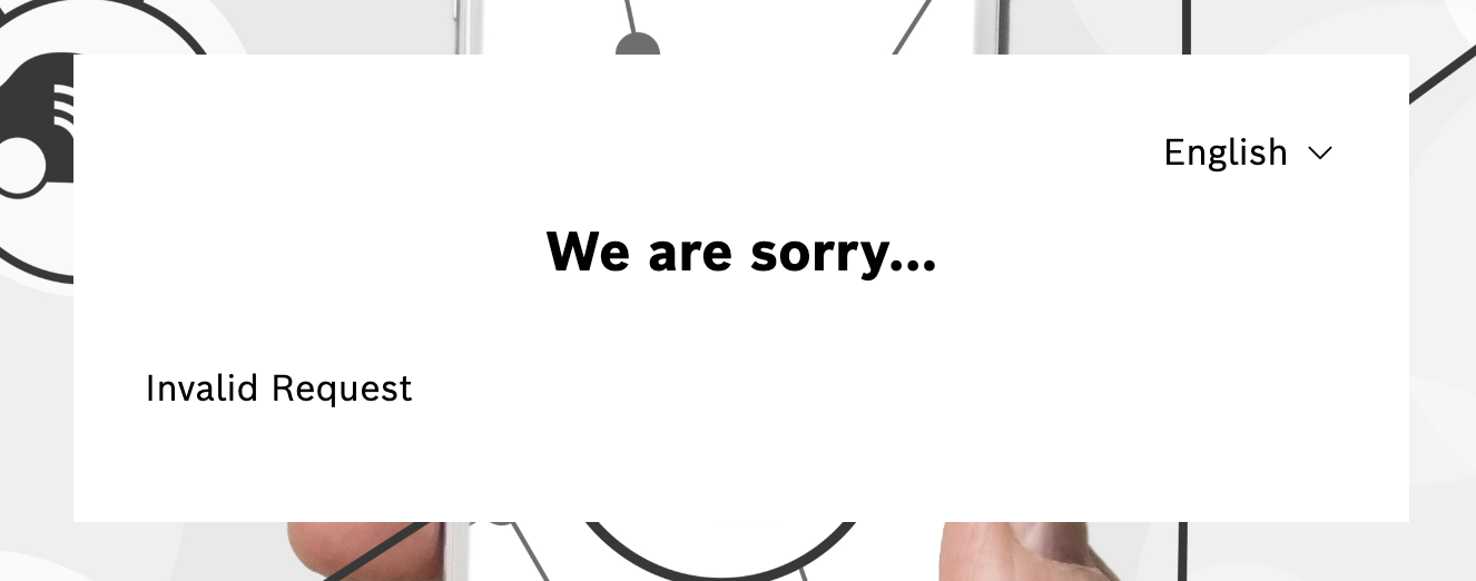

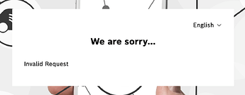

Thank you so much for this integration! I am stuck with waiting for Bosch to approve the app. It’s been more than two days and I haven’t received anything. If I try to enable the service from the Flow portal, I get a “Invalid request” error, which I assume means that the app really hasn’t been approved.

If I try to enable the app from Bosch’s portal, I get the “Invalid request” error.
So it really seems like I need to wait for Bosch to approve the app before I can continue, but it’s been more than a week now.

I am still waiting for the approval for 8 days now and still get the “Invalid request” error.
@sgotti took 8 days, so that might be the worst case scenario. Did you retry like they did, and do you have the latest update?

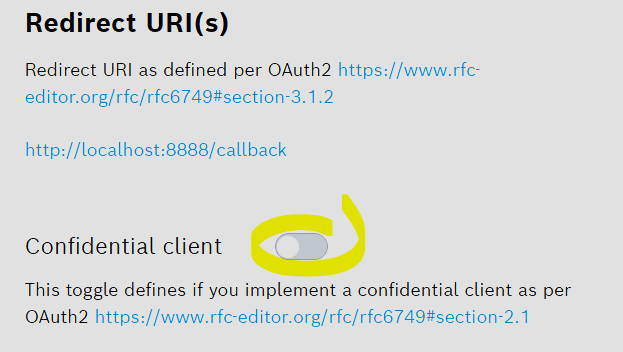

I deleted and re-setup the application without checking ‘Confidential client’ and was able to activate it right away.

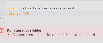

Can’t find the custom:bosch-ebike-map-card though.
Browser refreshed. Anyone else?
The correct path for the file “bosch-ebike-map-card.js” is “homeassistant/custom_components/bosch_ebike/www/”. Just copy the file into this folder and restart Home Assistant (full restart required).
Strangely enough, Bosch actually granted me access to the Data Act API within just a few minutes. I didn’t receive an email from Bosch either.
After manually adding /bosch_ebike/bosch-ebike-map-card.js to the dashboard ressources the card was found.
