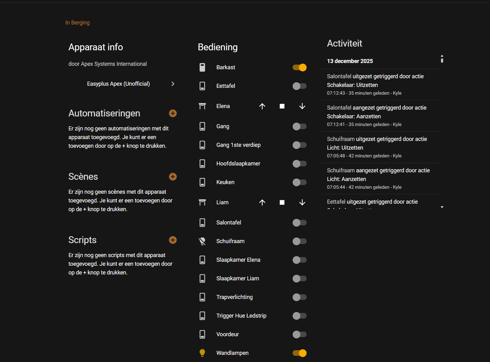

Unlike basic script-based solutions, this is a fully robust integration with a Hybrid Workflow. It communicates directly with your controller via TCP (Local Push), meaning updates are instant (0ms delay).
:sparkles: Key Features
  • :brain: Smart XML Import: You can simply paste your Apex config.xml content during setup. The integration will automatically:
    • Name all your devices correctly (e.g., “Kitchen”, “Living Room”).
    • Detect and configure your Shutters/Covers.
    • Filter out “Junk”: It automatically ignores unused relays (like those generic “relay 85” or “Re +4” entries), keeping your Home Assistant clean!
  • :electric_plug: Discovery by Use: Don’t have your XML file? No problem. Use the Auto-Discovery mode. The system starts empty, and devices are added to HA the moment you press the physical wall switch.

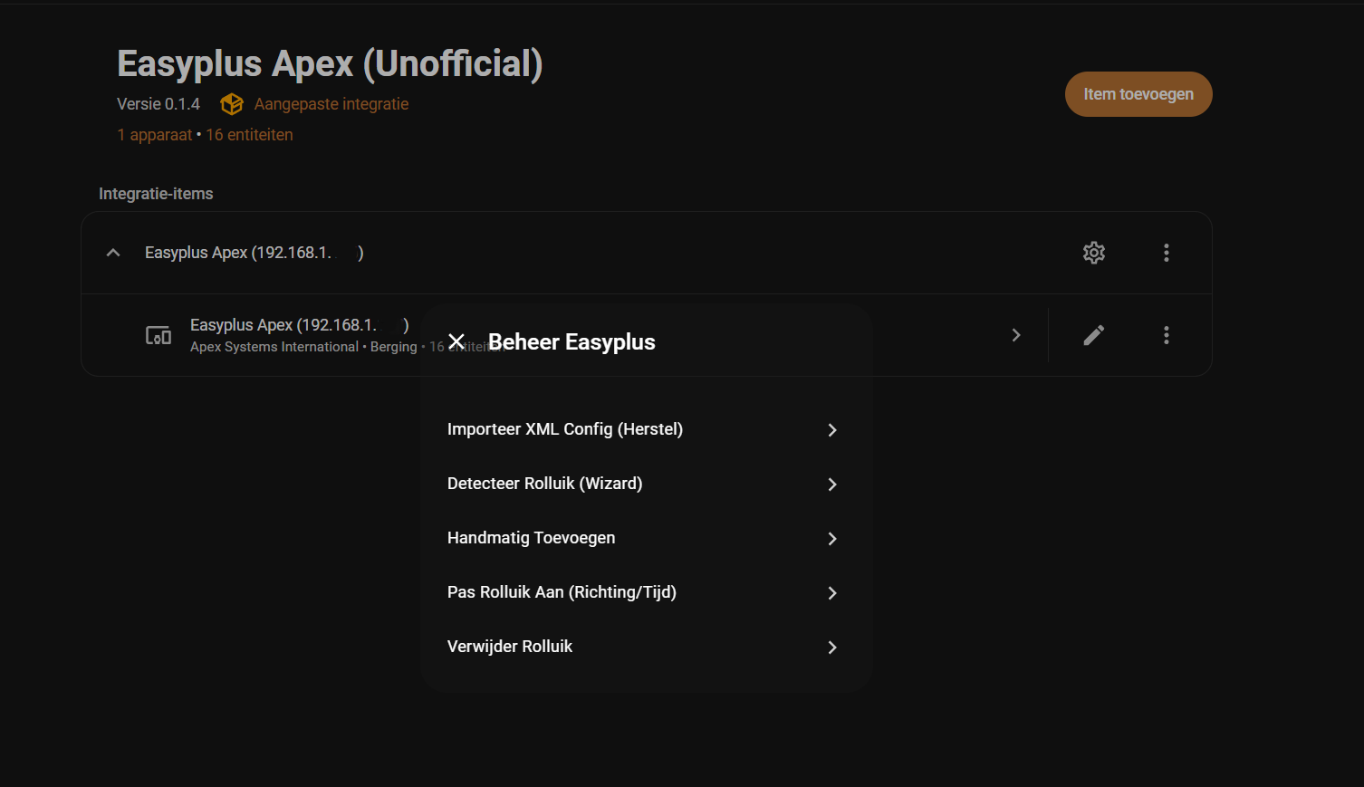

  • :window: Advanced Cover Management:
    • Wizard to detect new covers by pressing the wall switch.
    • Edit Tool: Did your shutter move Up when you pressed Down? You can now fix the direction or travel time directly in the device settings without reinstalling.
  • :zap: Rock Solid: Handles connection drops and reloads gracefully.
:camera: Screenshots
