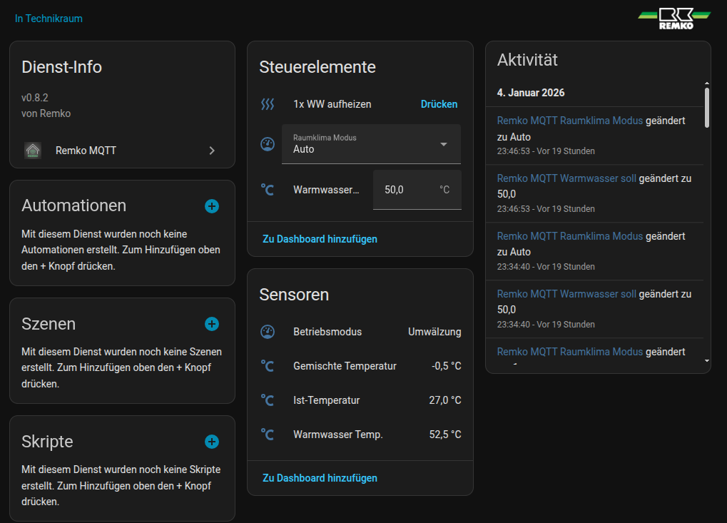

Wenn alles geklappt hat sieht das dann so aus:
Mir reicht das fürs erste mal, da ich eigentlich nur den Außentemperaturfühler brauche. (in dem Fall “Gemischte Temperatur”). Aber über die MQTT Verbindung könnte man jetzt wie in dem Thread schon ausführlich beschrieben auch direkt in der config.yaml sensoren anlegen. ohne die integration von altrec.

If everything worked, it then looks like this:
For now, this is sufficient for me, since I really only need the outdoor temperature sensor (in this case “Mixed Temperature”). But via the MQTT connection, as already described in detail in this thread, you could now also define sensors directly in config.yaml without using the Altrec integration.

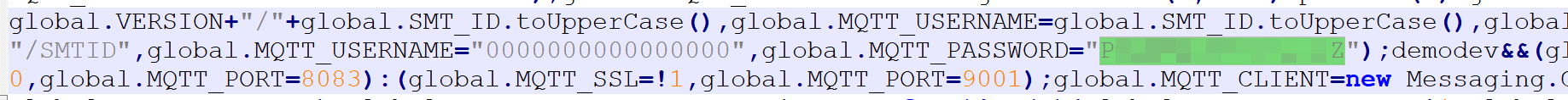

Hey there,
I worked on my integration some more, found some errors, made some improvements and some code cleanup.
First of all, the initial call for the capability check had an error resolving in the heat pump not answering to it. Furthermore the capability check will activate the home page alongside requesting the values. So in case you’re not interfering with the page via web browser or app while starting home assistant the check should work fine.
Additionally there was an error when activating the debug mode, altering the MQTT path resulting in no messages being send or received correctly.

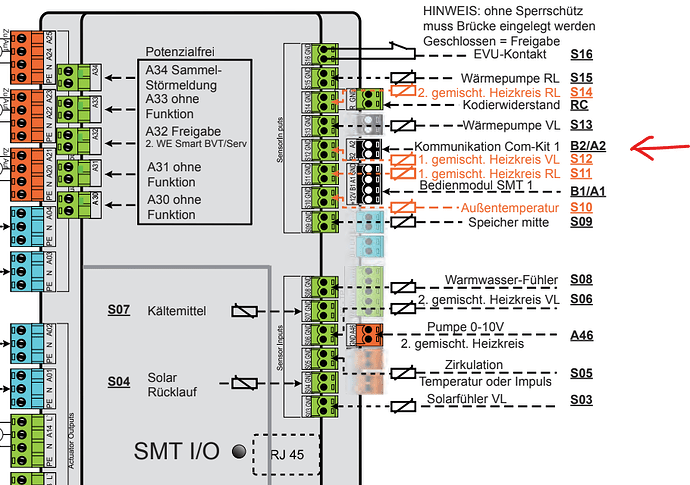

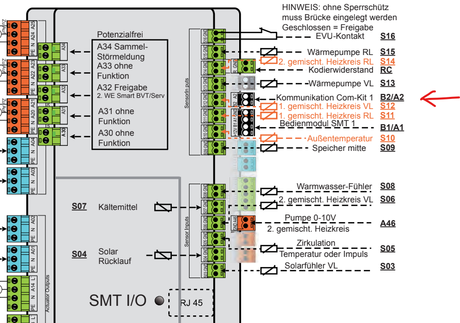

A2/B2 for Smart Com should work via Modbus. Is there any documentation of the Modbus registers available?
