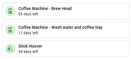

I want to display a list of tasks in my dashboard in each room, would it be possible to add Area to the tasks? I use below code to display each task with a label so I can differentiate room cleaning and appliance maintenance, but as I mentioned I would like to have this in each room so I can see what needs to be done in specific rooms. If we can’t add Area then I would at least like to show tasks with multiple labels as I would add label for example “Home Cleaning” and “Hallway”.

I worked out the code with help from ChatGPT however it’s not possible to mark the items done here, how can I do that? I was able to create a button for a task and mark it done only when I created a single button but it’s too tedious to create a button for each task.

Add this to your card template in auto-entities. Pressing it will reset it that way.
tap_action:
          action: perform-action
          perform_action: home_maintenance.reset_last_performed
            entity_id: this.entity_id
If you assign your entities to an Area, than you can also use the filters of auto-entities to only show for a certain area.

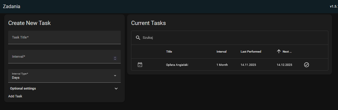

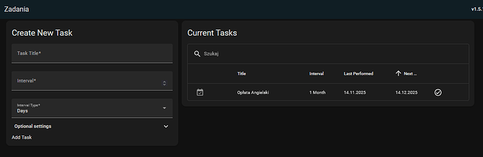

Love this idea and Integration! Is there a way to edit previous tasks, of do i just need to create a new task? I need to change the NFC tag.
this is what I was looking for for a long time!\anybody has a clue why my UI looks different than the one presented on GitHub ?

The edit dots are acting a bit flaky for me. Appear inconsistently (but more often not) on my web browser. Assume this is same issue. Seems to work better from the Companion app.

I noticed the Add Task button is small and kinda hidden/small.

I have never seen edit-dots :frowning:
edit: fixed in fix: make edit and delete buttons directly visible in task table by Momro · Pull Request #98 · TJPoorman/home_maintenance · GitHub
edit: mention @mvanlijden because he was asking for a fix
Hi @noack1978 ,
I could not reproduce this in the current version 1.5.2 :slight_smile:
Appears to be fixed
Thanks a lot!!
