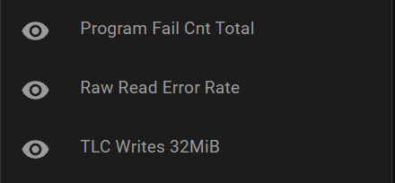

Good news: this is live now. Every named SMART attribute from the smartctl table that we don't already have a dedicated sensor for gets created as a diagnostic entity in HA. They're disabled by default ~ go to your drive's device page, scroll to the Diagnostic section, and enable whichever attributes you care about. Each one shows the raw value from the attribute table.
For your drive, you'd see things like Total SLC Erase Ct, Total Erase Count, Max Erase Count of Spec, Program Fail Cnt Total, Host Writes 32MiB, TLC Writes 32MiB, Available Reservd Space, and the rest ~ all as individual entities you can graph, automate against, or just keep an eye on.

It's a silicon motion based Transcend MTS952T (i created the pull reqest for the drivedb... :sweat_smile:). Couple of years back i got a bunch of them, the 128gb version ("used", pulled from new notebooks) for a couple of euros . I use it as a workhorse in projects.
Quickly tested the new version, and i got 22 new sensors :+1:.
