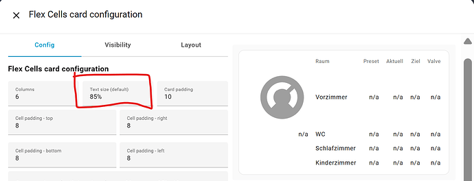

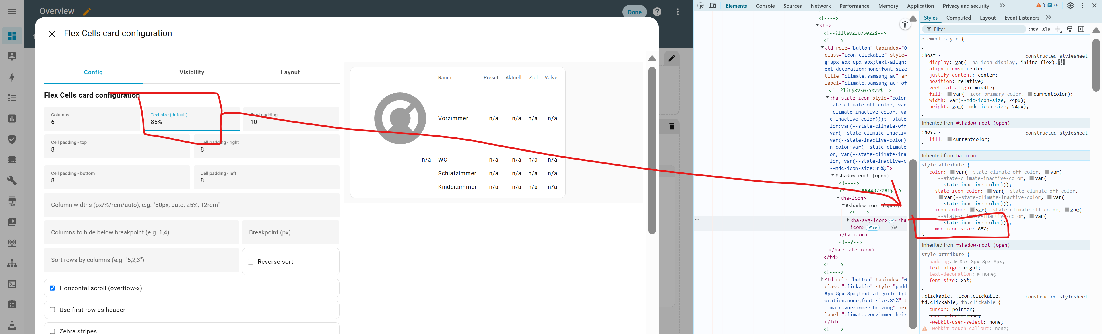

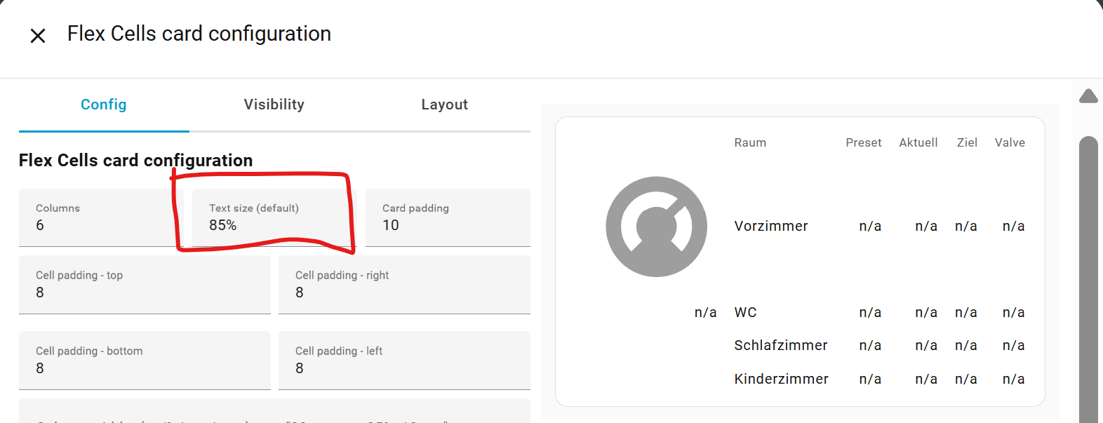

Unfortunately I don‘t understand. Why does a text size of 85% (to ensure the same text size als all other cards) trigger a huge icon? What‘s the solution?
So it’s a bug. Icon sizes should not be affected by a (per card) text size setting.

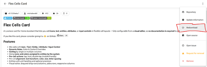

  • v0.12.0-beta (Pre-release) —
    • Added metadata (instead of attributes), now we have access to all data.
    • Improved “Text size (default)” in the main settings, it no longer affects icon size.
    • Added size setting for icons from entities.
    • Changed “Date/Time format” to “Date/Time format & Text override”. Now we can override the entity value even if it doesn’t contain a date/time.
    • Minor visual improvements.
This is a pre-release version. If no bugs are reported after a week, I’ll push it as the latest version.

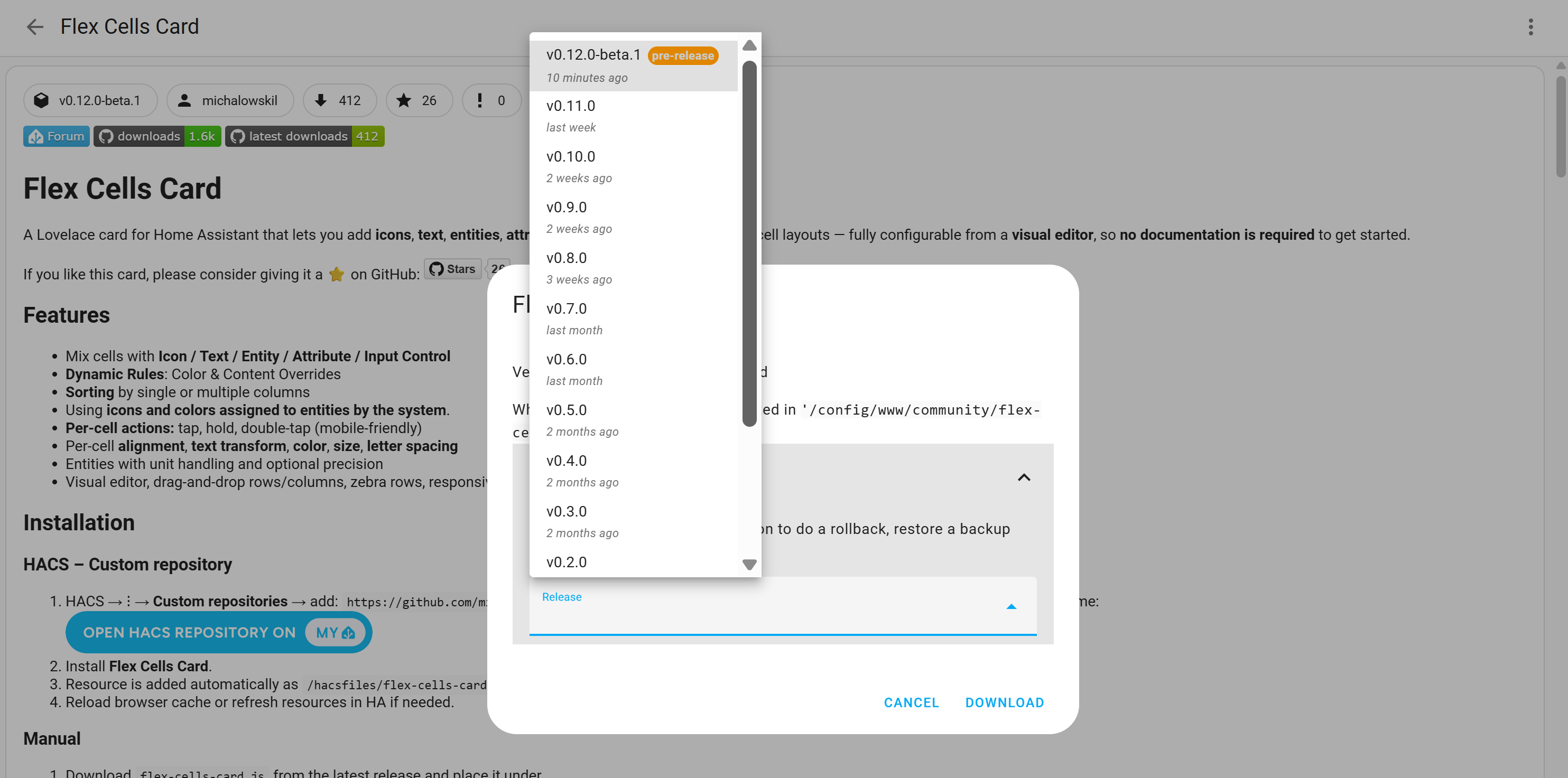

The pre-release version won’t automatically appear in updates. If you want to test this version now, you need to click Redownload in HACS.

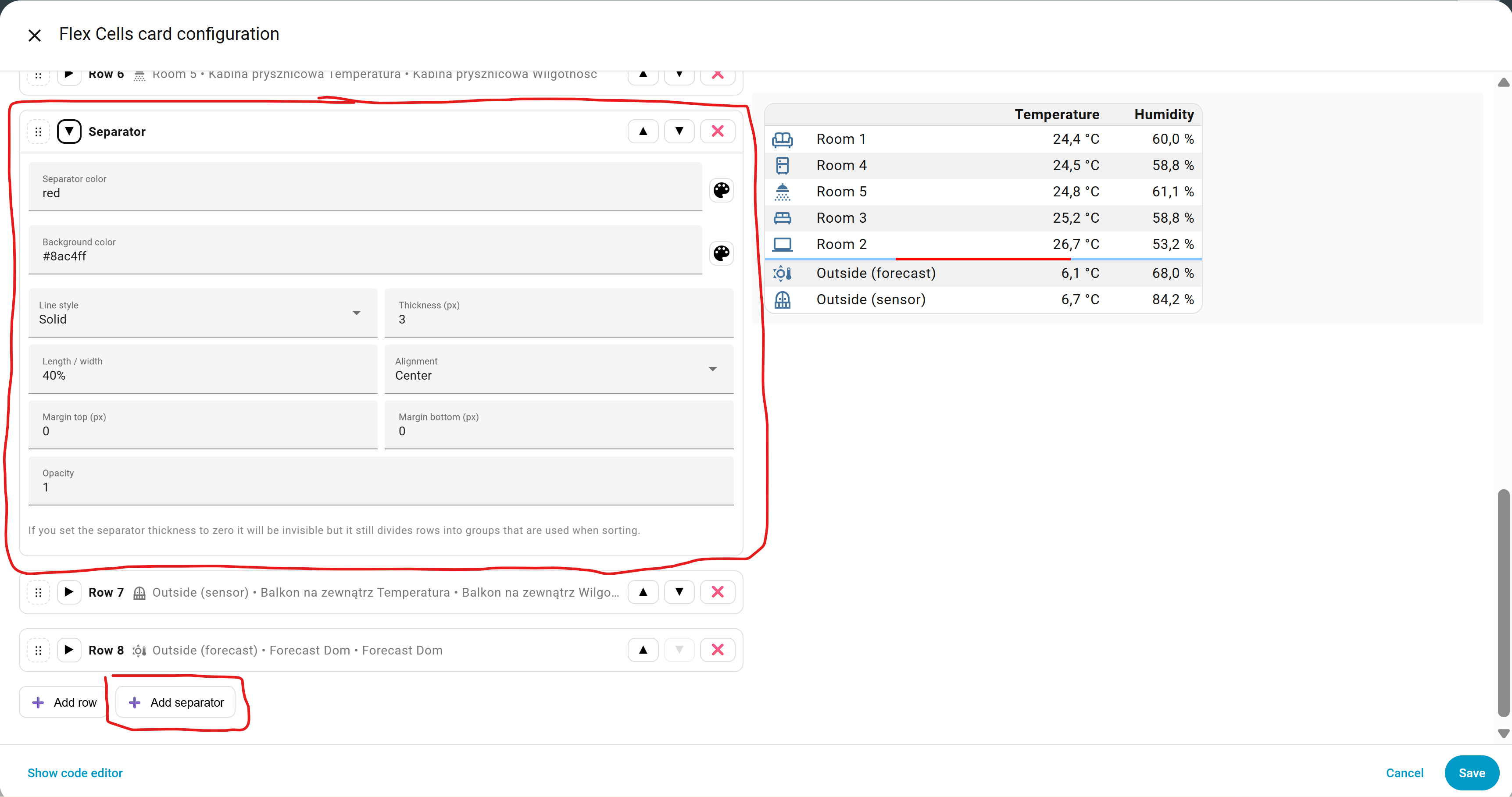

  • v0.13.0-beta (Pre-release) —

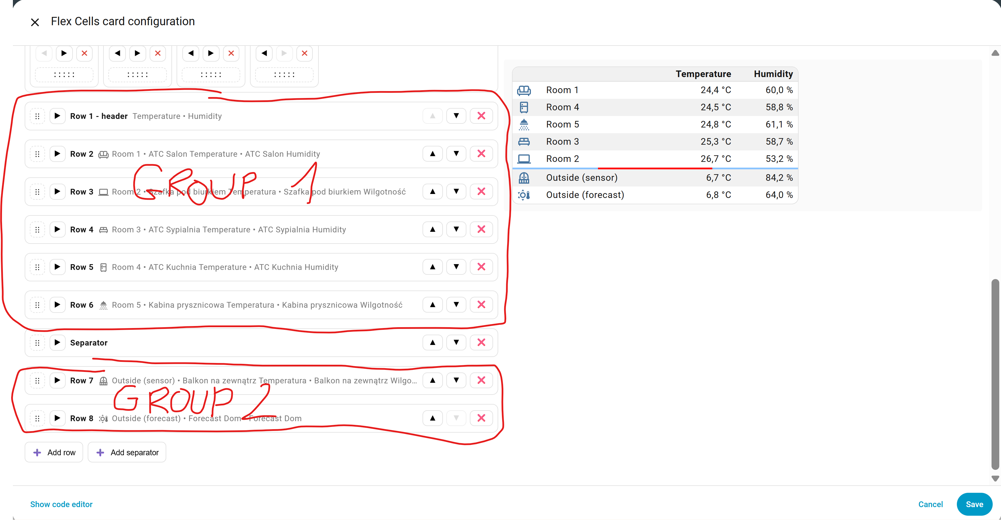

    • Added separators and sorting by groups.

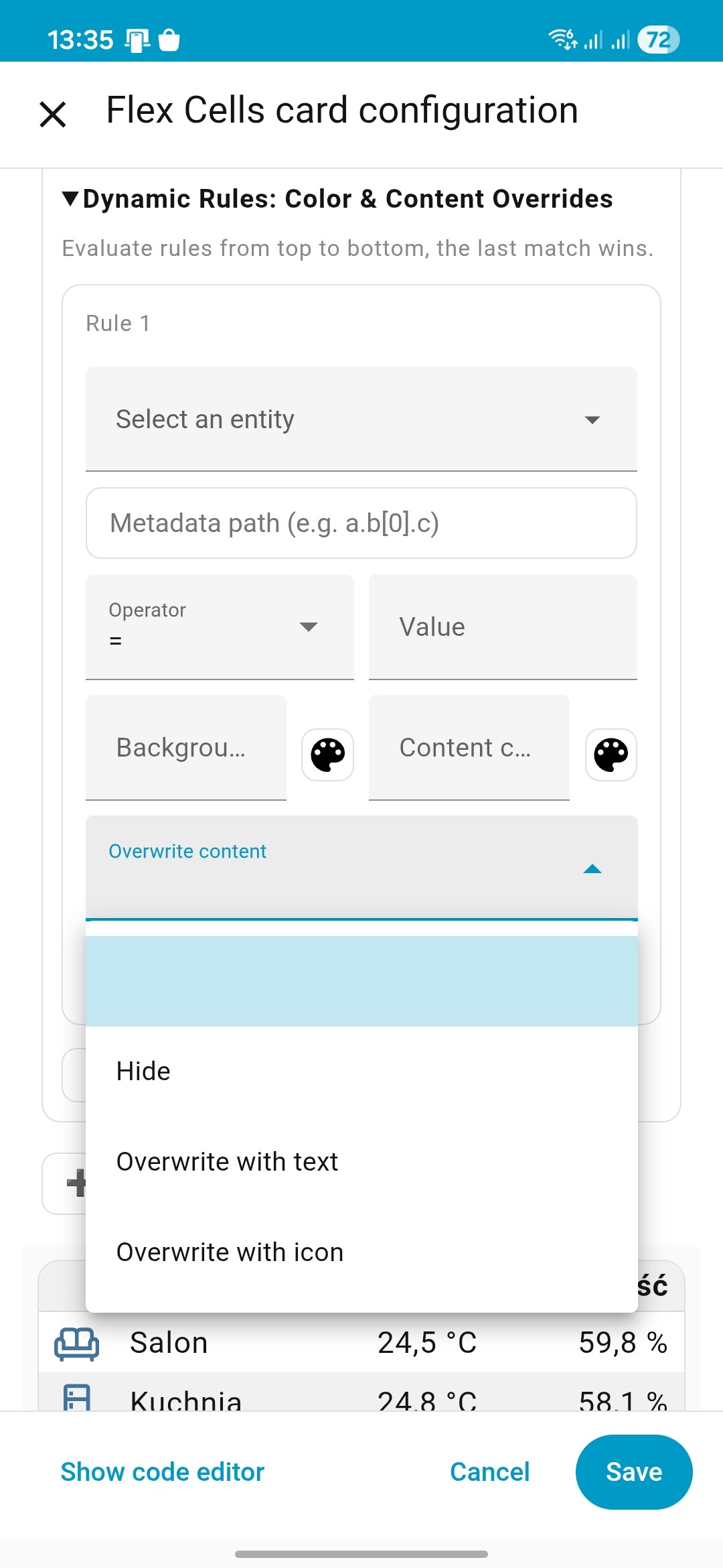

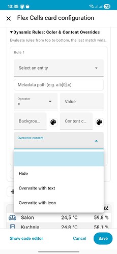

i really like the card. Is there a possibility to overwrite a value to a other entity (attribute)?
For now, you can overwrite with text or an icon. If you’d like to overwrite with an entity/attribute, please submit your idea on GitHub. Once it gets five votes, I’ll add the functionality.
I found a small bug regarding hiding the separator, so I fixed it. I also added the ability to dynamically hide the row. I encourage you to test it and report bugs.

  • v0.14.0
    • Added column merging.
    • Added entity/metadata overrides.

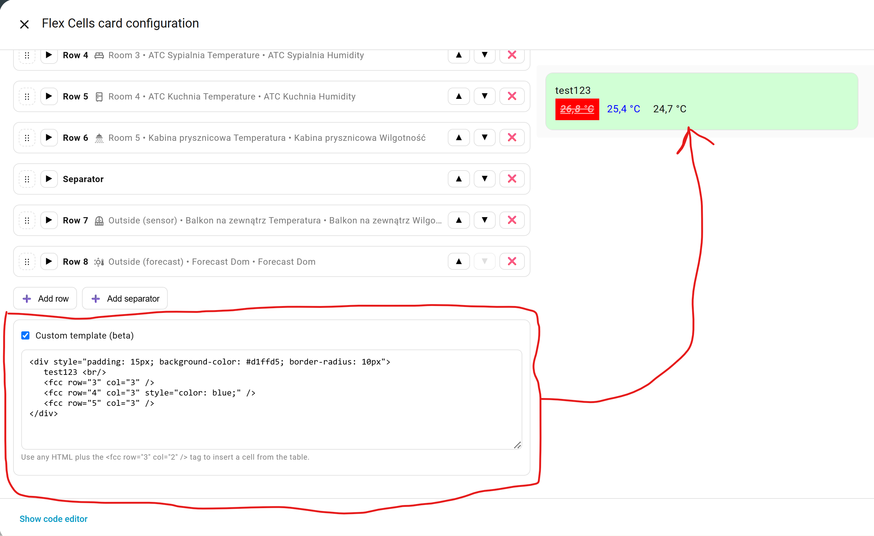

  • v0.15.0-beta (Pre-release) —
    • Added custom HTML templates.

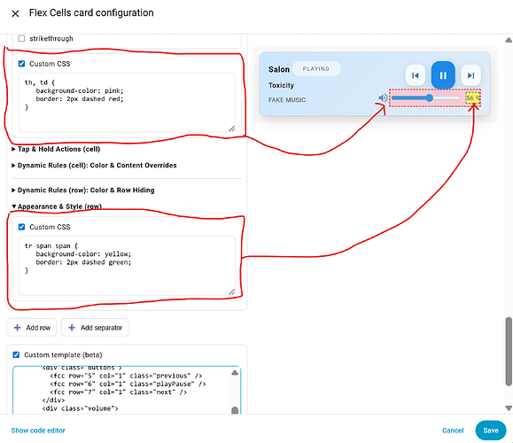

Templates are a powerful tool, but what if you don’t want to use a template but just use custom CSS? No problem! Now every cell and row has a custom CSS field:
Differences between v0.15.0-beta.1 and v0.15.0-beta.2:
  • added “custom CSS” for cells and rows (also works in templates), “card_mod” is no longer needed!
  • added “class” attribute for <fcc> tag (previously there was only “style” attribute)
  • added whole row injection in templates via <fcc row="3" /> (previously only cells could be injected)
  • improved line numbering for the <fcc> tag, now you can also operate with the header

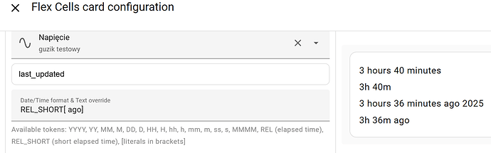

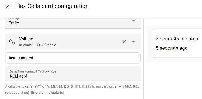

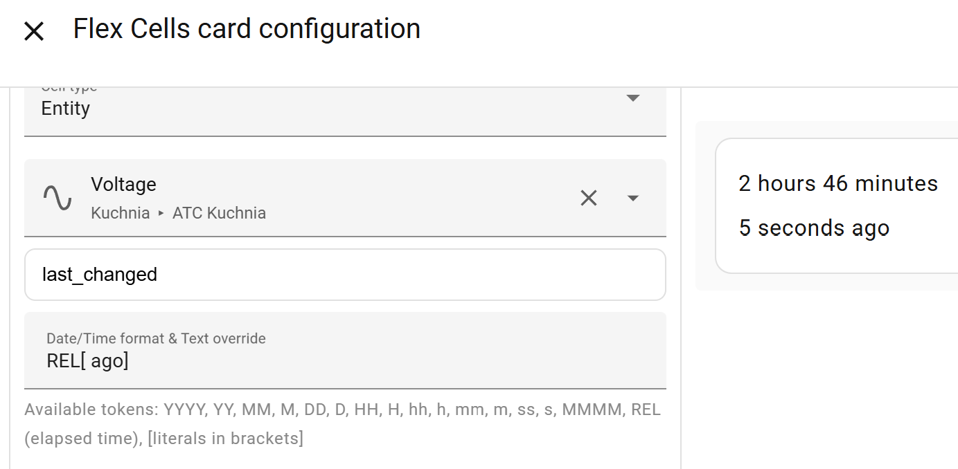

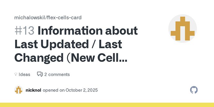

I just filed a wish at github concerning the format of timestamps.
The attribute “.last_seen” is shown in other lovelace cards as “16 minutes ago”.
In this card i can only format HH:MM and the like.
Could you implement a formatting option for timestamps like “relative_time”?
This would be really great :wink:
I like your idea. This feature will be available with the next release. In the meantime, you can click the star on GitHub – that’s the only payment I expect for my work :slight_smile:
