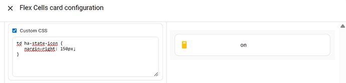

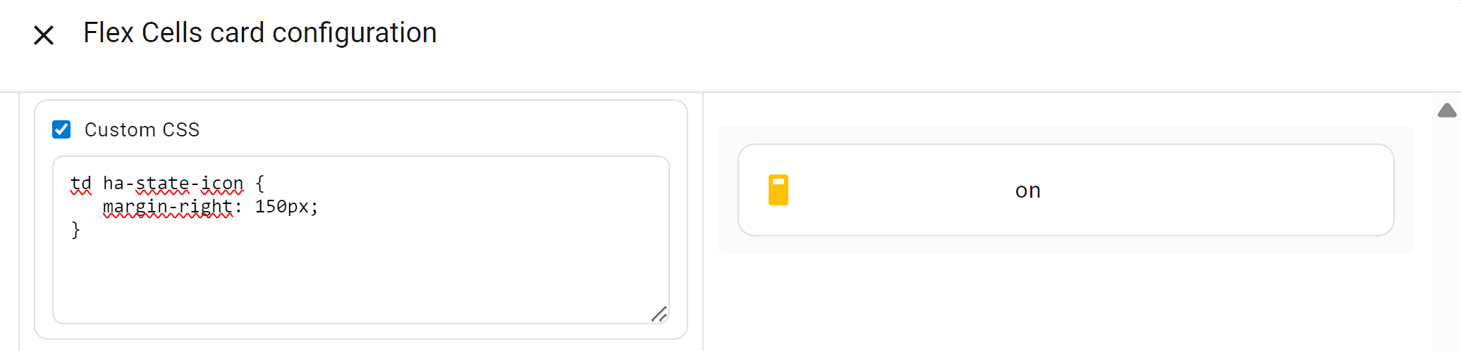

how can I change the the space between icon and value?
grafik
Custom CSS can be added to a cell/row/entire table. You can also use negative values.
td ha-state-icon {
   margin-right: 150px;
In your web browser, press F12 and then find the “inspect” tool. In Chrome, it looks like this:
This will help you know which names/classes to use.
that helps a lot…
thank you

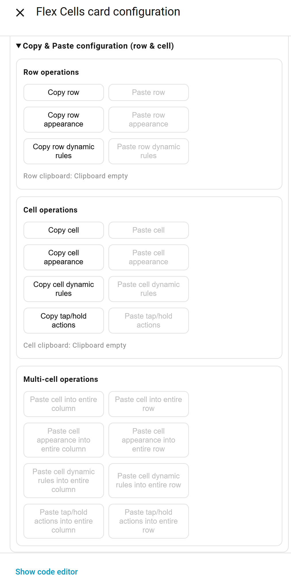

I was supposed to focus on adding examples, but for now I’ve added one more functionality:
  • v0.16.0 —
    • Added advanced copy and paste of table configuration.

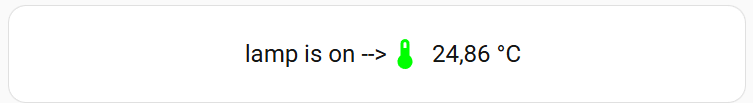

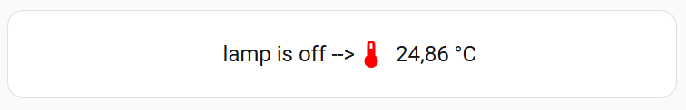

Not icon_color, but hs_color. Below is a working example I’ve tested. The icon color depends on the light state:
template:
  - sensor:
    - name: "Color Test"
      unique_id: sensor_color_test
      state: "{{ states('sensor.atc_sypialnia_temperature') }}"
      unit_of_measurement: "°C"
      icon: "{{ state_attr('sensor.atc_sypialnia_temperature', 'icon') or 'mdi:thermometer' }}"
      attributes:
        hs_color: >-
          {% set light_state = states('light.zarowka_hue_sypialnia') %}
          {% if light_state == 'on' %}
            [120, 100]   # green
          {% else %}
            [0, 100]     # red
          {% endif %}
        friendly_name: "Color Test"
        device_class: "{{ state_attr('sensor.atc_sypialnia_temperature', 'device_class') }}"
        state_class: "{{ state_attr('sensor.atc_sypialnia_temperature', 'state_class') }}"

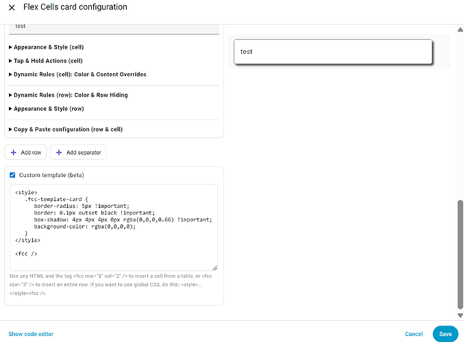

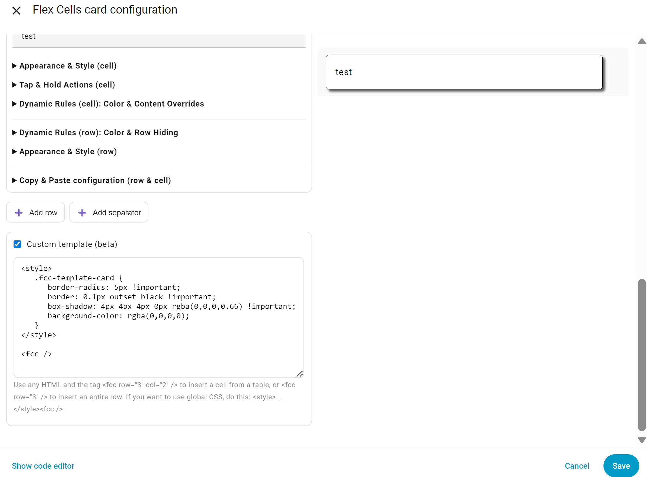

how can I change the background and border-radius of the whole card.
narmaly I do it this way
card_mod:
  style: |
    ha-card {
      --ha-card-border-width: 1px;
      border-radius: 5px !important;
      border: 0.1px outset black !important;
      box-shadow: 4px 4px 4px 0px rgba(0,0,0,0.66) !important;
      background-color: rgba(0,0,0,0);
Edit:
found it out. .card works
card_mod:
  style: |
    .card {
There’s no need to use card_mod. I’ve covered that in the “templates section”. Here’s how it works:
This is where you can write styles for the entire card. There’s also “custom CSS” for rows and cells.

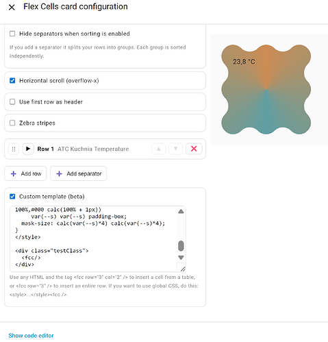

If you have any cool CSS, templates, or configurations for the FCC, please share them in show-and-tell category.
Below is a simple example that I borrowed from this site https://codepen.io/t_afif/pen/qBvXXBe
<style>
.fcc-template-card{
  border-color: transparent!important;
  background-color: transparent !important;
  padding: 0 !important;
.testClass {
  --s: 20px;
  --w: 200px;
  width: round(var(--w),4*var(--s));
  aspect-ratio: 1;
  padding: var(--s);
  border: var(--s) solid #0000;
  box-sizing: border-box;
  background: conic-gradient(#CD8C52,#5E9FA3,#CD8C52) border-box;
  border-radius: calc(3.5*var(--s));
  mask:
    radial-gradient(calc(sqrt(2)*var(--s)),#000 calc(100% - 1px),#0000),
    conic-gradient(#000 0 0) content-box,
    radial-gradient(calc(sqrt(2)*var(--s)),#0000 100%,#000 calc(100% + 1px))
     var(--s) var(--s) padding-box;
  mask-size: calc(var(--s)*4) calc(var(--s)*4);
</style>
<div class="testClass">
  <fcc/>
</div>

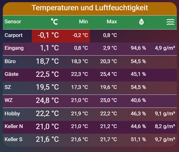

Excellent work. Thank you. I built this with your card:
