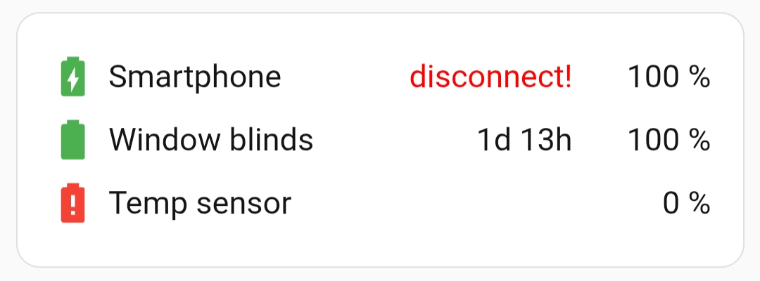

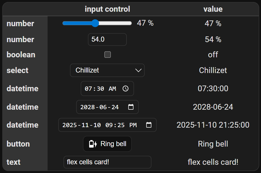

I just added a new example:
dark-charging
light-disconnect
While creating this example, I found two bugs that I fixed and added logical operators because they were definitely missing. So, here’s a new version.
  • v0.17.0 —
    • Added “AND/OR” logical operators in dynamic rules.
    • Added new fields in dynamic cell rules for the “Overwrite with entity/metadata” option: Date/Time format & Text override, Entity display, Rescale.
    • Fixed an issue related to changing the number of columns and the disappearance of unsaved dynamic rules.
    • Fixed an issue related to the column width for the “auto” value.

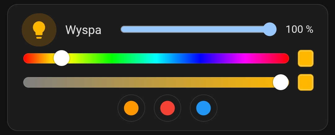

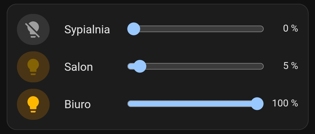

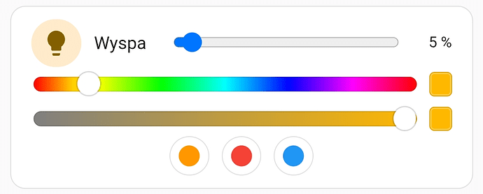

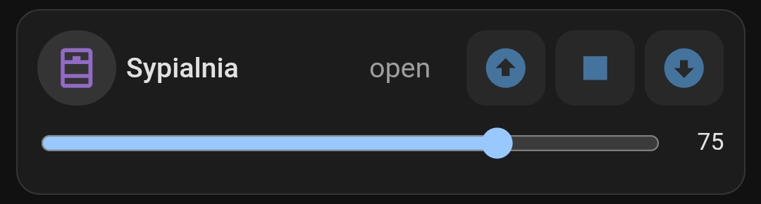

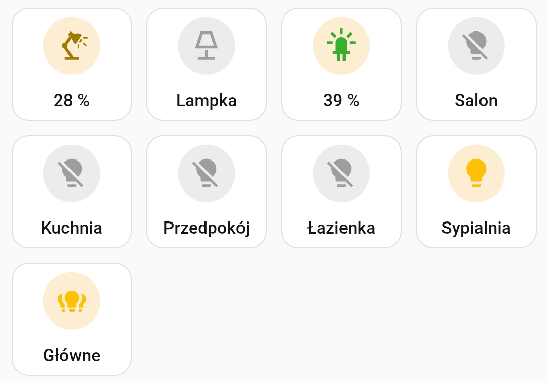

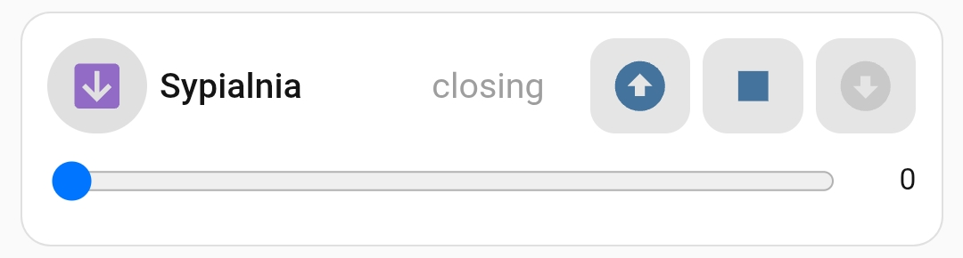

  • v0.18.0 —
    • Added attribute editing using slider and switch.
Thanks to this new functionality, the media player example has been greatly simplified. You no longer need to create automations or add input_numbers to the system - just FCC and nothing else.
I’ve also created two new examples using the new functionality. The first one controls a window blind:
dark_open
light_closing
The second one controls lighting:
dark
light
I’ve released a new version, with three new examples and updated screenshots. If you like this card, please consider giving it a :star: on GitHub.

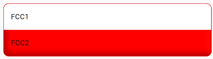

That’s always great to hear! There will be even more features coming - for example, yesterday I posted a pre-release that lets you adjust hue and saturation using a slider.

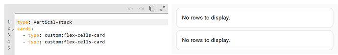

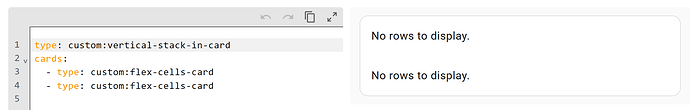

If you use custom:vertical-stack-in-card you won’t have to mess with the border, this card gives you one border by default.
I have tried with both options and they are working,
but in both cases I’m not able to add a box-shadow via card_mod any more.
card_mod:
  style: |
    ha-card {
      box-shadow:
        inset -6px  6px 12px hsla(43, 95%, 80%, 0.06),
        inset  6px -6px 12px rgba(0, 0, 0, 0.3);
Does the DOM change here so that I need to adopt my card_mod code?
I already tried some other options like :host or vertical-stack-in-card instead of ha-card, but nothing worked in this stacked case, while without stacking it works fine.

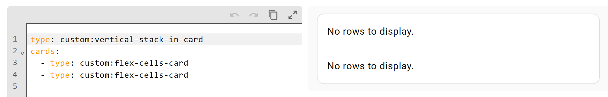

If you add shading to a VSIC and then apply an FCC over it, the FCC will cover the shading. Set the FCC background to transparent so you can see what’s underneath.
type: custom:vertical-stack-in-card
cards:
  - rows:
      - cells:
          - type: string
            value: FCC1
            align: left
            style:
              text_transform: ""
    column_count: 1
    card_padding: ""
    overflow_x: true
    header_from_first_row: false
    zebra: false
    narrow_breakpoint: ""
    text_size: ""
    cell_padding:
      top: 4
      right: 0
      bottom: 4
      left: 0
    custom_template_enabled: false
    custom_template_html: ""
    type: custom:flex-cells-card
  - rows:
      - cells:
          - type: string
            value: FCC2
            align: left
            style:
              text_transform: ""
    column_count: 1
    card_padding: ""
    overflow_x: true
    zebra: false
    text_size: ""
    cell_padding:
      top: 4
      right: 0
      bottom: 4
      left: 0
    custom_template_enabled: true
    custom_template_html: |-
      <style>
      .fcc-template-card {
        background-color: transparent !important;
      </style>
      <fcc />
card_mod:
  style: |
    ha-card {
      box-shadow:
      background-color: red;
You can also apply shading top+left+right for the first FCC and bottom/left/right for the second FCC, then card_mod won’t be necessary. ChatGPT handles these types of problems quite well.
Pressing F12 in your browser will give you access to the “inspect tool” – this makes it very easy to see elements/classes/CSS settings.
Thanks a lot, it’s perfectly working.
I only understand partly why, but I got 2 books about CSS and started reading the first one.
After finishing the 2nd one I hopefully understand these things not only partly.
I’ve added the Crowdin service to the project. This allows us to translate into any language on crowdin.com, and I can “pull” those translations into the FCC. The source language is English. If a string isn’t translated, it falls back to English - so there’s no need to translate everything. In the meantime, I’ve discovered that clicking the “Request New Language” button doesn’t work, so let me know in another way which languages ​​you’d like to translate, for example here.
The README includes a quick start guide for translators:
https://github.com/michalowskil/flex-cells-card#translations
In addition to the above, I’m releasing the new version v0.20.0. This new functionality already has a dedicated example.
  • v0.20.0 —
    • Added sliders for hue and saturation.
    • Integrating FCC with crowdin.com.
