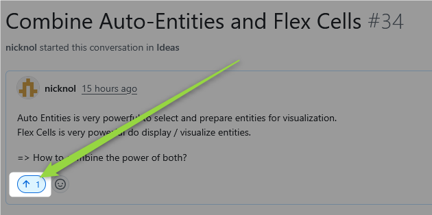

I suggested to @michalowskil, the creator of the Flex Cell Card, that it should be made compatible with Auto Entities — meaning: fetch the data via Auto Entities and visualize it using the Flex Cell Card.
He’s open to the idea, but he wants to see general interest first.
My request: Please vote for this feature.

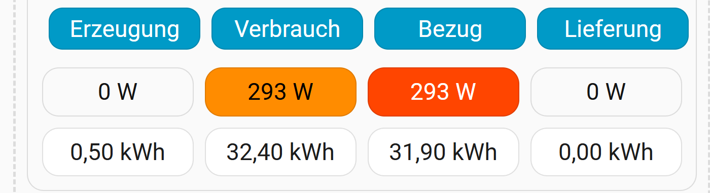

Is it possible to add a rounded border to individual cells? Like this, for example?
This example is composed of many button cards and is very time-consuming to create.

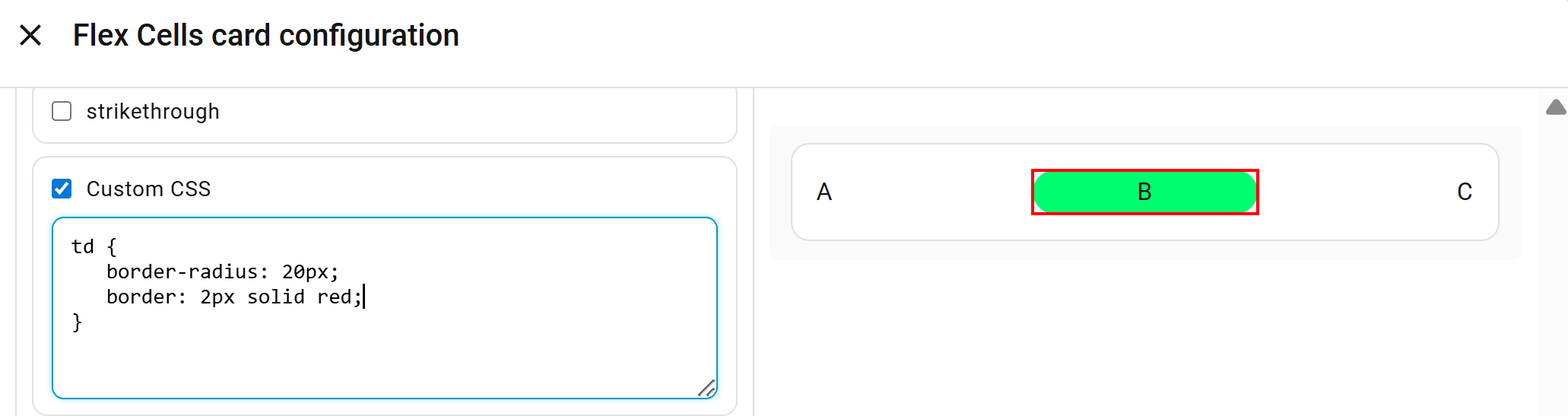

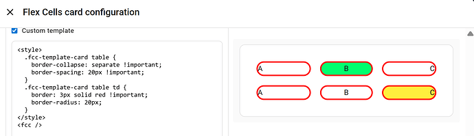

If you want to round the background without a border, you can do this:
However, if you add a border, it will be square:
It’s a matter of CSS for the entire table. To make it work correctly, just do this in the template:
You can set border individually for each cell or for all of them at once:
