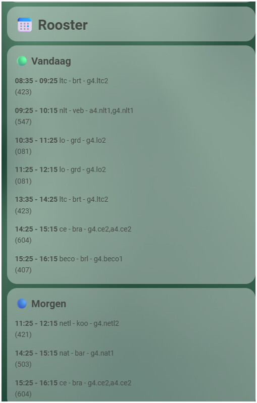

Example markdown chart
type: vertical-stack
cards:
  - type: markdown
    content: |
      # 📅 Rooster
  - type: markdown
    content: >
      ## 🟢 Vandaag
      {% set vandaag = now().strftime('%Y-%m-%d') %}
      {% set afspraken = state_attr('sensor.magister_voornaam_achternaam', 'afspraken') %}
      {% set afspraken_vandaag = afspraken | selectattr('start', 'match', '^' + vandaag) | list %}
      {% if afspraken_vandaag %}
        {% for afspraak in afspraken_vandaag %}
      **{{ afspraak.start[11:16] }} - {{ afspraak.einde[11:16] }}**
      {{ afspraak.omschrijving }}
          {% if afspraak.lokaal %}({{ afspraak.lokaal }}){% endif %}
        {% endfor %}
      {% else %}
      Geen afspraken vandaag
      {% endif %}
  - type: markdown
    content: >
      ## 🔵 Morgen
      {% set morgen = (now() + timedelta(days=1)).strftime('%Y-%m-%d') %}
      {% set afspraken_morgen = afspraken | selectattr('start', 'match', '^' + morgen) | list %}
      {% if afspraken_morgen %}
        {% for afspraak in afspraken_morgen %}
        {% endfor %}
      {% else %}
      Geen afspraken morgen
      {% endif %}

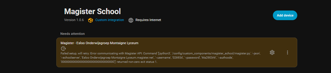

After installing it and providing the login details i get an error message:
  • Failed setup, will retry: Error communicating with Magister API: Expecting value: line 1 column 1 (char 0)
I installed it ten times now, no failure at all.
Did you enter the right credentials and school name?
Because I know 100% thats the problem
you only need the first school name.
My kids school is : Trevianum Scholengroep
I only need to fill : trevianum
only the first name off the school.
Also sometimes you need to login first into the webpage,
allot times Magister ask for password renewal.
check first online
On the website at school i only give in Porteum
Then user name and password, but then getting the error
Also tried capital and small letters, username iwth and without domain.
When i give in the wrong (ex. Port) schoolname, it gives a different error:
Failed setup, will retry: Error communicating with Magister API: Command ‘[‘python3’, ‘/config/custom_components/magister_school/magister.py’, ‘–json’, ‘–schoolserver’, ‘Port.magister.net’, ‘–username’, ‘XXXXX’, ‘–password’, ‘XXXX’, ‘–authcode’, ‘00000000000000000000000000000000’]’ returned non-zero exit status 1.
School name is indeed porteum
please try this
  • Run this from the machine that runs Home Assistant (use the same Python as HA, often python3 in a terminal on the host). Replace USER and PASS with your credentials.
python3 /config/custom_components/magister_school/magister.py --json --schoolserver porteum.magister.net --username 'USER' --password 'PASS'
  • If that returns nothing or non-JSON, run the script without --json and with debug so you can see diagnostic prints:
python3 /config/custom_components/magister_school/magister.py --debug --schoolserver porteum.magister.net --username 'USER' --password 'PASS'

It comes back with: Invalid challenge.
Will try to reset the password later

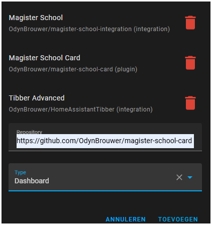

You guys need to select “Dashboard” in the custom HACS
Julie moeten HACS Custom en dan Dashboard kiezen.
After that you need click on the repo, then on the bottom click on the button “download”
Daarna moet je op de repo klikken en dan op “download” knop klikken.

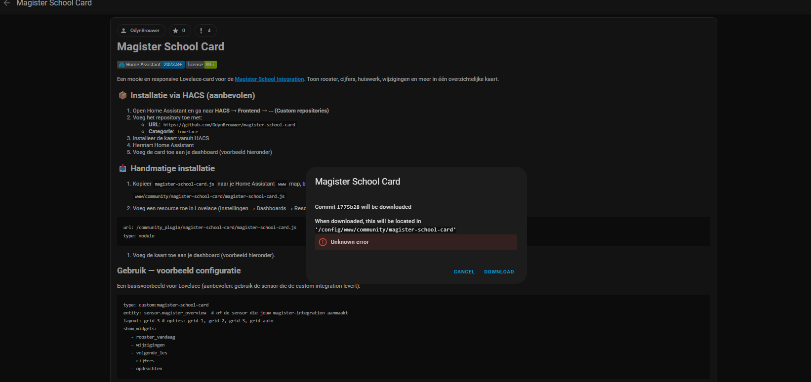

ik heb dat gedaan aleen ik heb een andere probleem het lukt me niet met die inigratie in de logge ik probeerde wat jij zij maar het lukt niet ik heb al een foto van de erro gestuurd en het was 100 procent de goeie inlog gegevens
Alles werkt perfect,
Je zult eens moeten inloggen via de webpagina.
Want waarschijnlijk moet je wachtwoord veranderen.
Hier liep ik ook tegenaan in het begin.
Ook de schoolnaam moet goed worden ingevuld.
ik heb net ook een Patch geupdate
het werkt nog steedst niet weet je meschien waar door het komt @mupsje
en alles klopt alles is goed de goeie naam de goeie inlog gegeven s en ik heb ook wachtwoord reset en de nieuw in gevuld maar nog steeds niet
en nog iets als ik de debug in terminal doe welke jij had gestuurd en de link aan pas naar mij school en mijn inlog gevevens doe en dan schroll ik na boven in terminal en dan staat daar wel mijn achter naam en mijn voor naam en mijn info dus dat werk wel
