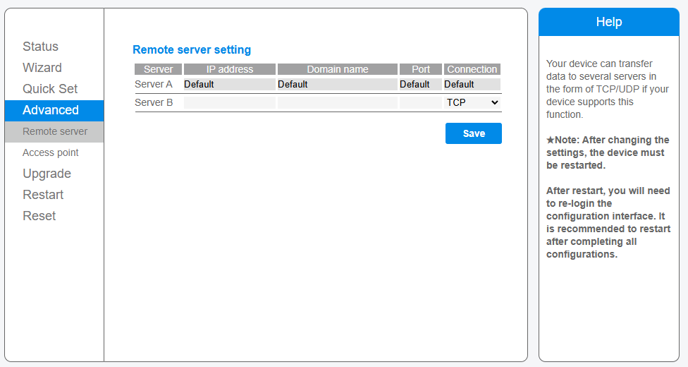

Yeah, I can access the, very limited, config page but the only thing, besides wifi config (without the ability to disable wifi), is another server (see screenshot)
Oh yes, that screenshot brings back memories.
I had two/three of these Loggers, for my Solis inverter. The original (oldest) one supplied by my installer had the facility in Server B to on-post to another remote server, as well as an open 8899 port for direct Modbus access to the inverter. I tested both using Node-RED and the standard http node.
I found these little devices most frustrating, and I eventually abandoned my logger(s) [actually I ending up fixing them with a large club hammer] and went with a direct Modbus connection, since this avoids the cloud and gives me 15 second updates rather than 15 minutes (with Solis Cloud). I now can’t remember exactly what little worked and what did not, but you may wish to experiment.
I had to search, but here is my post on the ‘Loggers’ from three years ago. I noted at that time that these loggers were gradually going WiFi - my open/working logger was a LAN only model - and that in the newer WiFi models any open access appeared to have been removed.
I guess, going back to your original question, your options are limited to using the Solarman-based integrations etc that work with the standard WiFi logger / cloud.
I am still curious as to which battery port this S-Logger is attached to, and how they stich together in the cloud the battery info with the inverter info. Your battery pack must connect to your inverter via either CAN or the RS485 port. If CAN, then the RS485 port is open for use. If there is also still, as I expect, the usual Pylontech RS232 port for console access, which is the port I use to extract battery information down to the cell level.
