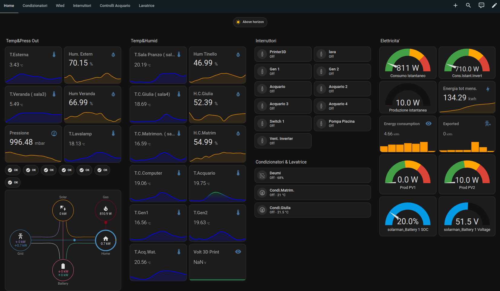

What’s happening is that, after both upgrade, the overview ( my overview I suspect ) page is hitting hard on my laptop CPU.
If I change to any other page I have in my installation, the CPU drops from 250 to almost 0, but when I came back to Overview then CPU jump to more than 200% ( which means is using more than 2 core of my PC ).

Is not even such a complex page:

From my previous experience, it’s the moving dots in the energy card that generates this CPU usage. I switched to Power Flow card plus and deactivate moving dots and then CPU came back to normal.

It seems that removing the energy card fixed istantly the issue.
