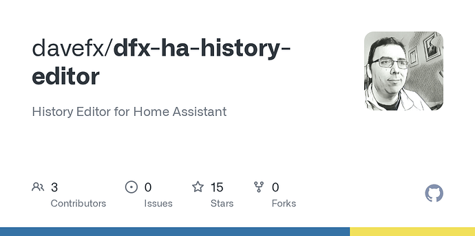

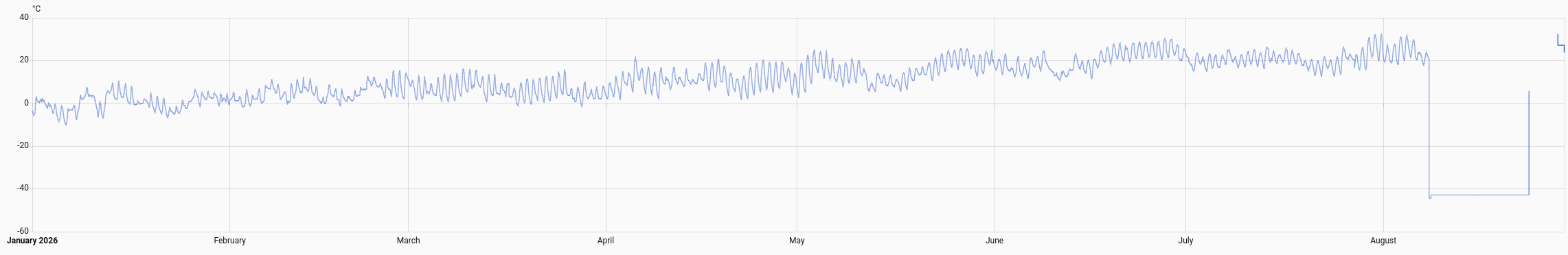

Now I have the problem that the data is wrong between the time when the old sensor broke and the new one was in place:
I found this to fix it:
But I was wondering if there is a way without installing a new component?
