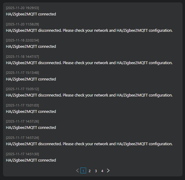

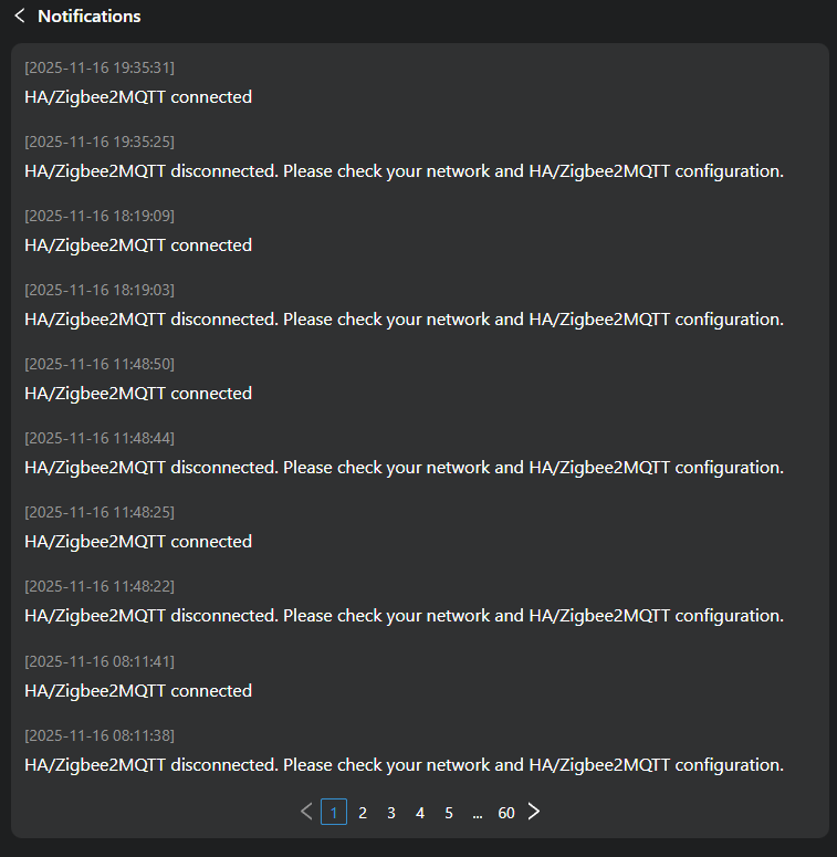

I have been battling since switching from SLZB-06p to the new sonoff dongle max. After a lot of frustration I have identified there is an issue with random disconnects from the dongle, as reported on the sonoff I see:
Has anyone else experiences this, as I am trying to understand if its some kind of issue with my setup, or if this is a common dongle max issue that I am hoping maybe addresses in a firmware. It appears to be an issue even after a full reset of the network, and is not so much an issue with the network but the connection of the dongle to Z2M.
Any experiences with the Sonoff Max dongle that a similar or faultless would be appreciated to save my hair!
