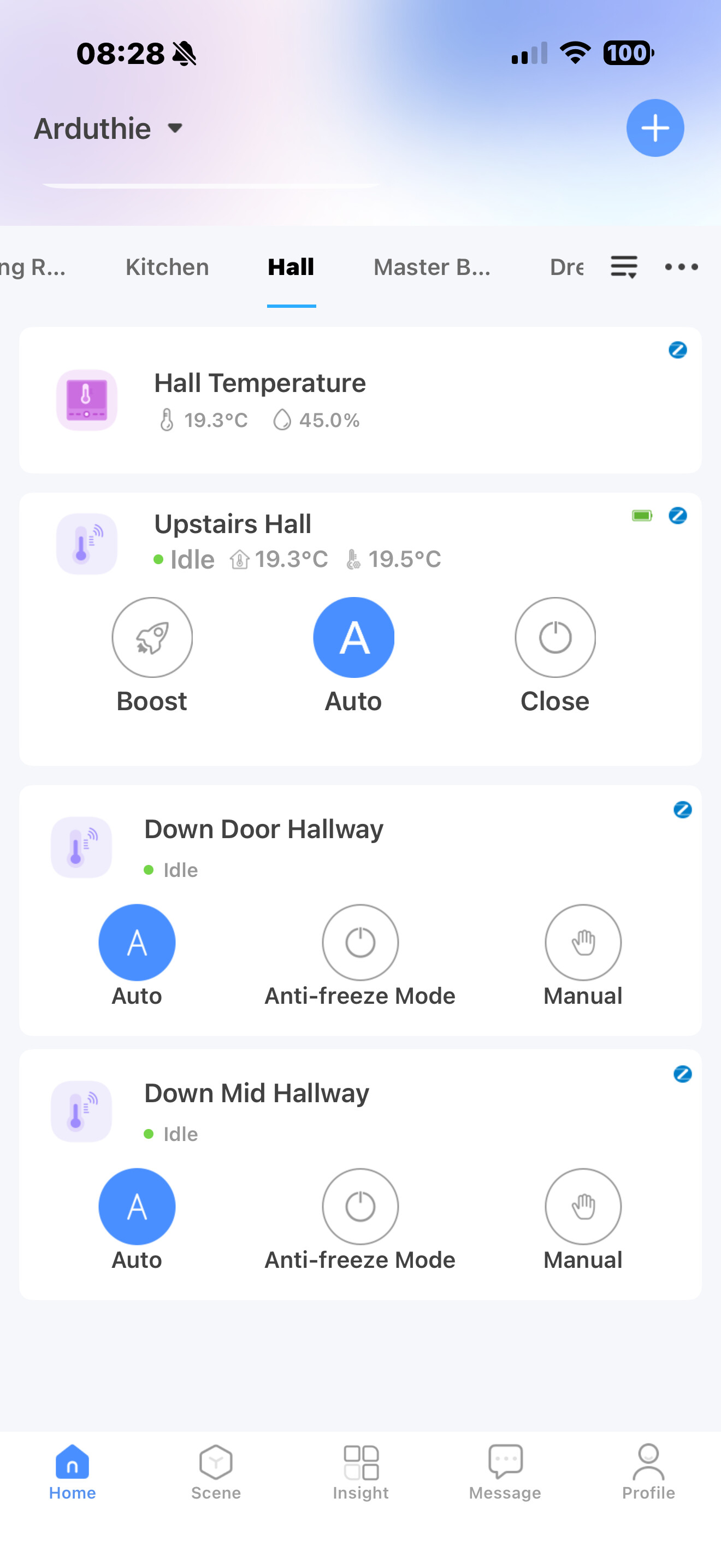

Upgrade has been ok - however I see two different types of image for the TRVs via EWeLink App.
Is anyone else experiencing this even though firmware confirmed as 1.4.1?
