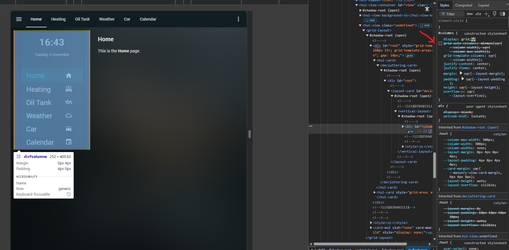

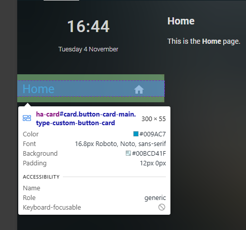

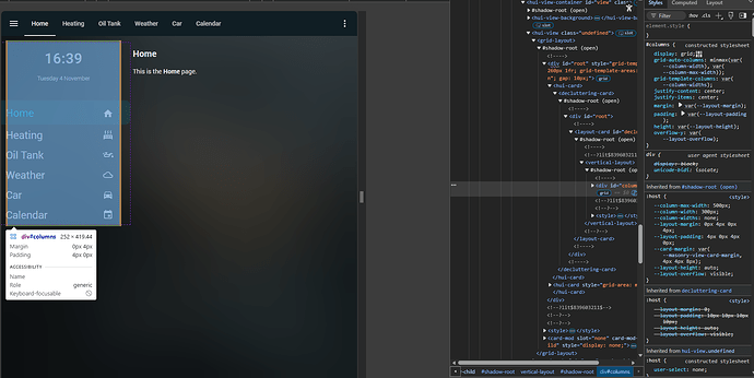

New to Decluttering card - Button card column width problem
I’m enjoying using the decluttering card to help tidy up my new dashboard that I am working on, however I am having an issue trying to restrict the width of a vertical column of cards within the decluttering card template.
I have a ‘sidebar’ which is made up of custom button cards in a vertical column, which is contained in a decluttering template. This all looks fine on desktop, but smaller screen sizes like tablet, I would like the entire sidebar/column of button cards to shrink down to take up less width, however I seem to be coming up against an overriding 300px column width in my designated sidebar area. I am specifying 260px as the column width in my grid layout of my dashboard where the sidebar code resides, but the button cards all break out to the right of this 260px, as they are using a 300px width. In developer tools in my browser, if I untick ‘grid-auto-columns’ in the div id ‘#columns’ here:
    grid-auto-columns: minmax(var(--column-width), var(--column-max-width));
then my vertical sidebar column shrinks down correctly and achieves the sort of size I am trying to achieve:
This is my decluttering_template/sidebar.yaml

Can anyone help to guide me on how to target this column width correctly, and then I can apply and adjust this accordingly via media query for different sizes of screens. Thanks in advance!
That is coming from layout-card. Look there for your likely solution.
Overall, its difficult to follow the dots for your config. If you break it down to a minimal config that we can copy and test, you may get some ideas, and may even find your own solution on the way.
Thank you for pointing me in the right direction - I’ve changed my entire layout-card code in my sidebar.yaml decluttering template, as I had misunderstood the requirements. I was trying to use vertical layout, but I have now changed over to use custom:grid-layout as my layout_type within my layout-card instead, so I’m now using:
  type: custom:layout-card
  layout_type: custom:grid-layout
  layout:
    grid-template-columns: 20% 60% 20%
    grid-template-rows: auto
    grid-template-areas: |
      "left middle right"
and this seems to give the control I need over the width of the content of my sidebar cards.
