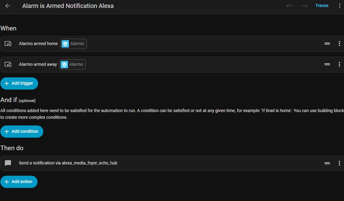

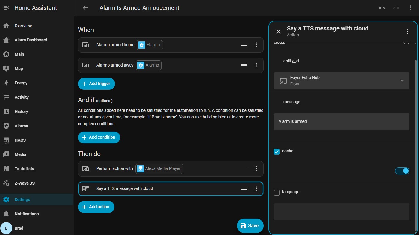

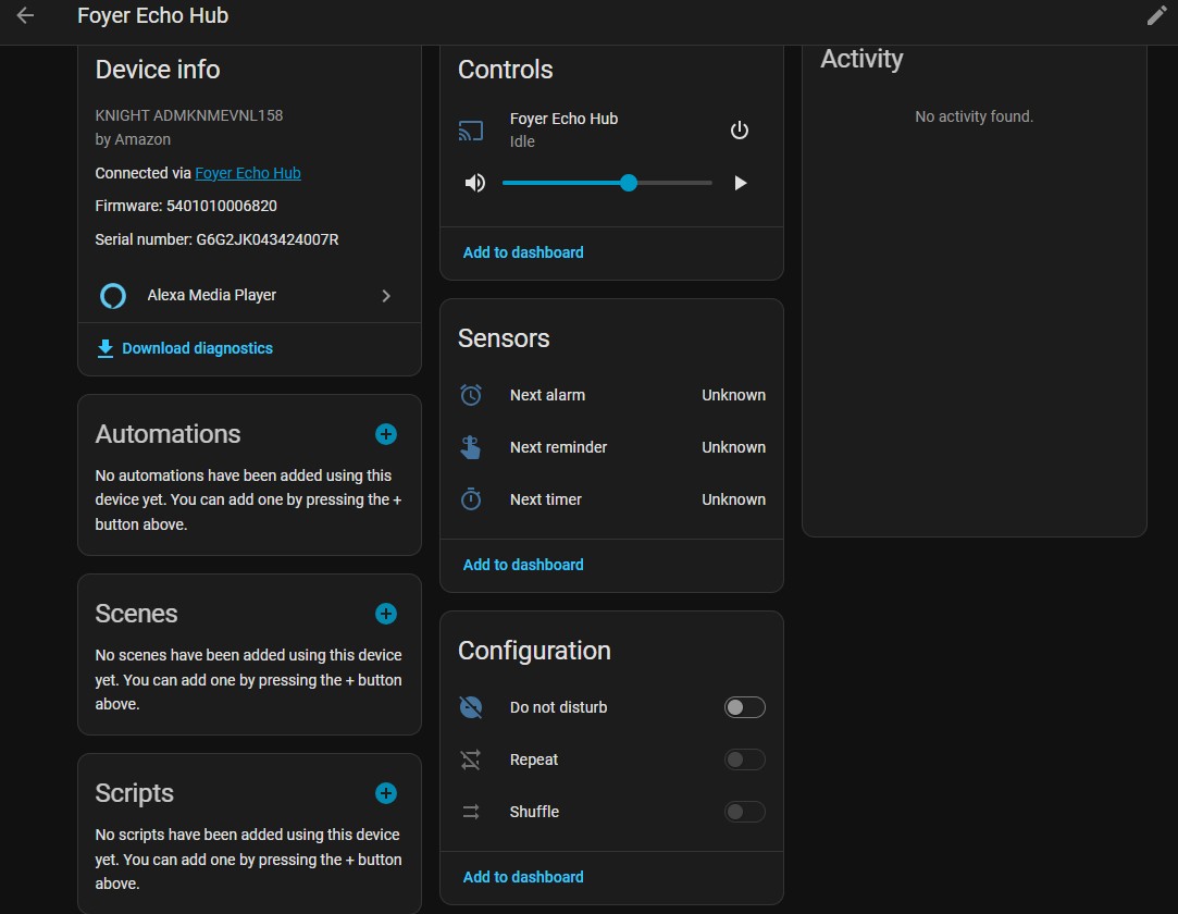

Hi. So, I'm a long time smart home guy, but have just started with HA because I've reached the limit of my SmartThings hub. I started with Alexa, and still have all my echoes. I never got too far into really custom stuff, just mostly what works natively and a little into stuff that used custom drivers. Anyway, all I've done with HA so far is set up an Alarmo alarm. I've brought the SmartThings integration in with most of my devices, but all my non-alarm smart home stuff is still in SmartThings. I see that you can use Alexa as a media player, and I thought that sounded like fun. I downloaded it off HACS, and I thought I got it all configured. The echo devices are there, but I think I might be missing some of the entities it's supposed to bring in. People online do stuff where you can make her say things with TTS. I wanted an automation where she will tell me when the alarm has been armed. I created the automation, but it won't save because there is an "Integration Not Found" error. If you look at the Integrations page, it's there under "Configured". I've never set up any sort of media or TTS stuff, so maybe there's something I need to enable that I haven't yet? I tried posting on the FB group, but it's pretty busy over there with people constantly making new posts about AI or whatever. Any help would be appreciated.

What makes you think that? Which entities are missing?

Here is my automation.

And this is the device page for one of my echoes.
But, you know what? I got it to work. Here's the one that works.
