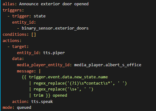

So here is an example of what I have. But it keeps saying triggered, like every second. everything seems to be triggering it:
ChatGPT Helped Provide This:
Don’t listen to the bullshit engines.
That trigger fires on every state and attributes change of every entity in your system. Even with a small number of entities it is practically useless, because it fires so often it will overwhelm the queue.
yes I noticed, but cant figure it out. otherwise
Just use a State trigger that lists the door sensors.

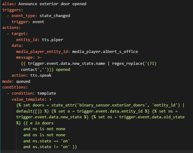

I know I can do it off "Device, trigger, contact, but how can I do it for a helper where I list the ones I want. I have 100’s of rule I need to move over and if I need to make a change, updating a global is way easier than editing 100’s of rules. Like if a device dies and needs to be replaced. I don’t want to edit every rule.
I have tried this but that does not work at all.
What I have told you above is the current best option.
Triggers are currently being overhauled, but what you are asking for is not available yet.

That will fire on any state or attribute change of that binary sensor, but the template is non-sense for that trigger.
You could use that, and then use templating to get the most recently changed entity, but it will leave a lot of edge cases where you won’t get a message.

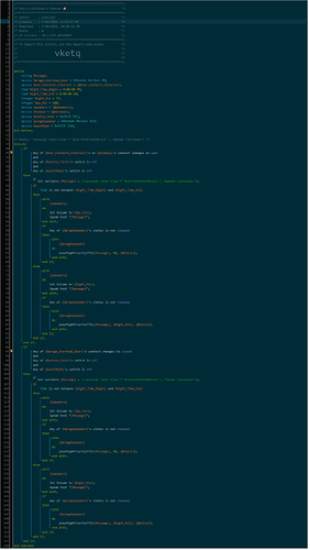

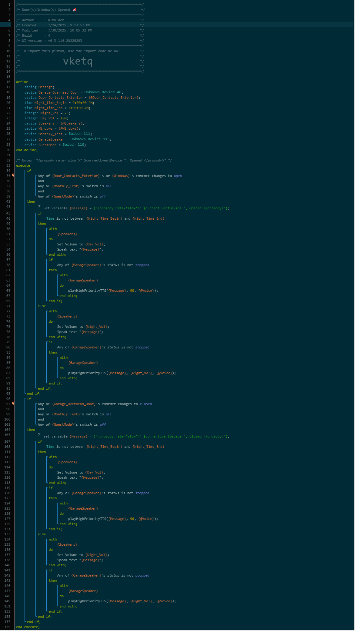

here is my webcore piston that i wanted to replicate:
