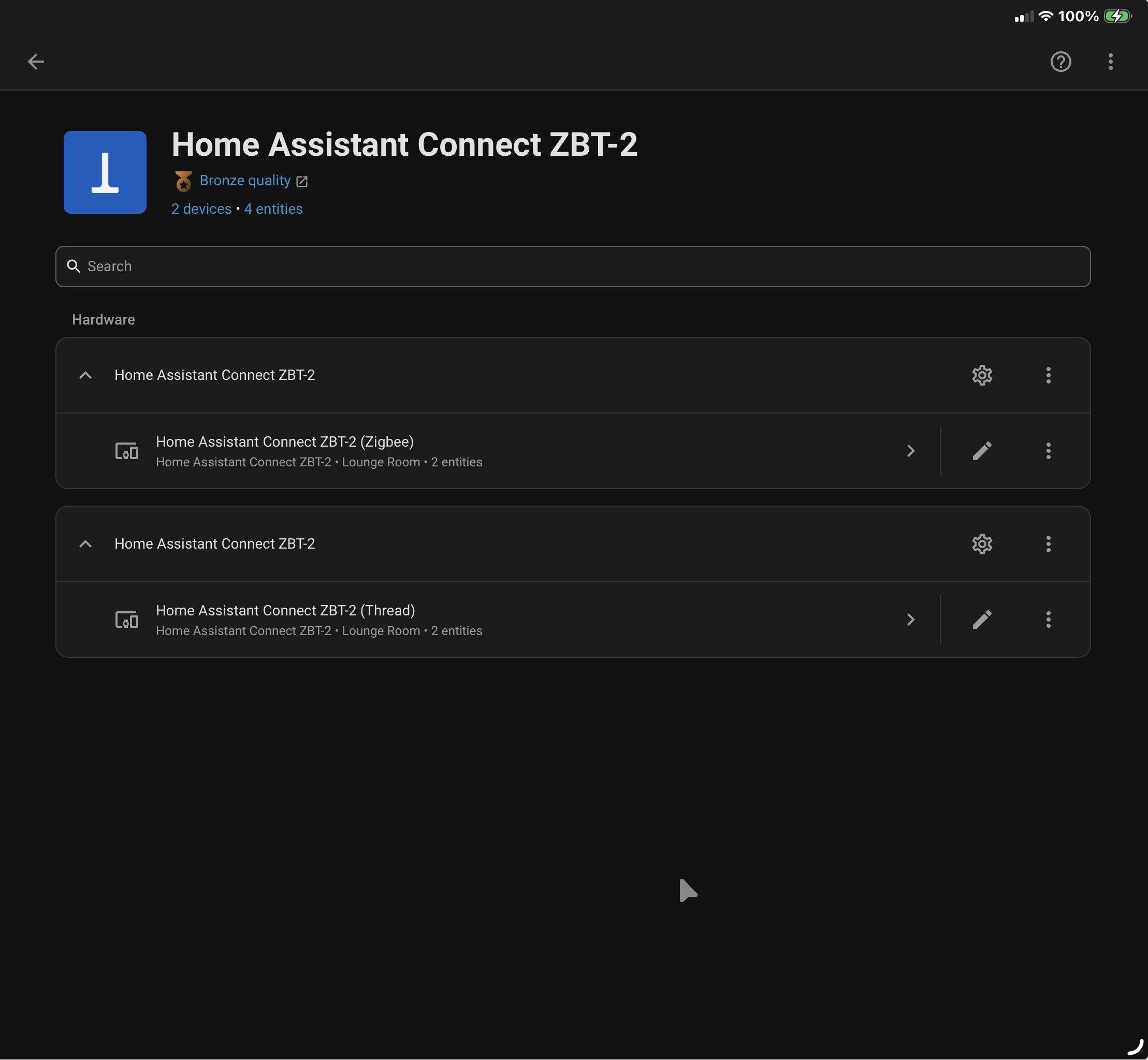

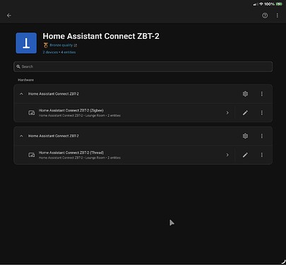

I’ve been running Zigbee devices through ZHA for sometime off an older Conbee USB dongle. I recently upgraded the Conbee to a ZBT-2 and migrated the Zigbee devices onto the ZHA network successfully.
To my surprise, and I’m not sure if it’s a miscommunication from Home Assistant, or something I missed, I found out that you need a second ZBT-2 for Matter/Thread. So my homelab setup now looks quite phallic…

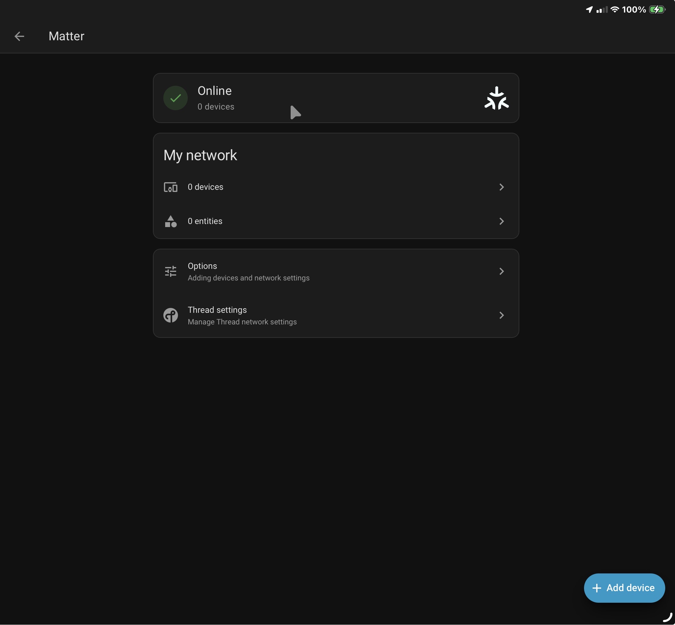

Anyway the intention behind connecting up Matter/Thread was to connect up my IKEA Alpstuga sensors, and I just can’t get it to connect.
To be honest, it’s quite frustrating - and probably the most difficult thing I’ve had to setup in Home Assistant.

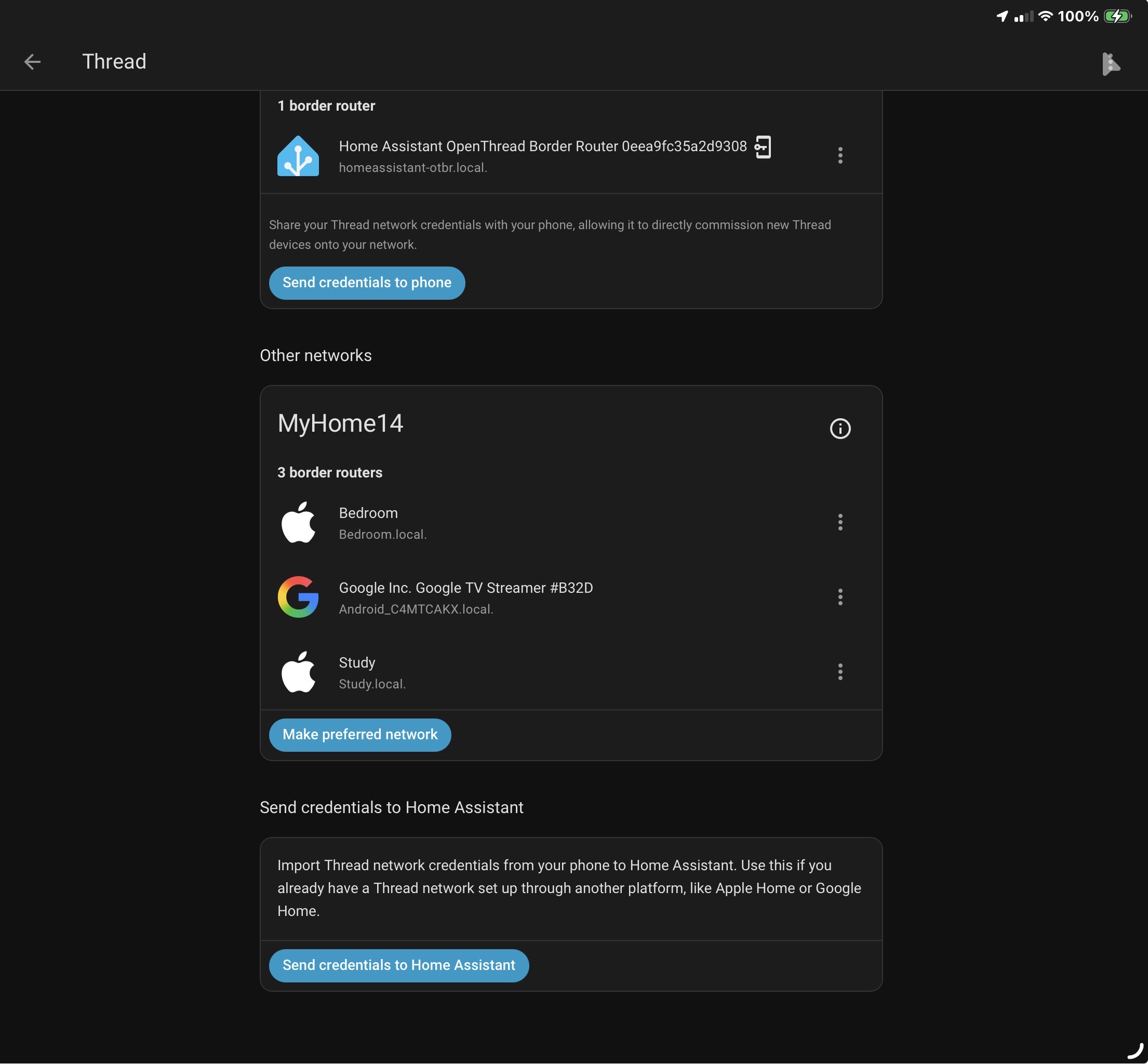

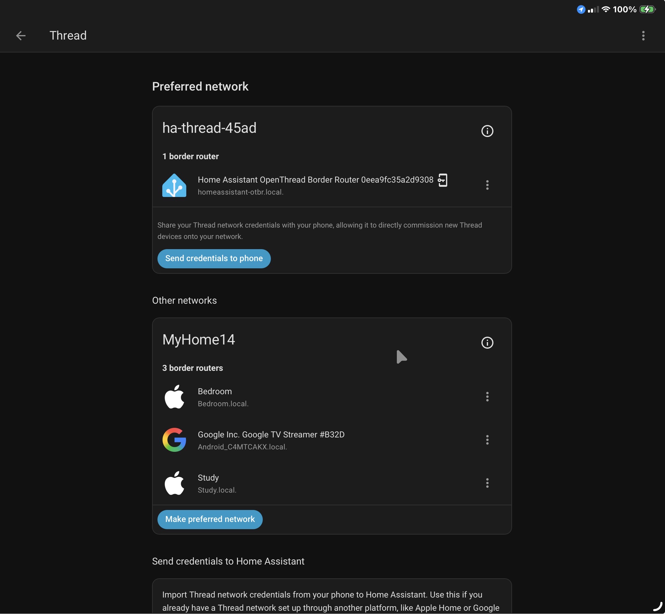

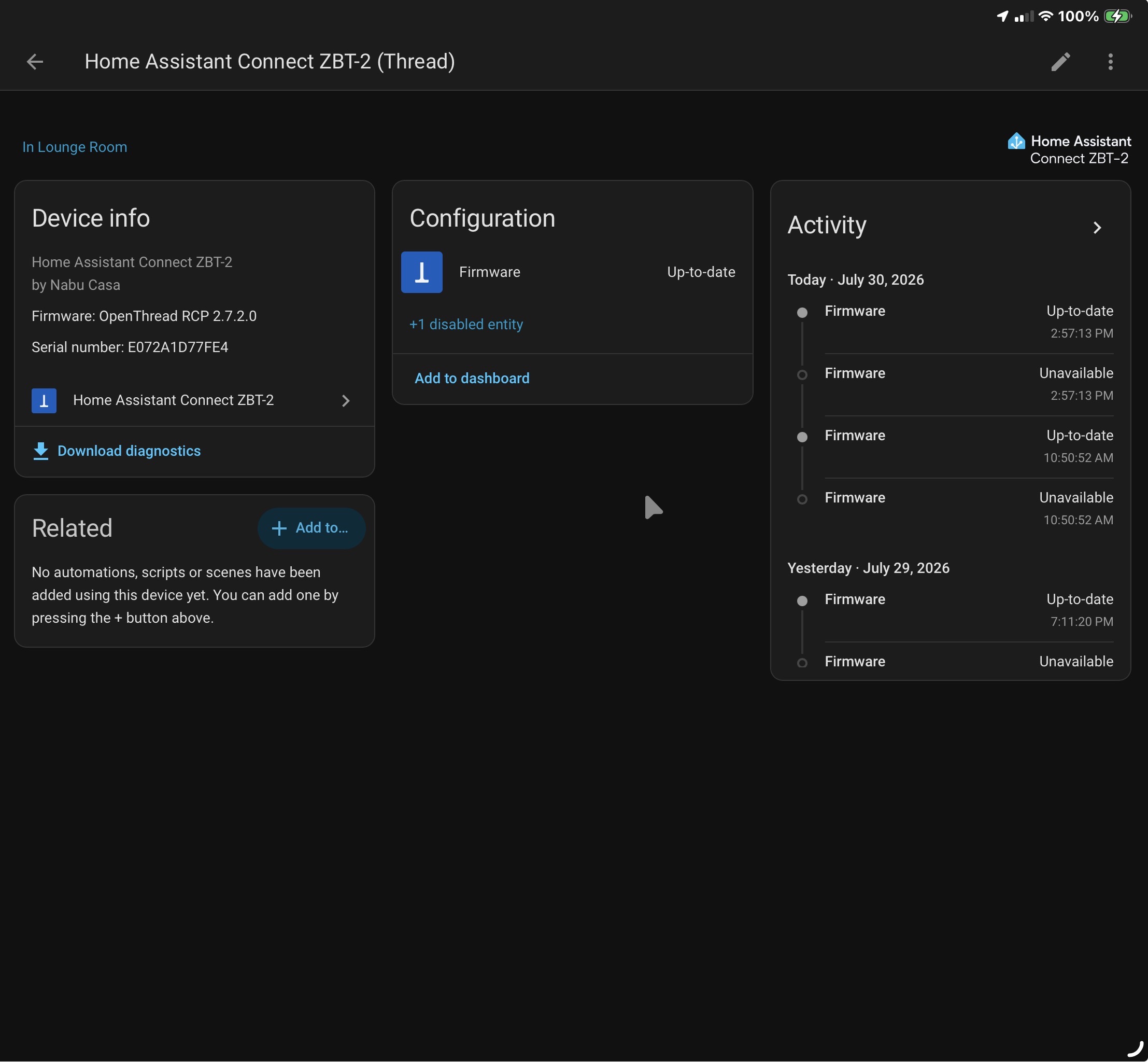

  • Under Thread, I’ve “send credentials to phone” and “send credentials to home assistant”
  • The preferred network (as below screenshots) seem to be correct

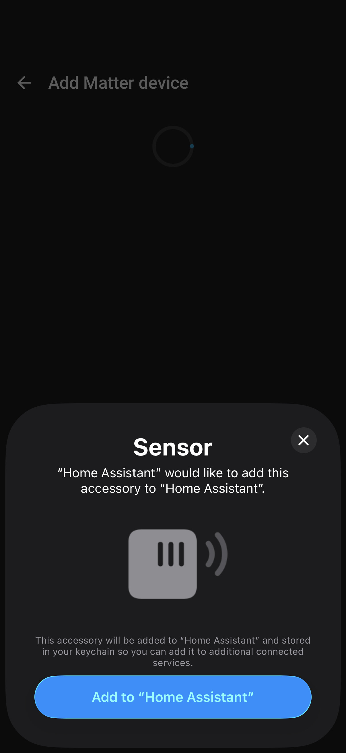

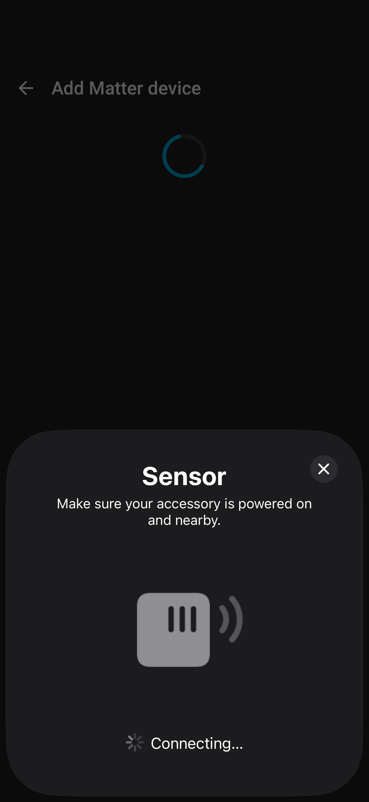

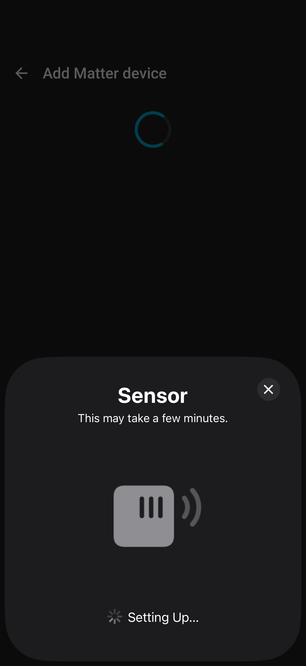

  • I’ve used my phone to add the device and scan the QR code
  • I’ve ensured that the IKEA Alpstuga is in pairing mode (flashing LED), I’ve tried resetting, power cycling, etc

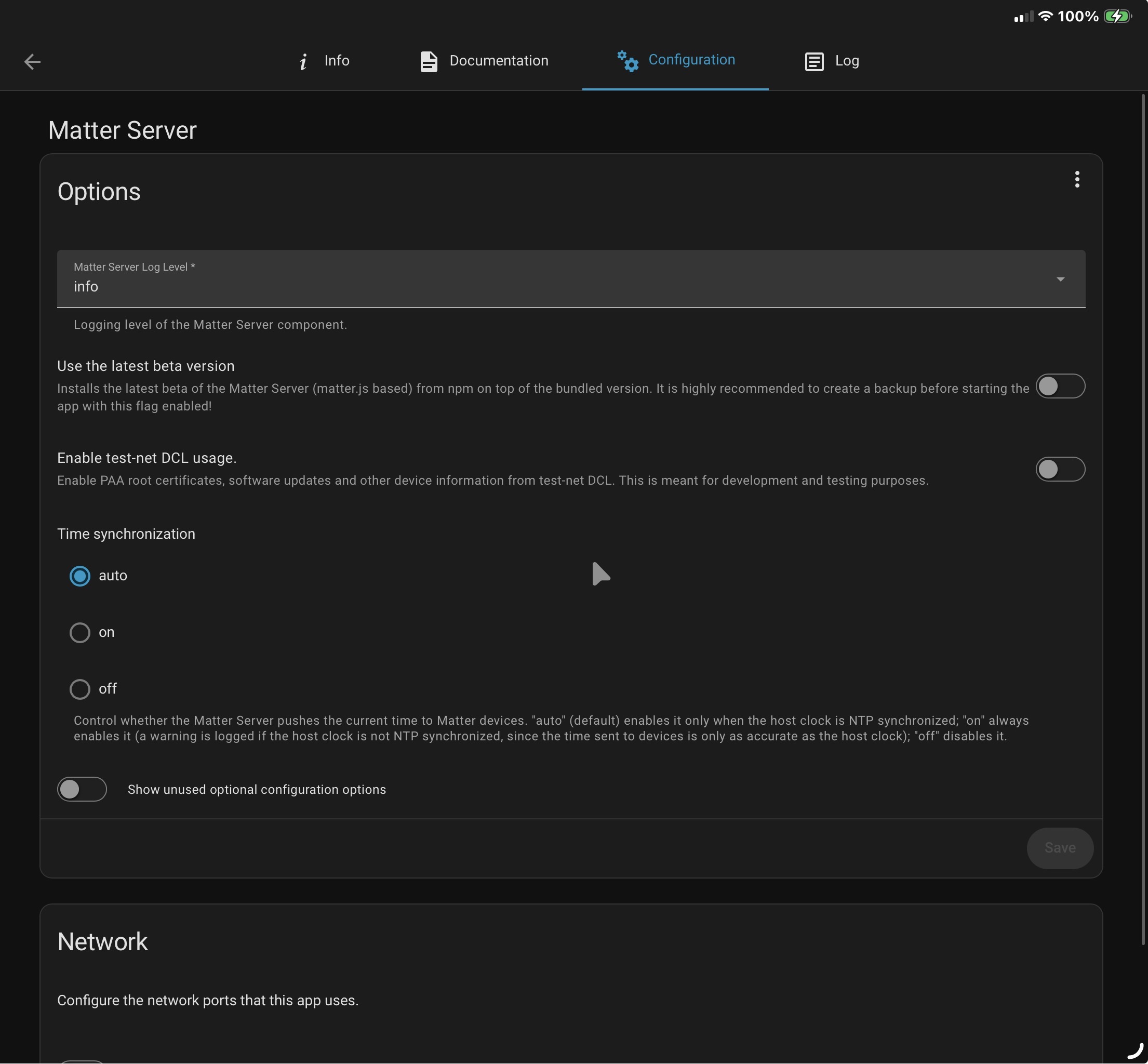

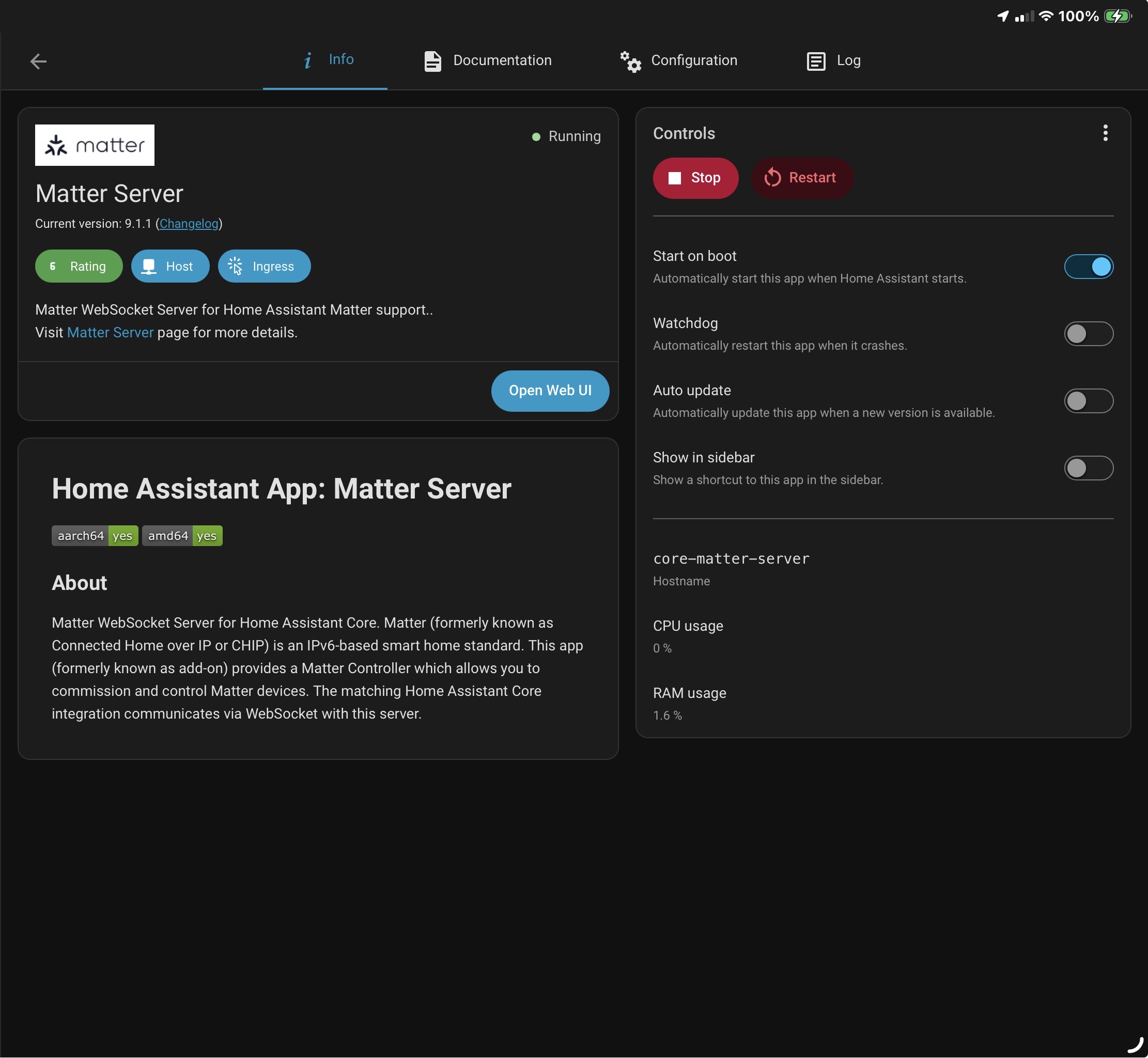

In terms of settings:

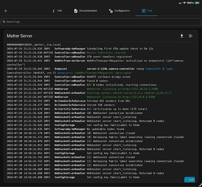

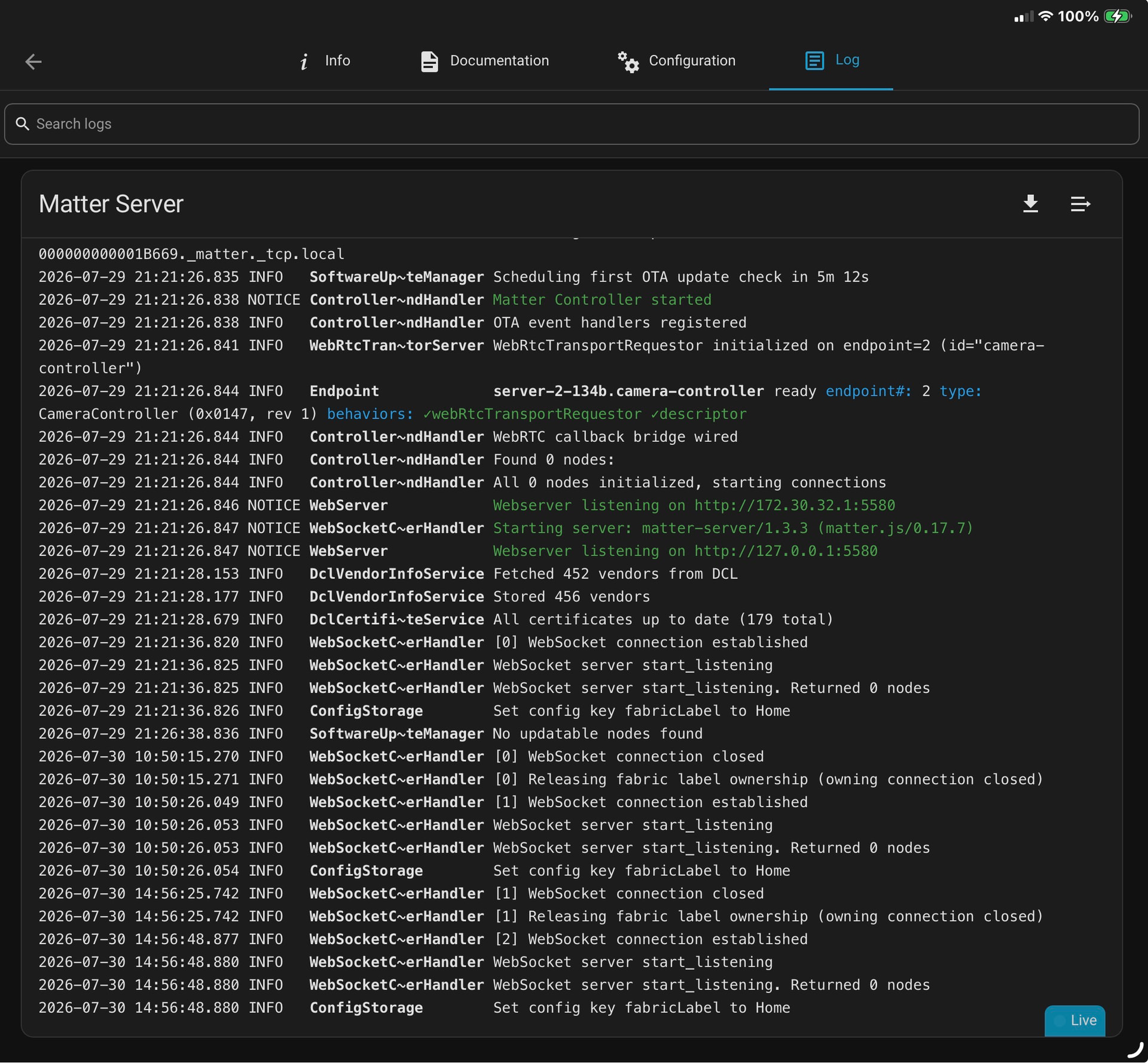

s6-rc: info: service matter-server successfully stopped
s6-rc: info: service banner: stopping
s6-rc: info: service banner successfully stopped
s6-rc: info: service s6rc-oneshot-runner: stopping
s6-rc: info: service s6rc-oneshot-runner successfully stopped
s6-rc: info: service s6rc-oneshot-runner: starting
s6-rc: info: service s6rc-oneshot-runner successfully started
s6-rc: info: service fix-attrs: starting
s6-rc: info: service banner: starting
s6-rc: info: service fix-attrs successfully started
s6-rc: info: service legacy-cont-init: starting
s6-rc: info: service legacy-cont-init successfully started
 Add-on: Matter Server
 Matter WebSocket Server for Home Assistant Matter support.
 Add-on version: 9.1.1
 You are running the latest version of this add-on.
 System: Home Assistant OS 18.1  (amd64 / generic-x86-64)
 Home Assistant Core: 2026.7.4
 Home Assistant Supervisor: 2026.07.3
 Please, share the above information when looking for help
 or support in, e.g., GitHub, forums or the Discord chat.
s6-rc: info: service banner successfully started
s6-rc: info: service matter-server: starting
s6-rc: info: service matter-server successfully started
[21:21:25] INFO: Starting Matter Server...
[21:21:25] INFO: Time sync 'auto': host NTP is synchronized, enabling time sync.
[21:21:25] INFO: Using 'eno1' as primary network interface.
[21:21:25] INFO: Successfully send discovery information to Home Assistant.
2026-07-29 21:21:26.634 INFO   MatterServer         Command line: --storage-path /data --port 5580 --log-level info --primary-interface eno1 --fabricid 2 --vendorid 4939 --listen-address 172.30.32.1 --listen-address 127.0.0.1 --enable-time-sync
2026-07-29 21:21:26.635 INFO   MatterServer         Using storage drivers: kv=wal, blob=dir
2026-07-29 21:21:26.638 INFO   ConfigStorage        Storage location: /data (Directory)
2026-07-29 21:21:26.648 INFO   ConfigStorage        Set config key fabricLabel to Home
2026-07-29 21:21:26.653 INFO   ConfigStorage        Set config key nextNodeId to 4
2026-07-29 21:21:26.656 INFO   ConfigStorage        Set config key wifiSsid to undefined
2026-07-29 21:21:26.660 INFO   ConfigStorage        Set config key wifiCredentials to <redacted>
2026-07-29 21:21:26.664 INFO   ConfigStorage        Set config key threadDataset to <redacted>
2026-07-29 21:21:26.669 INFO   ServerIdResolver     Found existing storage for server ID: server-2-134b
2026-07-29 21:21:26.682 INFO   DclCertifi~teService Initialize CertificateService prod: https://on.dcl.csa-iot.org test: https://on.test-net.dcl.csa-iot.org github: yes
2026-07-29 21:21:26.683 INFO   DclVendorInfoService Initialize VendorInfoService source: https://on.dcl.csa-iot.org interval: 24h
2026-07-29 21:21:26.683 INFO   Controller~ndHandler BLE is disabled
2026-07-29 21:21:26.683 INFO   Controller~ndHandler Time synchronization enabled
2026-07-29 21:21:26.684 NOTICE WebSocketC~erHandler Starting server: matter-server/1.3.3 (matter.js/0.17.7)
2026-07-29 21:21:26.714 INFO   DclCertifi~teService Loaded 179 certificates from storage
2026-07-29 21:21:26.729 INFO   DclCertifi~teService seed: consumed 0 PAA certs from snapshot 2026-07-17T03:06:21.169Z
2026-07-29 21:21:26.731 INFO   DclCertifi~teService seed: consumed 0 CDSigner certs from snapshot 2026-07-17T03:06:21.169Z
2026-07-29 21:21:26.737 INFO   DclVendorInfoService Loaded 455 vendors from storage
2026-07-29 21:21:26.738 INFO   DclVendorInfoService seed: skipping vendors — storage has 455 entries >= seed expectedCount 455
2026-07-29 21:21:26.738 INFO   DclVendorInfoService Fetching vendor information from DCL
2026-07-29 21:21:26.742 INFO   ServerNodeStore      Opened server-2-134b storage location: /data/server-2-134b driver: wal
2026-07-29 21:21:26.789 INFO   BaseEventStore       Loaded volatile event store with next number 4001
2026-07-29 21:21:26.792 INFO   Endpoint             server-2-134b ready endpoint#: 0 type: RootNode (0x16, rev 4) behaviors: 💤parts ✓index ✓accessControl ✓basicInformation ✓generalCommissioning ✓generalDiagnostics ✓administratorCommissioning ✓operationalCredentials ✓groupKeyManagement ✓commissioning ✓network 💤productDescription 💤subscriptions 💤sessions ✓events 💤controller ✓descriptor
2026-07-29 21:21:26.798 INFO   DclOtaUpdateService  Initialize OTAUpdateService prod: https://on.dcl.csa-iot.org test: https://on.test-net.dcl.csa-iot.org
2026-07-29 21:21:26.804 INFO   Endpoint             server-2-134b.ota-provider ready endpoint#: 1 type: OtaProvider (0x14, rev 1) behaviors: ✓otaSoftwareUpdateProvider ✓descriptor ✓softwareupdates
2026-07-29 21:21:26.804 INFO   CertificateAuthority Loaded stored credentials with ID 0
2026-07-29 21:21:26.809 NOTICE FabricAuthority      Rotated NOC for fabric 1
2026-07-29 21:21:26.817 WARN   Commission~ontroller BLE is not enabled on this platform
2026-07-29 21:21:26.818 NOTICE Node                 server-2-134b going online
2026-07-29 21:21:26.819 INFO   ServerNetworkRuntime TCP transport enabled (incoming=true, outgoing=true)
2026-07-29 21:21:26.824 INFO   NetworkProfiles      Configure profile fast exchanges: 200 additionalMrpDelay: 0
2026-07-29 21:21:26.824 NOTICE Node                 server-2-134b is online
2026-07-29 21:21:26.824 INFO   FabricAccessControl  ACL List updated privilege: 5 authMode: 2 subjects: 112233 targets: null fabricIndex: 1 privilege: 3 authMode: 2 subjects:  targets: { cluster: 41, endpoint: 1, deviceType: null } fabricIndex: 1 privilege: 3 authMode: 2 subjects:  targets: { cluster: 1364, endpoint: 2, deviceType: null } fabricIndex: 1
2026-07-29 21:21:26.834 INFO   MdnsAdvertisement    Publishing kind: operational service: mdns:FD0E412FDE70AE6B-000000000001B669._matter._tcp.local
2026-07-29 21:21:26.835 INFO   SoftwareUp~teManager Scheduling first OTA update check in 5m 12s
2026-07-29 21:21:26.838 NOTICE Controller~ndHandler Matter Controller started
2026-07-29 21:21:26.838 INFO   Controller~ndHandler OTA event handlers registered
2026-07-29 21:21:26.841 INFO   WebRtcTran~torServer WebRtcTransportRequestor initialized on endpoint=2 (id="camera-controller")
2026-07-29 21:21:26.844 INFO   Endpoint             server-2-134b.camera-controller ready endpoint#: 2 type: CameraController (0x0147, rev 1) behaviors: ✓webRtcTransportRequestor ✓descriptor
2026-07-29 21:21:26.844 INFO   Controller~ndHandler WebRTC callback bridge wired
2026-07-29 21:21:26.844 INFO   Controller~ndHandler Found 0 nodes:
2026-07-29 21:21:26.844 INFO   Controller~ndHandler All 0 nodes initialized, starting connections
2026-07-29 21:21:26.846 NOTICE WebServer            Webserver listening on http://172.30.32.1:5580
2026-07-29 21:21:26.847 NOTICE WebSocketC~erHandler Starting server: matter-server/1.3.3 (matter.js/0.17.7)
2026-07-29 21:21:26.847 NOTICE WebServer            Webserver listening on http://127.0.0.1:5580
2026-07-29 21:21:28.153 INFO   DclVendorInfoService Fetched 452 vendors from DCL
2026-07-29 21:21:28.177 INFO   DclVendorInfoService Stored 456 vendors
2026-07-29 21:21:28.679 INFO   DclCertifi~teService All certificates up to date (179 total)
2026-07-29 21:21:36.820 INFO   WebSocketC~erHandler [0] WebSocket connection established
2026-07-29 21:21:36.825 INFO   WebSocketC~erHandler WebSocket server start_listening
2026-07-29 21:21:36.825 INFO   WebSocketC~erHandler WebSocket server start_listening. Returned 0 nodes
2026-07-29 21:21:36.826 INFO   ConfigStorage        Set config key fabricLabel to Home
2026-07-29 21:26:38.836 INFO   SoftwareUp~teManager No updatable nodes found
2026-07-30 10:50:15.270 INFO   WebSocketC~erHandler [0] WebSocket connection closed
2026-07-30 10:50:15.271 INFO   WebSocketC~erHandler [0] Releasing fabric label ownership (owning connection closed)
2026-07-30 10:50:26.049 INFO   WebSocketC~erHandler [1] WebSocket connection established
2026-07-30 10:50:26.053 INFO   WebSocketC~erHandler WebSocket server start_listening
2026-07-30 10:50:26.053 INFO   WebSocketC~erHandler WebSocket server start_listening. Returned 0 nodes
2026-07-30 10:50:26.054 INFO   ConfigStorage        Set config key fabricLabel to Home
2026-07-30 14:56:25.742 INFO   WebSocketC~erHandler [1] WebSocket connection closed
2026-07-30 14:56:25.742 INFO   WebSocketC~erHandler [1] Releasing fabric label ownership (owning connection closed)
2026-07-30 14:56:48.877 INFO   WebSocketC~erHandler [2] WebSocket connection established
2026-07-30 14:56:48.880 INFO   WebSocketC~erHandler WebSocket server start_listening
2026-07-30 14:56:48.880 INFO   WebSocketC~erHandler WebSocket server start_listening. Returned 0 nodes
2026-07-30 14:56:48.880 INFO   ConfigStorage        Set config key fabricLabel to Home
