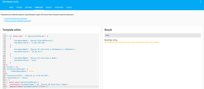

I want to get the parameter value for a specific parameter name, for example get the eth1 response from parameter name Device.IP.Interface.1.Name. So far I can achieve this using below value template.
value_template: “{{ value_json.operationalParams[2].parameterValue }}”
However, the challenge I am facing is that the response is quite long and the numbering keeps chaging, so one moment is object number 2 then is object number 5 etc. So instead I want to parse using the specific name which is always static. I tried playing around with the formating of my template to include parameter name but to no luck so far.
Could someone please help advise how can I list a specific parameter within a specific json object
Use selectattr (ref). For example using bracket notation rather than dot notation, because it’s objectively better, and with line breaks only for readability:
{{ value_json['operationalParams']
   |selectattr('parameterName','eq','Device.IP.Interface.1.Name')
   |map(attribute='parameterValue')
   |first }}
selectattr pulls the list item(s) that match the test; map with attribute then pulls all the named attributes out into a list. first just gets the first (and here, only) item from that list.
In future, please post code using the </> button to ensure it’s properly formatted.
Thanks so much about this and making it work…spent a lot of time time trying to make it work as I am not familiar with json and conding in general. Appreciate it!
