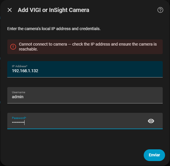

starting now on HA and trying to use this in order to integrate my VIGI C340 an C240 cameras.
When I try to add camera get connection error despite it's working.
What can I do to get them working?
Thank you.
Suddenly it works.
Is missing to update the firmware to version above 2.1.x to get the OpenAPI feature.
Thank you for your work.
