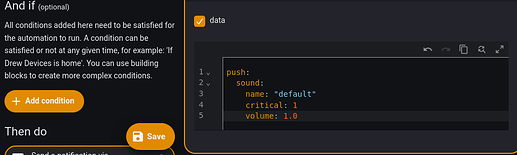

For mobile app notifications with extended data, you do need to use the old notify action, but you can do it in the UI. Though, for critical notifications you do have to use YAML structure for the value in the UI field:
Thank you! Will update to this syntax! Worked perfect. Changed a water sensor state to on, in the Developer tools (tools) section and validated notification. Thanks again!
