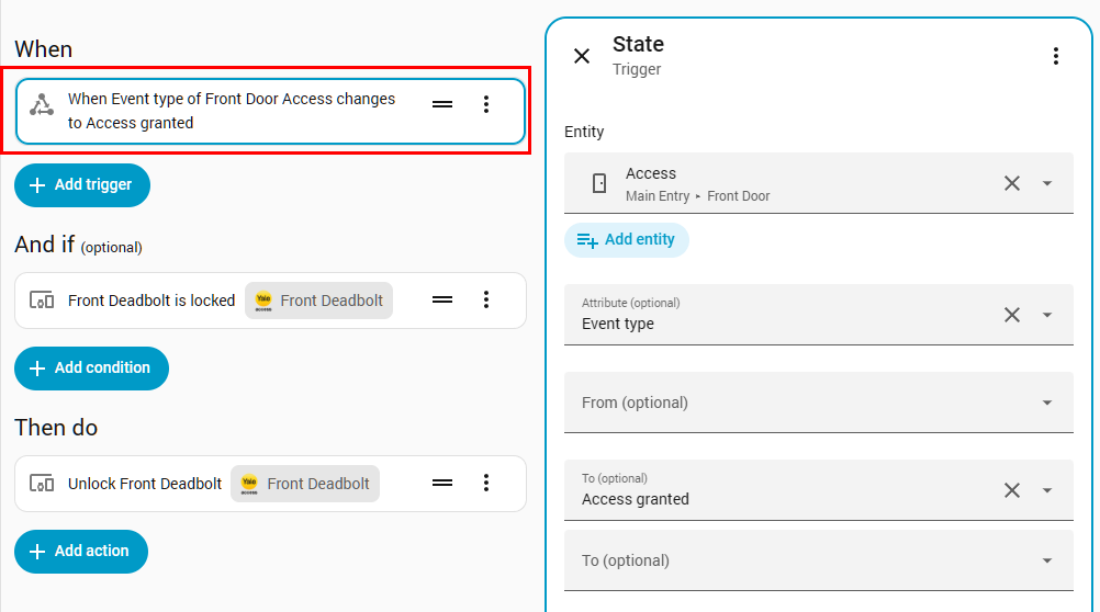

I had THOUGHT this was correct after looking at the blueprint, but the automation never triggers:
trigger: state
entity_id:
  - event.front_door_access
attribute: event_type
to:
  - access_granted
Curious if I’m missing something in the trigger setup or if anyone has any idea how to trigger an event using the visual editor UI when a UniFi door hub unlock is detected?

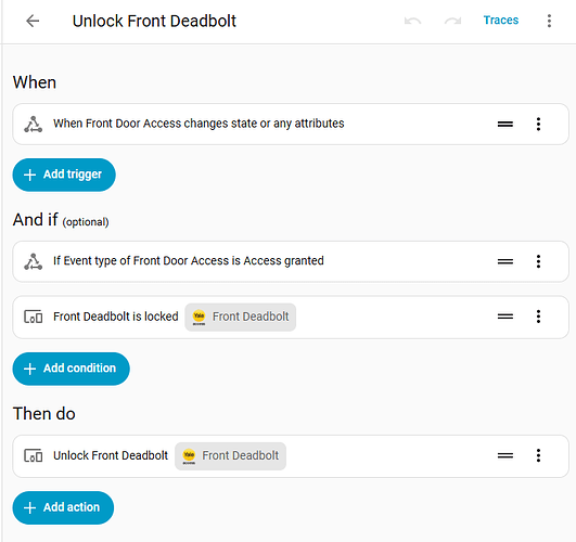

Well I answered my own question after inspecting the trace on the automation configured from the blueprint – should have realized the config was available right in the trace window.
This is now working with the STATE configured as a condition of the event, which makes sense. I had incorrectly assumed that the state would be parsed as a part of the actual event as the UI made it appear, but that was not quite right. Oddly, it worked that way for a while but then suddenly stopped so I’m not sure why, but its back now with this new config. Here’s the correct format that is now working for me for our UniFi Access system to unlock our Yale (August) deadbolt:
Recently connected the deadbolts via Bluetooth so our system would work even if the Internet was down, and they typically unlock within 1 second of the UniFi system approving an authorization at a keypad. Works pretty well to authenticate face ID, QR codes, RFID, and Touch Pass into really any lock type supported by HA.
Thanks again for the devs who have been working on this integration release!
Thank you so much for this. It solved my issue since I was struggling with the same automation. I tried the state but I was complicating it by assigning it an attribute of "event type" changing to "access granted" in the condition section which was not working. Leaving it completely blank for state change of any state or attribute is the way to go and then assigning it "and if" condition to assure the state is in fact "Access granted" and not an error state!
