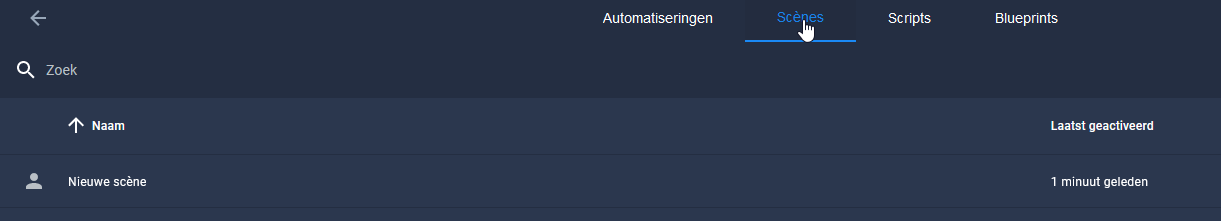

My script/automation/scene or blueprints i create is not showing in the UI.
If i look into the yaml file i see the create script/automation
This is just 1 example of a yaml file but i try script/automation/scene

Look at HA UI >> [hamburger icon] >> settings >> Automations &Scenes
Here you will see tabs for automations, scenes, and blueprints
Automations are in automations
Blueprints are in blueprints
Scenes in scenes
Look here first
nope i already checked that
the automation did not work 2.
I activate the motion sensor but the ligh does not go on.
The name’s that are inside ar automatic inserted when i add my Zigbee
Its there as β€œMotion-activated Light”
