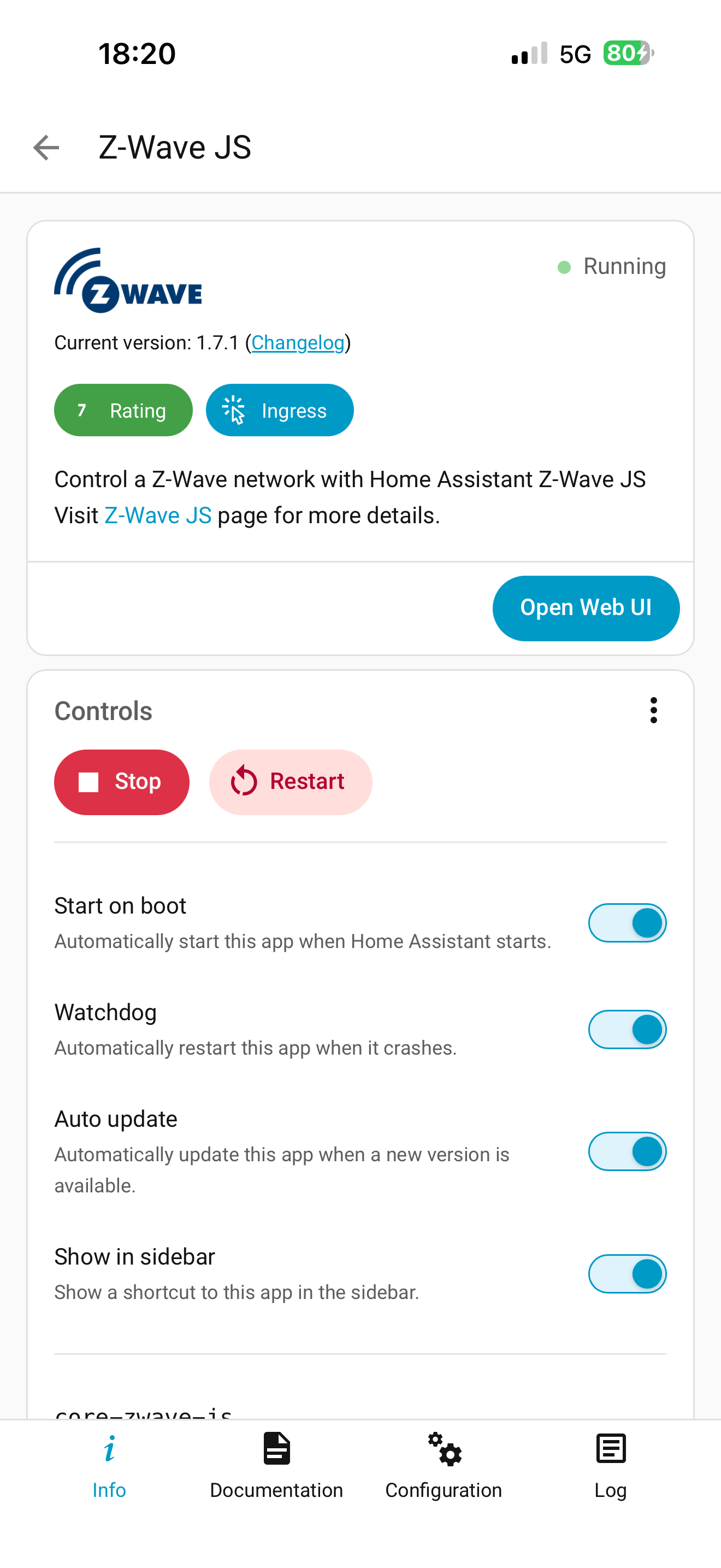

Yup that’s the issue- not a clue what I’m running. Everything so similarly named is confusing for a new user:
I included all devices via Z Wave JS UI (badged at the bottom of the screen Daniel Lando) That is added to my sidebar.
In Settings > Apps I see Z Wave JS is running.
In Devices and Services, under configured I see Z Wave.
Ok your top Pic is a generic control space for an HA app. (formerly an Addon) which tells us you’re running as an App/addon (my you can bounce HA without affecting ZWave is true for you yay) your bottom Pic is the actual ZWaveJS interface also formerly known as ZWaveJSUI.. (there used to be two packages one without the UI.)
