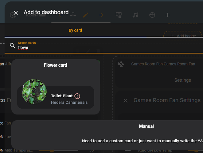

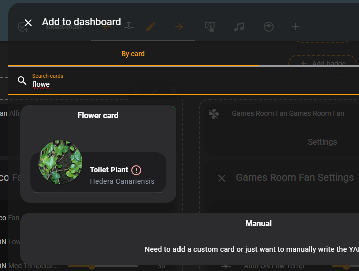

I’ve only been trying it in the UI. When I search for Flower, nothing shows. Hmmm. I just re installed it for fun and now I see it in HACS. At least it stays there but there is not Flower Card folder in the community folder. So that’s weird.
I’ll try adding the card manually.
I’m guessing you did refresh your browser cache as HA reminds you to
Yes I did.
Strangely enough. Adding it manually worked.
I still don’t see it in my HACS or in the card selection when in UI mode.
Still no Flower-Card folder in the community folder.
But it works so I’m happy.
Thanks for pushing me to try it manually.
Well theres definitely something strange going on with your config because it should show up in the UI.
Notice that it is called “lovelace-flower-card” in the community-folder.
Well this morning it’s everywhere to be seen! In the community folder and in the search UI section. All is good. Thanks Olen for putting this nice little card together.

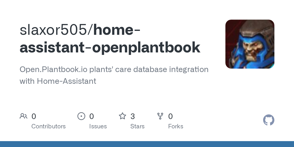

Hi All,
For the benefit of the integration users and just to avoid to confusion, since mine and Olen's views on HASS Open Plantbook Integration are quite different (please excuse me @Olen and don't be offended, I respect your foundational work), I've decided to create my own version (fork) of the integration (OPB integration) which is available at:
I called that "Founder Edition" and it includes a couple of extra features. The goal of this fork is to stay aligned with Open Plantbook features, keep things simple and user-friendly, and remain compatible with Home Assistant, including this custom plant integration.
At this stage, my version has one feature which I believe can be useful for not very experienced HASS users:
Sensor monitoring warnings — Stale or missing sensor updates are flagged during upload runs; details and optional notifications in :bell: Sensors Monitoring.
The latest updates in details can be found here.

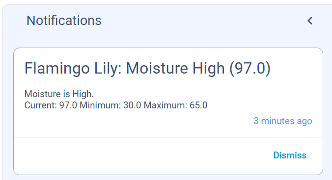

@olen Here is my latest automation utilizing the new problems: attribute list. Sharing in case others find it useful.
'Plant Notifications' (click to expand automation YAML)
alias: Plant Notifications
description: ""
triggers:
  - trigger: state
    entity_id:
      - plant.madagascar_dragon_tree
      - plant.philodendron_imperial_green
      - plant.bombay_orchid
      - plant.flamingo_lily
      - plant.golden_barrel_cactus
      - plant.moon_cactus
      - plant.peruvian_old_man_cactus
      - plant.san_pedro_cactus
      - plant.zebra_haworthia_attenuata
      - plant.zebra_haworthia_fasciata
    attribute: problems
conditions: []
actions:
  - variables:
      labels:
        moisture: Moisture
        temperature: Temperature
        conductivity: Soil conductivity
        illuminance: Illuminance
        humidity: Humidity
        co2: CO₂
        soil_temperature: Soil temperature
        dli: Daily light integral
        vpd: Vapor pressure deficit
      old_problems: "{{ trigger.from_state.attributes.get('problems', []) }}"
      new_problems: "{{ trigger.to_state.attributes.get('problems', []) }}"
      old_problem_keys: |
        {{ old_problems
          | map(attribute='sensor_type')
          | list }}
      new_problem_keys: |
        {{ new_problems
          | list }}
      cleared_types: |
        {{ old_problem_keys | reject('in', new_problem_keys) | list }}
  - repeat:
      for_each: "{{ new_problems }}"
      sequence:
        - variables:
            problem: "{{ repeat.item }}"
            sensor_type: "{{ problem.sensor_type }}"
            label: "{{ labels.get(sensor_type, sensor_type) }}"
            notification_id: "{{ trigger.to_state.entity_id ~ '_' ~ sensor_type }}"
            problem_key: "{{ sensor_type ~ ':' ~ problem.status }}"
            old_matching_problem: |
              {{ old_problems
                | selectattr('sensor_type', 'eq', sensor_type)
                | list
                | first
                | default(none) }}
            old_problem_key: |
              {% if old_matching_problem is not none %}
                {{ old_matching_problem.sensor_type ~ ':' ~ old_matching_problem.status }}
              {% else %}
                {{ none }}
              {% endif %}
        - action: persistent_notification.create
            notification_id: "{{ notification_id }}"
            title: >-
              {{ trigger.to_state.attributes.friendly_name }}: {{ label }} {{ problem.status }}
              ({{ problem.current }})
            message: >
              {{ label }} is {{ problem.status }}.
              Current: {{ problem.current }} Minimum: {{ problem.min }} Maximum:
              {{ problem.max }}
        - if:
            - condition: template
              value_template: "{{ problem_key != old_problem_key }}"
          then:
            - action: notify.mobile_app_my_phone
                title: >-
                  problem.status }} ({{ problem.current }})
                message: >
                  Current: {{ problem.current }} Range: {{ problem.min }} – {{
                  problem.max }}
  - repeat:
      for_each: "{{ cleared_types }}"
      sequence:
        - action: persistent_notification.dismiss
            notification_id: "{{ trigger.to_state.entity_id ~ '_' ~ repeat.item }}"
mode: queued
species: Anthurium andraeanum
moisture_status: High
temperature_status: ok
conductivity_status: ok
illuminance_status: null
humidity_status: ok
co2_status: null
soil_temperature_status: null
dli_status: ok
vpd_status: null
species_original: anthurium andraeanum
problems:
  - sensor_type: moisture
    status: High
    current: "97.0"
    min: "30.0"
    max: "65.0"
device_class: plant
entity_picture: https://opb-img.plantbook.io/anthurium%20andraeanum.jpg
icon: mdi:flower
friendly_name: Flamingo Lily
