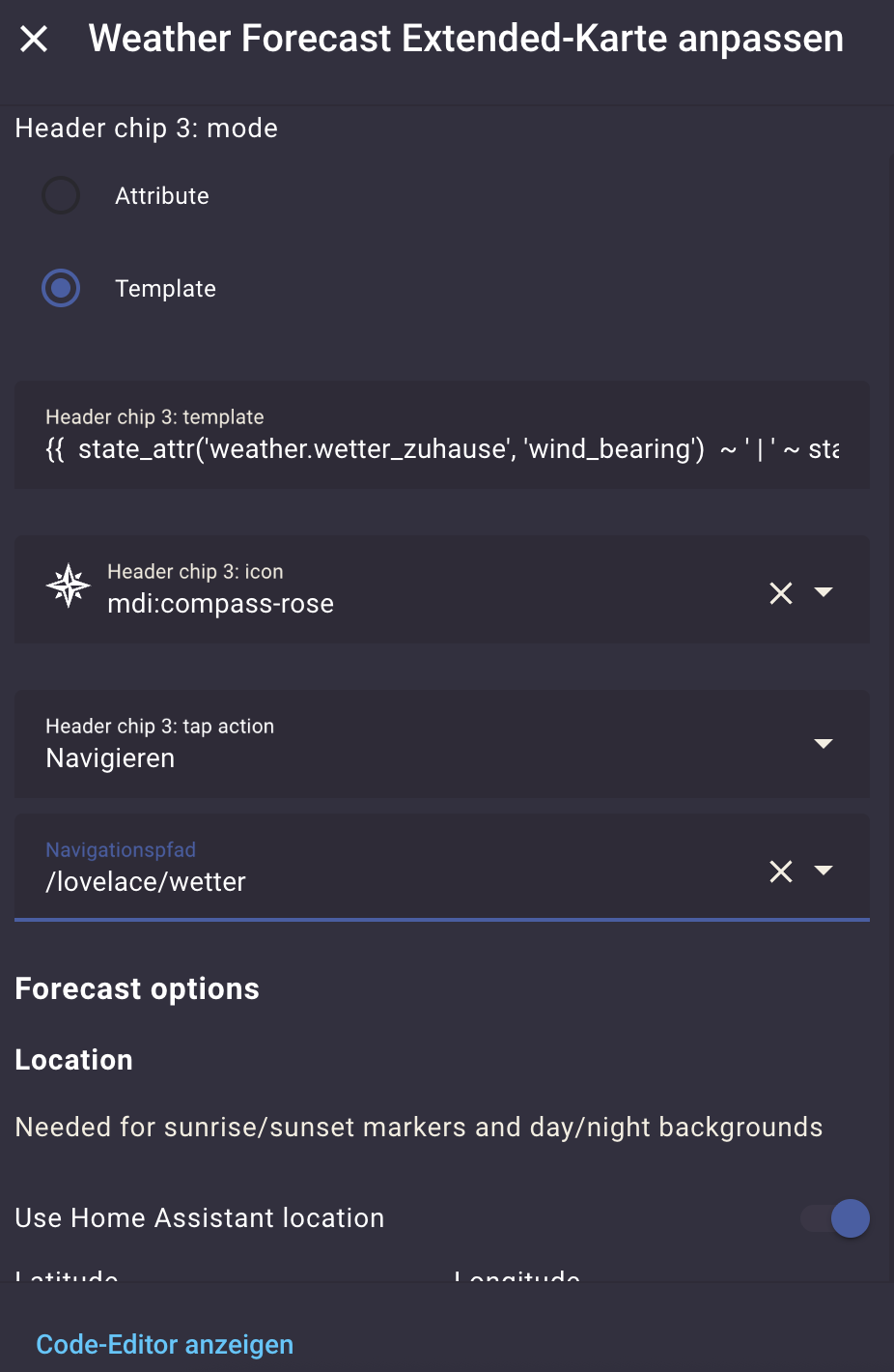

So you use humidity in the header as info-‘chip’?
You can switch the chip mode to template in this case, to display your NWS humidity value, while still using the meteo weather entity for the forecast.
I use this for example to show the humidity of my own outdoor sensor:
Humidity: {{ states('sensor.multisensor_zufahrt_humidity') | round(0) }}%
To use the attribute from a weather service it should look like this I guess:
Humidity: {{ state_attr('weather.wetter_zuhause', 'humidity') }}%
I’m pretty sure I know what your telling me to do, but to this point I’ve only been making changes via the GUI. Which file should I edit to make those changes? I’m running HAOS on a laptop if that helps.
Ah, well. The learning curve on HA can be quite overwhelming. :wink:
A template allows you to replace the code within a text.
It uses Jinja as syntax and the general docs can be found here.
You will also find the state_attr function used in my example there.
In the weather cards UI editor, there’s an option for each of the three chips to use an attribute or a template.
This is where you can paste it.
I guess humidity is a standardized attribute name for HA weather entities (if they support it).
So replacing the entity id (weather.wetter_zuhause) should be all needed.

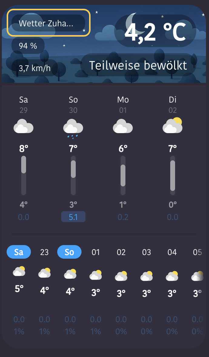

Tiny update (version 0.5.2):
There have been a few reports and Github issues about line-breaks in the header causing visual glitches on narrow screens (horizontal oreientation of mobile devices).
I changed the header column with temp and condition to keep their natural width instead of breaking.
The column for the chips now take the rest and truncate their text in case of not enough space instead of adding line-breaks as well:
See text marked yellow in the screenshot:

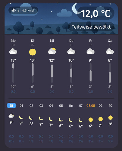

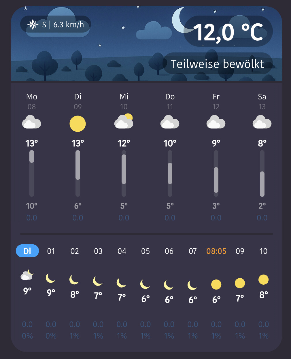

A little update that I already released yesterday:
  • Card uses now partly-cloudy images with a moon at night, also for weather integrations that don’t report “night-time” explicitly (You have to set the weather lat/long location in the card in this case, so it can calculate sunrise/sunset times).
  • You can set a different spacing in pixels for the daily and hourly weather in case you don’t like the default (was requested a few times on Github).
Should show up as version 0.6.0

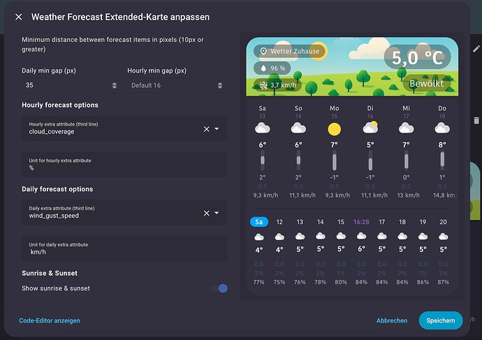

Version 0.8.1 allows you to add a custom weather attribute row to the daily and hourly forecast:
This example adds cloud coverage to the hourly forecast with “%” as unit string
and daily max wind speed with " km/h" as unit string for the daily forecast.
Daily forecast also got a custom (35px) item spacing in this example to avoid overlapping of these long wind speed strings.
