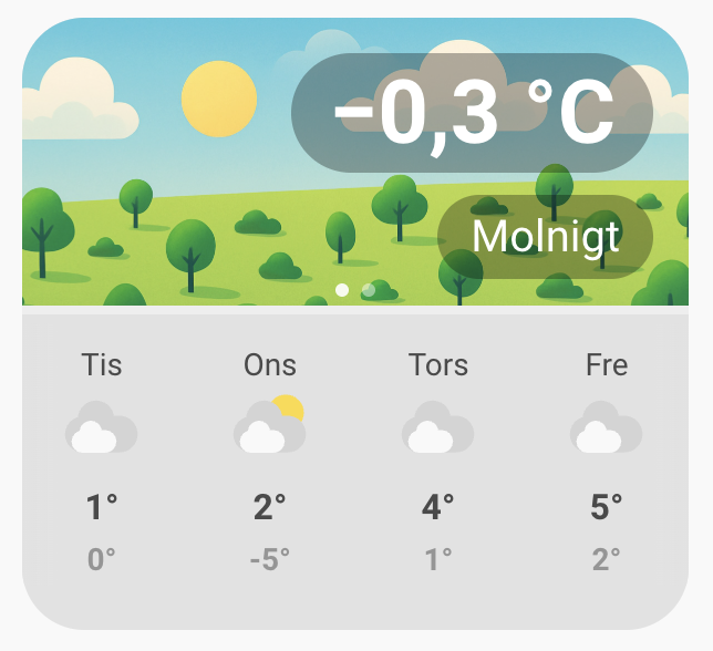

New weather card - Weather-Forecast-Extended
Sorry for not replying the last week.
Was sick and I’m also out for holidays in a week.
So will take some time until the next fixes / new features.
But seasonal images are already on the todo list and there’s also a Github issue about it.
ChatGPT is sadly still not able to build a whole new set of the same conditions in one request and also not in the needed resolution / aspect ratio.
So this is quite some donkey work, where I need some spare time and motivation for. :face_with_peeking_eye::upside_down_face:
Custom images have also been requested before and there’s also an open Github issue.
I liked the idea there, to use an image entity instead of a fixed condition → image mapping.
That way, even more complex ideas would be possible.
Like handing the current condition and your outdoor camera picture to an AI task and generate a comic style weather scene from it.

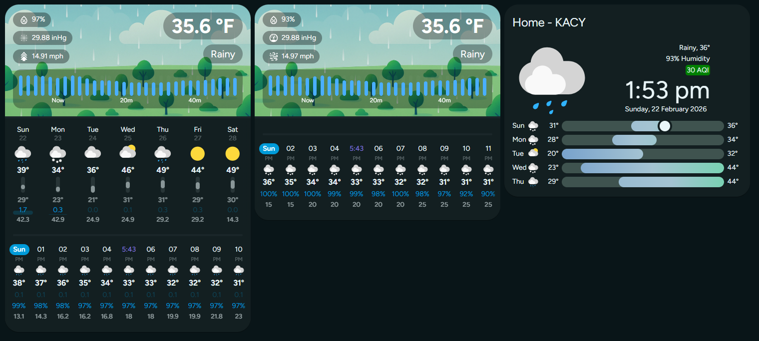

Hi All - I have been using the card on one of my Dashboards. I like it, but ran into an issue. I have not officially reported it, but think I figured out the problem… My primary weather source is NWS (Nation Weather Service). The location I look at is local to my house at ACY airport. THat NOAA/NWS location has Twice Daily and Hourly available. Due to the Twice Daily rather than Daily, the card will not display the daily forecast. See the clips below and I will post this as a feature request. First Shot is using Google Weather as the source and second is NWS. Third shot is using NWS with the Clock Weather Card.
Do you know how the Clock Weather Card handles this?
Are the daily and the nightly forecast displayed as a combined item for the whole day?
Currently thinking about how this coiuld be implemented the best way.
As the daily forecast uses the bars for min/max temperature, seperated day and night items might not make that much sense.
So combining them might be a good way.
Just not sure how that should be done.
A few thoughts:
  • Weather condition / icon of the day
  • Summed rain ammount
  • How to calculate the chance of rain (larger value?)
  • Custom attributes might be an even larger problem
Any feedback is welcome. :wink:

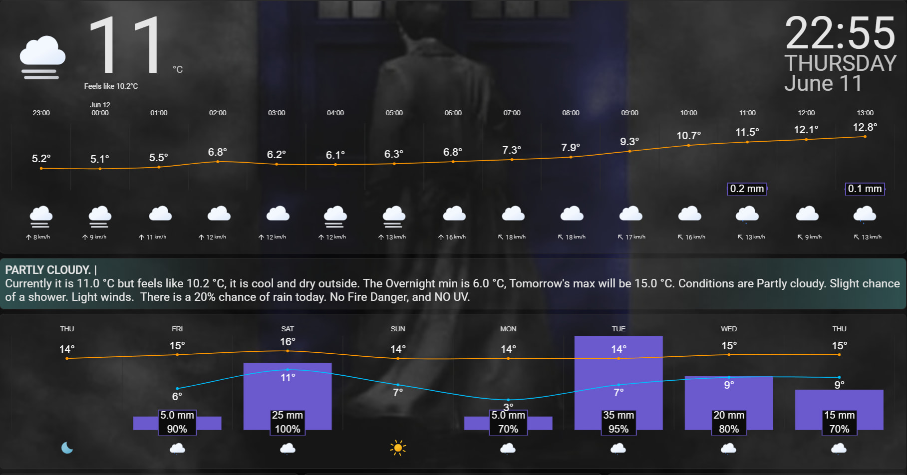

  • Missing a clock and calendar.
  • I like your temperature bars.
  • Precipitation bars could use some work.
The current card I use Weather Chart Card

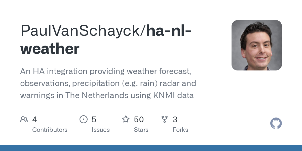

I'm using the NLweather intergration to fetch the KNMI weather and forecasts.
The latest release now also can do the rain forecast graphs using nowcast whcih should be easily displayed using the card. However I can't seem to get it to work and in the forum here it is not mentioned at all.
Relevant link to the docs of NLweather nowcast section:
Anybody any hints/tips?

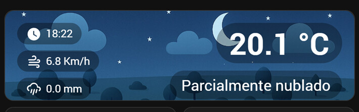

Hi all.
This is a great card, love this. Please can you help with me the header font size? Despite setting it up with Card-mod, it doesn't work. I am looking for a way to make the main temperature and description smaller:
type: custom:weather-forecast-extended-card
name: Previsão Indaiatuba
show_current: false
show_forecast: false
show_attributes: true
forecast_days: 5
icons: true
orientation: vertical
nowcast_layout: pager
nowcast_always_show: false
show_header: true
hourly_forecast: false
daily_forecast: false
header_chips:
  • type: template
    template: "{{ now().strftime('%H:%M') }}"
    icon: mdi:clock
  • type: template
    template: "{{ states('sensor.gw2000b_wind_speed') }} Km/h"
    icon: mdi:weather-windy
  • type: template
    template: "{{ states('sensor.gw2000b_rain_rate_piezo') }} mm"
    icon: mdi:weather-pouring
    header_attributes:
    grid_options:
    columns: 12
    rows: 2
    solar_forecast_entries:
    use_night_header_backgrounds: true
    entity: sensor.clima_traduzido
    header_temperature_entity: sensor.gw2000b_outdoor_temperature
    nowcast_entity: weather.forecast_home
    card_mod:
    style:
    .ha-card {
    font-size: 8px;
I appreciate any inputs. Thanks in advance.
