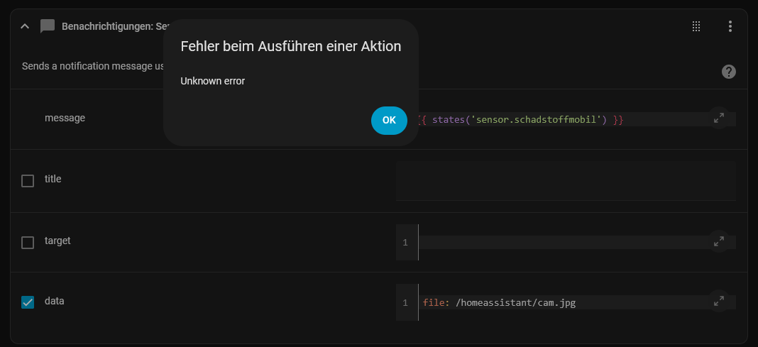

I still get “Unknown error” when I define a file path as data:
Can you help me further.
Thanks in advance!

/local/ is how the access the www folder when accessing a file via the web.
Inside the docker container running Home Assistant the file path is actually /config/www/
So try /config/www/ALL.jpg Though be aware that things are case sensitive so the file must be called ALL.jpg if it is actually called all.jpg and you are trying to access it as ALL.jpg it won’t be found.
Thanks, it works now. This is the syntax for anyone else needing it.
