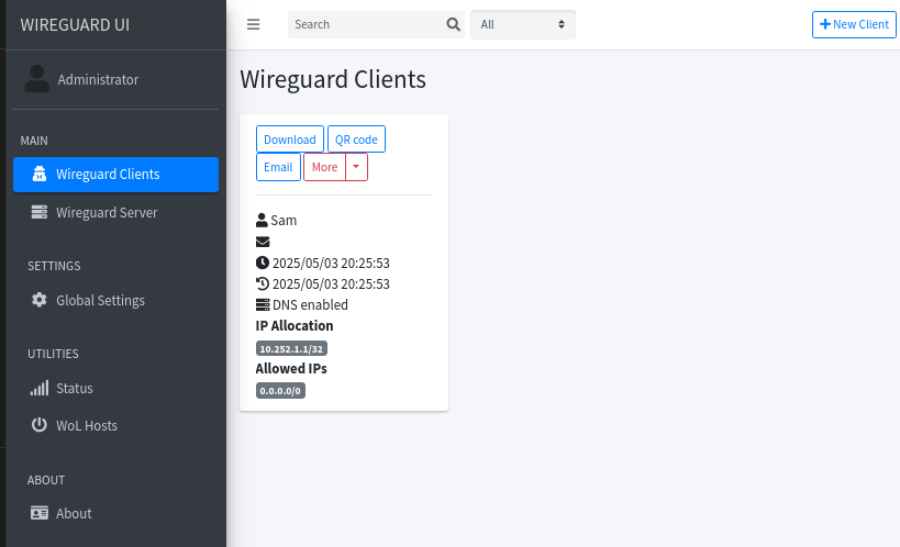

New Wireguard VPN web UI addon
I forked a repository for an old wireguard UI addon and updated it to use a different wg UI client.
I thought I would share it since I struggled to find a nice UI and instead ended up creating a new integration.
Finally got multi-user mode working. I had to deep dive into nginx. Home assistant ingress only allows a single Set-Cookie header. WireGuard UI sends two Set-Cookie headers.
I configured nginx to combine the cookies when sending backend to frontend. nginx also handles splitting the combined cookie into multiple cookies sending frontend to backend.
