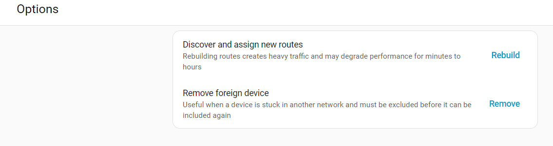

I added a Zen 15 last week, new product for me that had the same behavior, it added a node with no entities. But then I read the instructions, I had done it incorrectly. This was a smart plug. I had plugged it in and then scanned the QR code, but the instructions said to scan the QR code and only after it was added, plug it in. So it was my fault and it sounds like the same issue. The hard part was to make sure I’d removed the mistaken node before doing it properly. I also had to go into the integration, three dot menu and remove foreign devices or something like that. I had never even looked at that menu before but it was referenced in a Zooz documents that talked about removing failed nodes

I also went to the integration menu for Zwave, clicked on the gear icon, clicked on provisioned devices or something like that and then deleted the bad one.
You will need to know which one to delete under the provision devices menu, I believe it’s the one with the same 16 digit code as is on the QR code sticker.

  • Inside the Zwave panel, go to Options->Remove foreign device. Click “remove”, then “Start Exclusion”. This will put your zwave adapter into exclusion mode. On your ZSE11, press the button 3 times quickly to put it into exclusion mode. You should see that it excluded 1 device, regardless if the adapter had the device details in its database. This will do two things, remove any old inclusion information about the device AND put the device itself into a reset state where it can be added via SmartStart.
