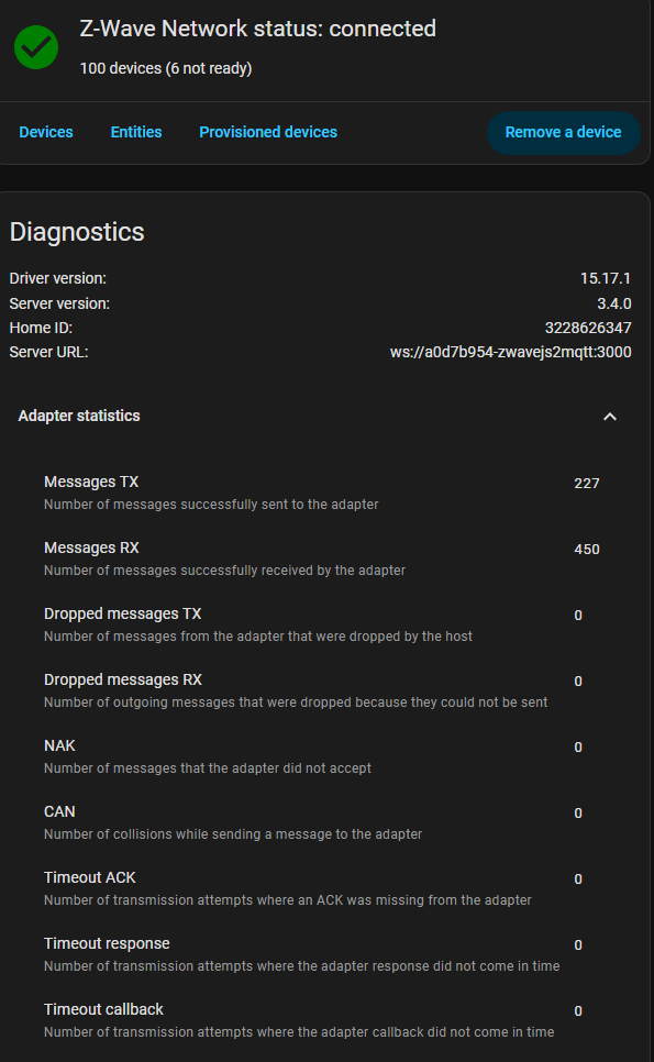

Here are my Z-wave integration settings:

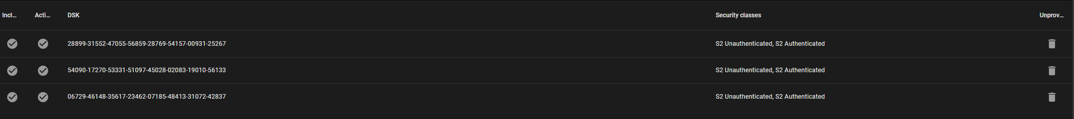

The only new thing I can see is that there are (6 not ready) at the top. Here are those provisioned entries:

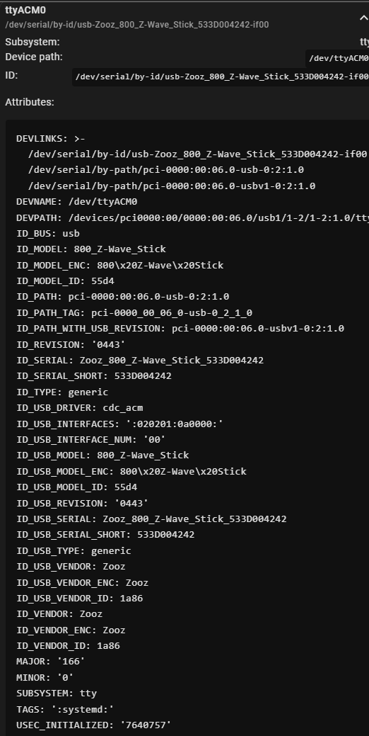

Multiple restarts etc. And properly attached and configured Z-wave USB stick:
Which is properly referenced in the Z-wave JS UI:

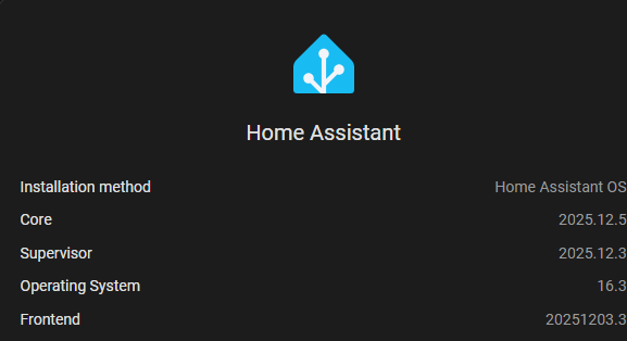

I am truly at a loss as my system has been solid for a very long time…wondering if a recent update had something to do with this. Any ideas very welcomed.
