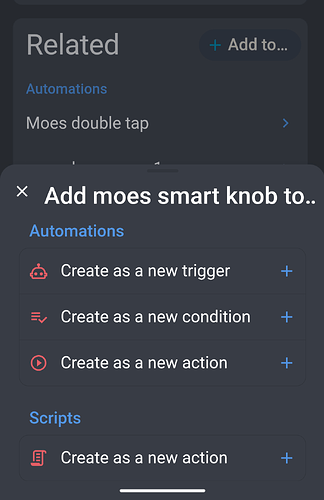

That depends on how you are using the word “should”… Should it? Yes, that would be nice… Does it currently? No
Please review this previous post:

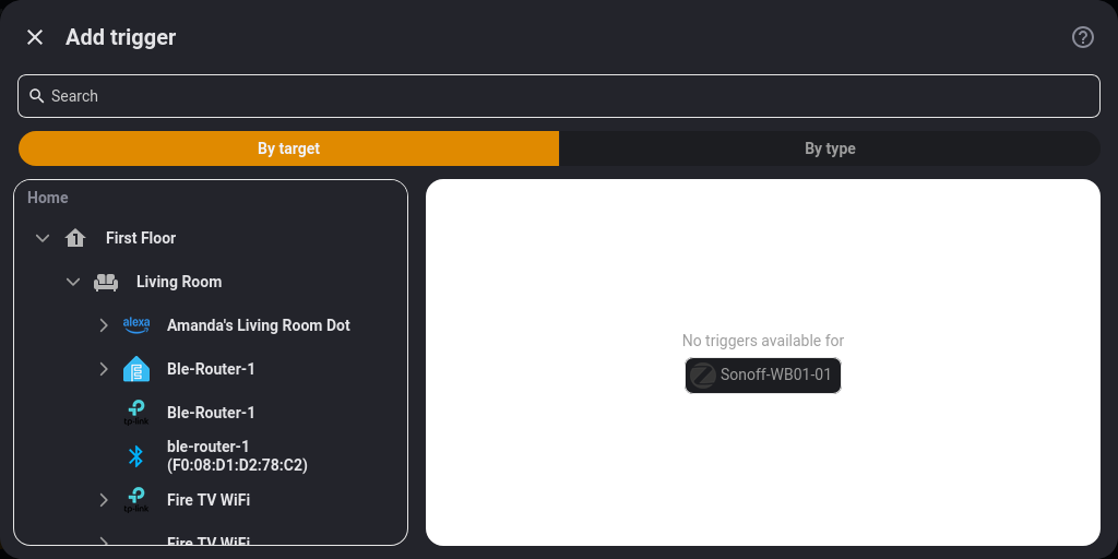

No, this has been a long-standing issue with these types of Zigbee devices. An issue that has been, inadvertently, made worse by recent changes to the trigger selector. The blueprints you mentioned can be a little clunky. But, they were a way to make it easier for users to trigger off these devices without having to take the deep dive into Event triggers when there weren’t any other options.

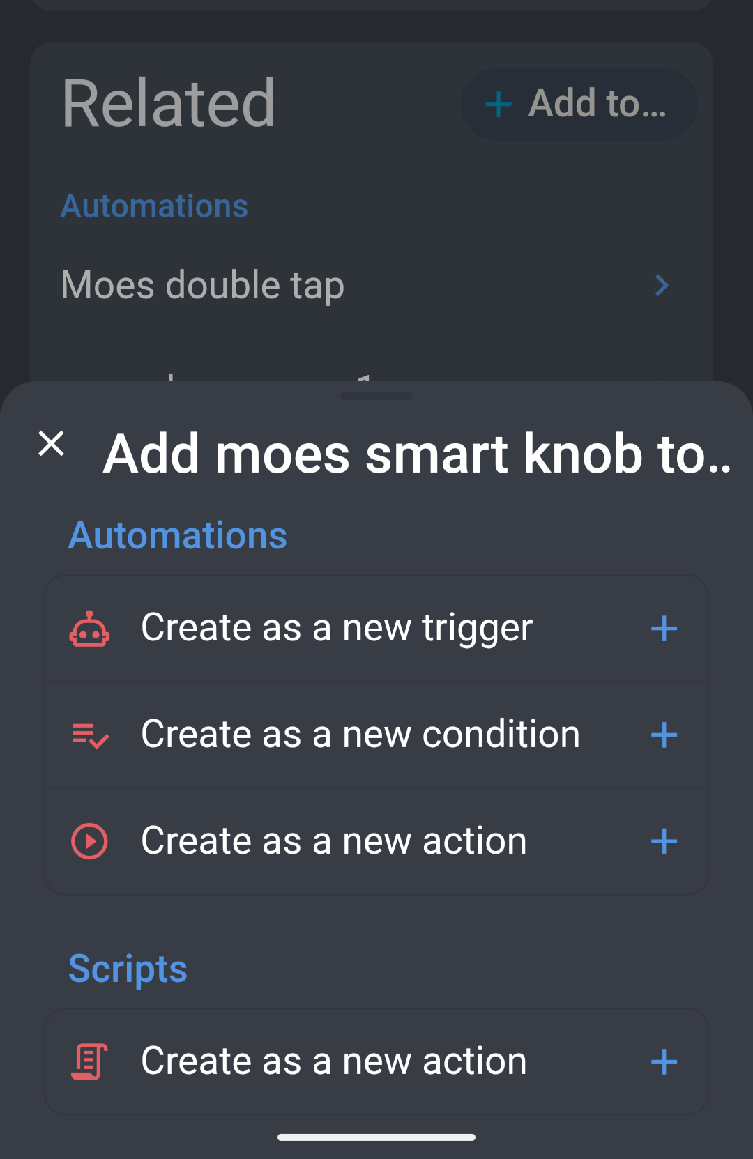

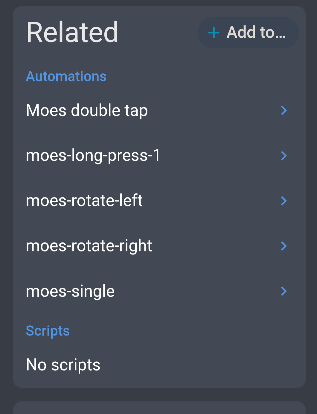

Go to the device under ZHA, scroll down to related, click “add to” and choose “create as new trigger” under automations.
That will just lead to the same dead end in the Trigger Selector…
I need to take a look at the changes to triggers you referenced in the post above mine then because that’s always how I used to do it but obviously some changes have been made.

For my own memory, the steps I took:
Under an Automation
  • + Add Trigger
  • Search for “Device”
  • Select Device under Triggers category
  • A dialog pops up
    • Select the “Yellow Button” in the Device dropdown (my name, you pick your own =)
    • In the Trigger dropdown select from a large array of event types – I picked remote_button_short_press
  • Finish & Save your automation
  • Go live your life and stop staring at a screen.
