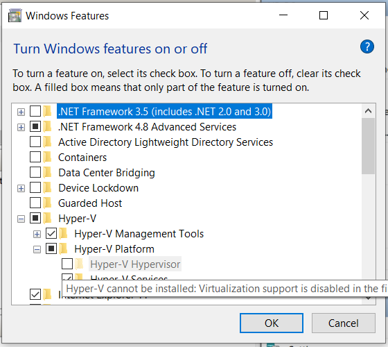

I enabled Virtual Machine platform and Hyper-V Manager but cannot enable Hyper-V Hypervisor. When I try and start the HA VM it says error starting as Hyper=V Hypevisor weasn’t running.
But I cannot enable it and the settings show as it being disbaled at firmware? Am out SOL?
You probably need to enable virtualization support, have a look in the BIOS. It’s a CPU related setting. According to Google it’s named SVM Mode, AMD-V or Virtualization Technology.

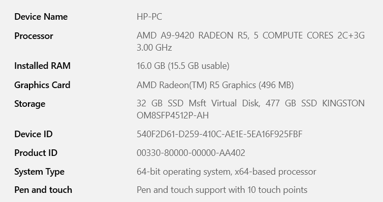

Which AMD A9 do you mean ?, are you aware of it’s Specs ?

That machine shouldn’t even be able TO RUN W11, let alone enable hyper V. (the A9 series isn’t on the list) There were reports of it running like molasses because proc support if you could even manage to get it to run at all. (seems you did) I’m not sure it’ll even enable a hypervisor in recent builds of W11. If you DO somehow get it running… USB pass through on desktop Hyperv is sketch at BEST. (for some reason this is a differentiation on server v pro sku)
(translated: You’re going to have LOTS of issues with that config. Sorry you may want to try something different, I’m an ex ms windows perf engineer… If me I’m not going to try to fight that box.)

Imagine, you have a windows(or any OS) With 2 CORE’s, and then you want to run a VM on this machine as well, obviously You can’t Dedicate 2 Cores or even threads to this VM, So that’s a main reason why Not to run Any kind of VM( which need a dedicated Core/thread to function in a stable way)
And to be honest, with that CPU ,you will most like experience the Lowest performance of any installs, as it’s not only a 2 CORE, it’s support only 1 channel memory, and the cache is kind of “tiny” .
