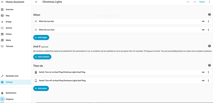

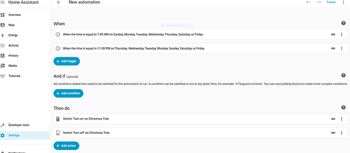

I am trying to automate a couple of KAUF smart plugs for some outdoor Christmas lights and my tree they are connected to my network and seen by HA. I can manually turn them on and off in the interface. I have created 2 automations one from sunrise to sunset and another 7:00am to 11:00pm
screen print
It looks like they are triggering (one 5 hours ago and one 15 hours ago) but the switches didn’t respond
As a new user I can only upload one photo at a time. to I’ll add additional posts with screen shots
This is the detail for the outdoor lights sunup to sunset
this is for the tree 7:am-11:0pm everyday
It looks’ easy but its not working does anyone know what I’m doing wrong?

Based on what is in the screenshots you have posted, your actions currently turn the lights on and then immediately turn them off.
If that is not your goal, you have two options:
  1. Use separate automations for turning on and turning off the targeted entities.
  2. Use an If/Then or Choose action so that a specific trigger causes a specific action. One way to do this is to use Trigger IDs.
