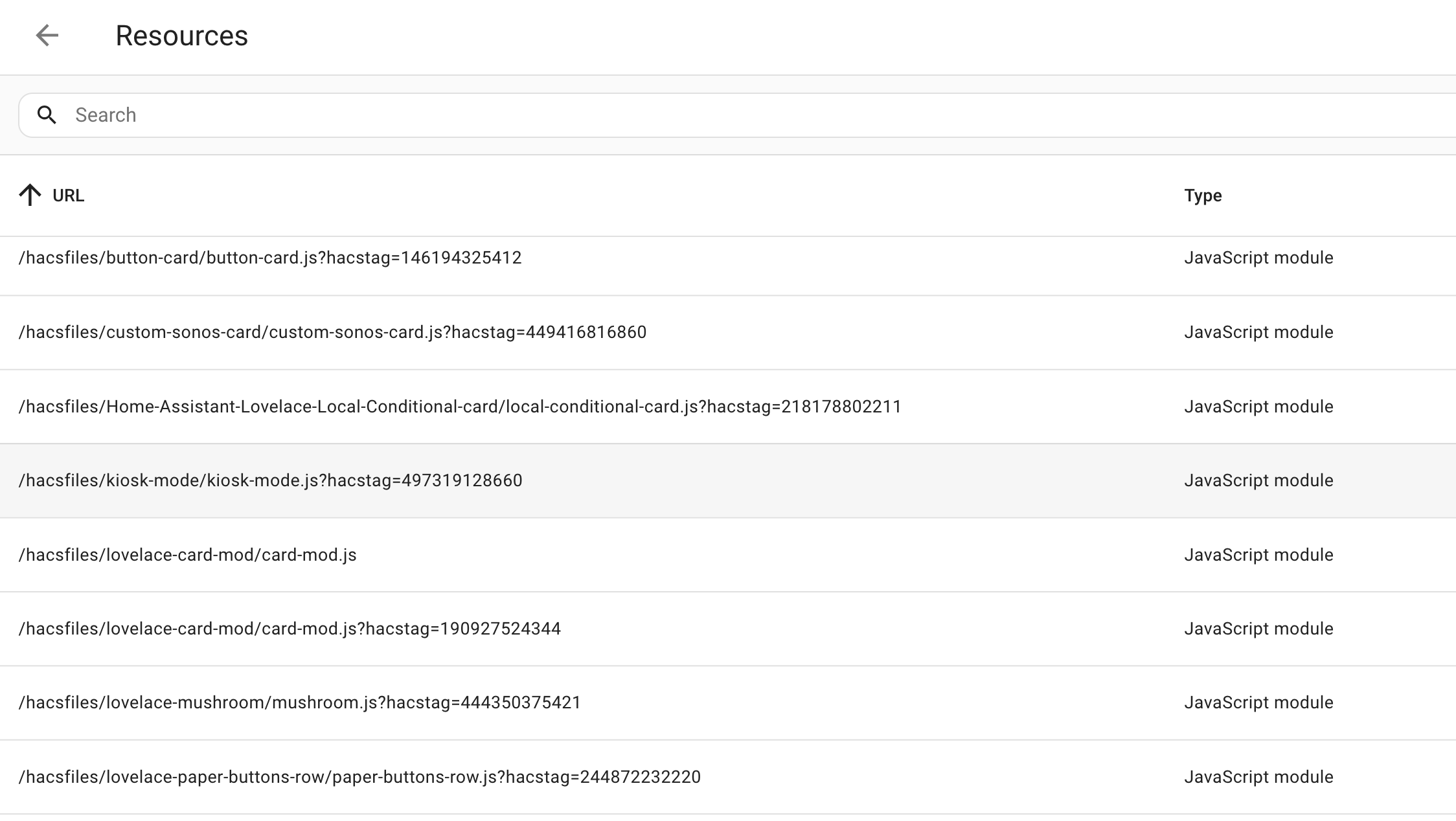

If I’m not mistaken hacsfile points to /homeassistant/www/community
I’ve also updated my resources
I’ve of course tried to reboot/reload but nothing help.
