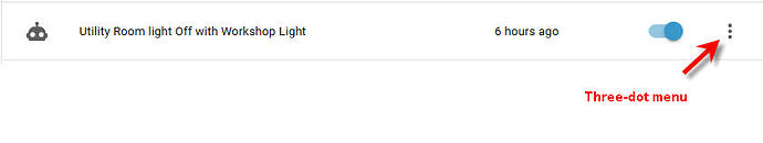

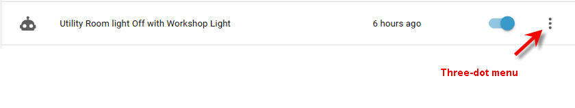

Open the automation, click on the three-dot menu then “Edit in YAML”. Then click on the “Copy to clipboard” icon.
