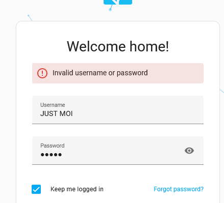

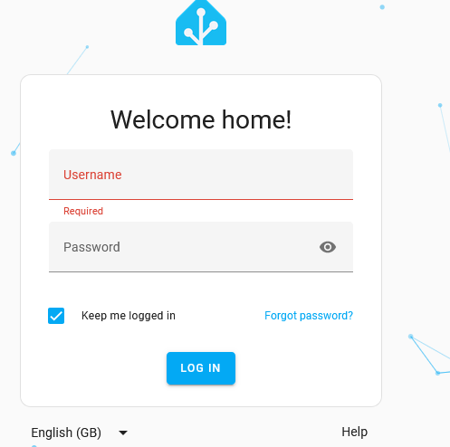

I just connected up a new to me HA yellow with an installed by me before power up an M2 drive
I went onto the HA site and the first page it starts with is the welcome home screen wanting a user name and password I cannot see how or where I can create these two items on this HA Yellow
HELP PLEASE

Just type your user name and password into those spaces and it will use those to create your account.
BUT I do NOT have a User Name or a Password set up YET!!
What @Arh means is that you can select your initial credentials yourself in this screen. Choose a name and password, enter it and you are good.
