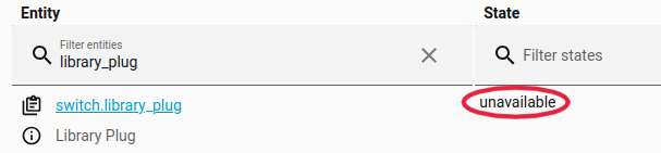

For example, I have a smart plug (switch.library_plug) that is not currently plugged in (so it is not connected to Wi-Fi). The entity exists in Home Assistant but its state value is unavailable.
That's possible, provided the entities don't "disappear" when they're not connected via Wi-Fi and their state is reported as unavailable. That's why I have been attempting to clarify these details.
