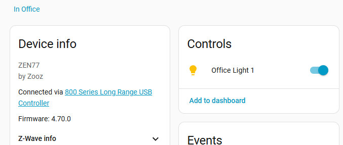

Settings | Devices & services | Z-Wave
Pick your light switch. Should have a switch under Controls.
ETA: This is one way. There are many really.

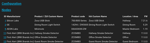

yes I don’t feel like there is a standard way for things and it is a bit confusing. I see the zwave js ui has node numbers, but under the device it does not have node numbers. In the name and location column in zwave js ui control panel devices list, it fails to have a name and location on some but others have a name and location. I added several about a week ago, so the interview should be over with. Not having the name or nodes associated with eachother causes a disconnect on how to find them when you want to do things like checking firmware or refresh or interview.
Node number is the “ID” field in the Z-Wave info panel.
Or you can use a Markdown Card in a Dashboard and create your own basic table UI.
HA doesn’t sync device names and locations to Z-Wave JS (driver stores them), but Z-Wave JS UI does. So if you want them in sync you have to always include with Z-Wave JS, pre-setting the name and location when doing so. Post editing requires the Z-Wave integration to be restarted to see any changes. Edits in HA always override was is set by ZUI. Last I tried this location was not syncing, so maybe an issue.
