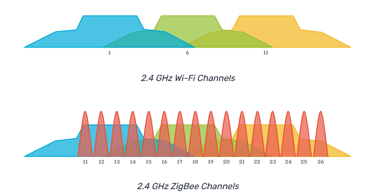

I edited my post before you replied:
tom_l:
But… before you do, have you changed your network key from the default and have you chosen an appropriate channel to minimise wifi interference?
You need to do this before pairing devices.
Find which wifi channel(s) you are using (should be 1, 6 or 11) then pick a zigbee channel that is as far away from that as possible:
e.g.
Wifi channel 1 → use Zigbee channel 25. Don’t use zigbee channel 26, this is unsupported by some devices.
Or
Wifi channel 11 → Zigbee channel 11.
OR
Wifi channel 6 → Zigbee channel 11 or 25.
Set this in your z2m configuration.yaml file.
As for the key, you can get z2m to generate a random one, see Secure your Zigbee network | Zigbee2MQTT
Restart z2m before adding devices. Add the routing capable devices first (mains powered usually) then add the battery powered devices last.
